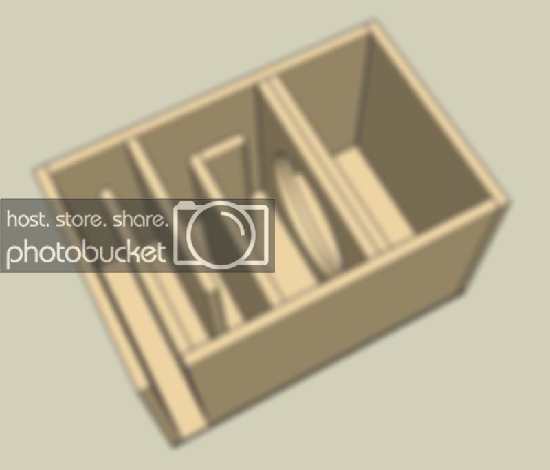

btlking 10+ year member Registered User 2,789 0 Uranus Mar 6, 2007 #1 can someone design me a 2-3 cube bandpass enclosure just need the desighn and dimensions max dimensions 37 inches wide 18 inches tall 18 inches depth its for a 12 Click to read more...

rpfuror 10+ year member sound envy 703 0 MD Mar 6, 2007 #6 what do you want to acheive.. a higher gain, a lower tuning, etc. my calcs say: you can get a 2 db gain within a passband of 32-84Hz does that sound good.... ie what are you trying to accomplish?

rpfuror 10+ year member sound envy 703 0 MD Mar 6, 2007 #7 I can tell you right now it will look something like this: because of the area/lenght you will need on the ported chamber.
rpfuror 10+ year member sound envy 703 0 MD Mar 6, 2007 #8 Here is a design @ 2 db pasband of 32 - 80hz custom for the driver you mentioned.

rpfuror 10+ year member sound envy 703 0 MD Mar 6, 2007 #10 if you say so "dude".. why don't you show use your skills... the math is dead on based on the ts parameters of the sub.

Pyro_By_Nature 5,000+ posts CarAudio.com Veteran 6,155 19 Colorado Mar 6, 2007 #11 Ok, the math is on, but do you have any clue about bandpass boxes?
rpfuror 10+ year member sound envy 703 0 MD Mar 6, 2007 #12 yeap, built many over the years, most turned out pretty well. One recently for a set of 10's that sounded great... search this forum for the build if your inclined to do so.
OP btlking 10+ year member Registered User 2,789 0 Uranus Mar 6, 2007 Thread Starter #13 i was thinking bandpass because right now i have a soft top on my car so i have no back pressure so the subs excursion is way to much so i thought bandpass would put a little pressure back twords the sub good or bad idea?
rpfuror 10+ year member sound envy 703 0 MD Mar 7, 2007 #15 this sub it not really designed well for a bandpass enviroment. As you can see with the vented chambers port lenght. I have done and own a lot of Jeep Wrangler and they seem to do well with a sealed box.
