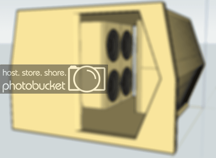

Bandpass design

No wall..don't wanna go through the hassle of sealing it off. just a huge box. How much you think I would gain by changing the design? Mainly I'm just after crazy lows and hair tricks lol. What do you think about the volume and tuning?

80
subs will be side by side..not top/bottom
5 cubes sealed, 7 cubes ported at 50hz. I want a really strong low end here..

thanks man. I just needed the final confirmation of the volume and the tuning before I go ahead and start buying wood. It needs to be right the first time because I don't have another $150 for wood. I still need to find a supplier for Trupan Ultralight. Idk how much lighter it is than mdf so if anyone knows...lemme know!
looks good ...and havin the subs load off the same wall is good
so ur on the money with the idea...if u want more lows make the seal part bigger..but by doing that u make the front chamber small thus making the box less efficient than wat it is now
80
looks good ...and havin the subs load off the same wall is goodso ur on the money with the idea...if u want more lows make the seal part bigger..but by doing that u make the front chamber small thus making the box less efficient than wat it is now
80
if he's already got 2 per sub in the sealed chamber, he could always just tune it lower and by keeping the sealed chamber smaller is gonna keep the woofers in control
