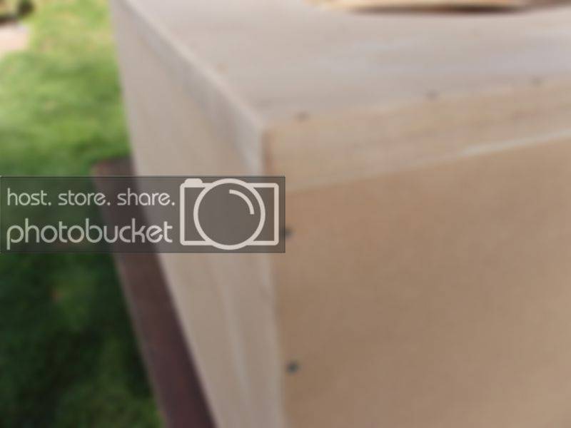

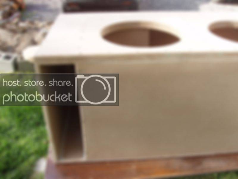

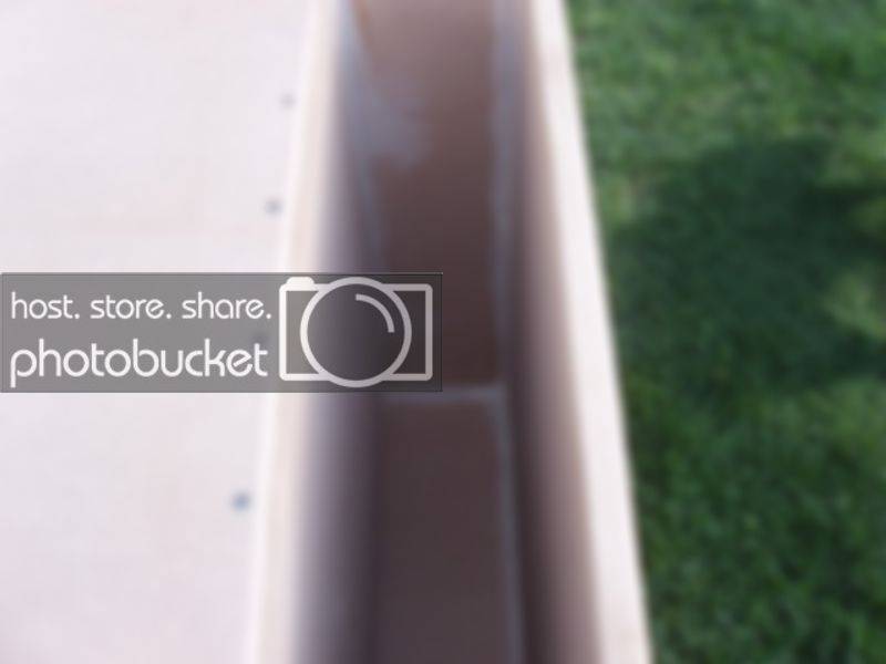

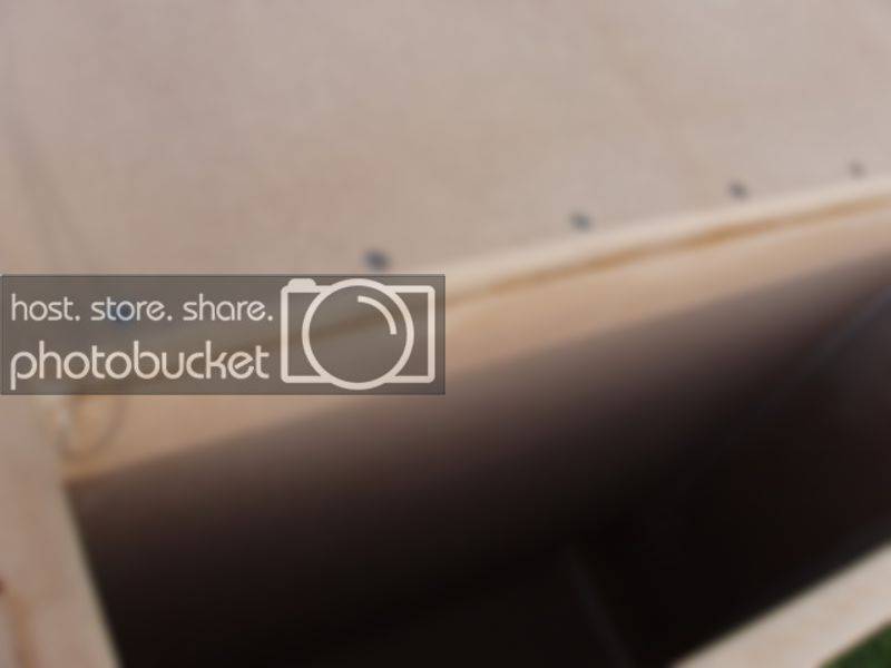

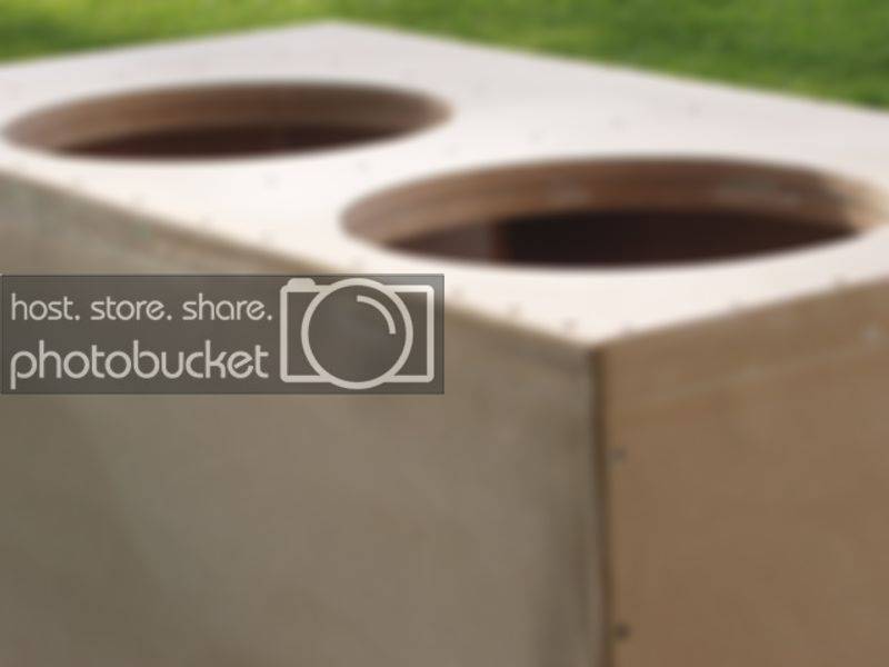

I like every 4-5 inches and predrill the face plates first. Kinda overkill as the wood glue actually bonds it all together. I dont even predrill as I let the fine thread drywall screws draw into the wood slightly below the surface. I like 2.5" screws for the form and 3" for the double baffle.
