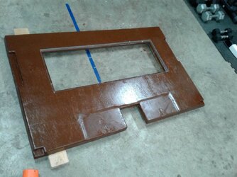

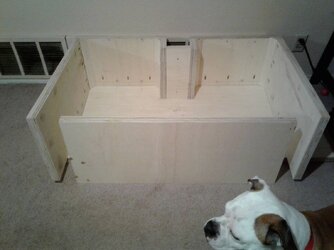

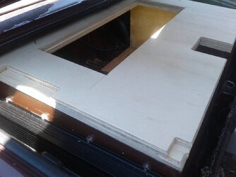

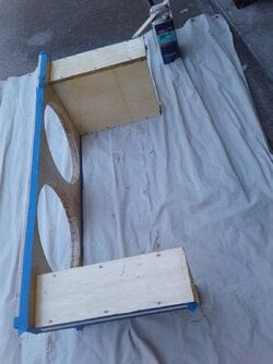

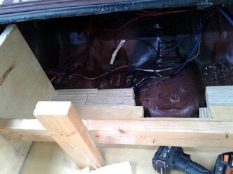

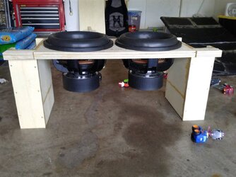

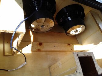

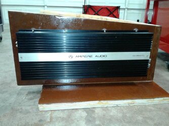

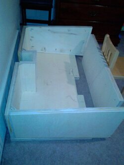

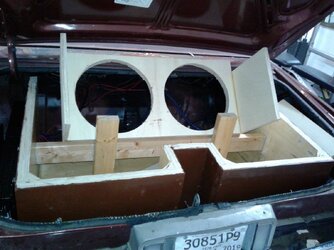

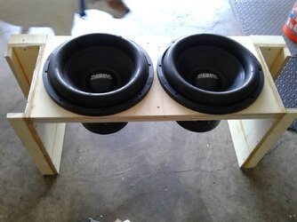

So back in December I took on a build to build a box for a '75 Cadillac. It's been a few months and I'm finally nearing completion as my job and clients job intervened. So here we go. There is about 4.4 cubes per sub after port and displacement, bracing and fiberglass resin coat. It is 1.5 inches thick. There will be a 3/4 inch plexiglass viewing window where the hole is.

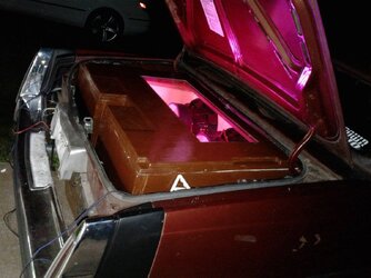

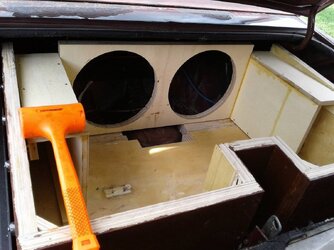

Some more updates, 85% done. Plexiglass and leds realy make this box, very proud of this one, although my fiberglass resin coating on inside of box could use some perfecting.
You do realize that using resin inside of the box isn't  necessary right?
yes, really not going to provide any extra strength to this box but it sure looks nice, but when I first started it 5 months ago I thought it would. Lol.  next time just do a rattle cab clear coat or something to make it shine and be smooth.
