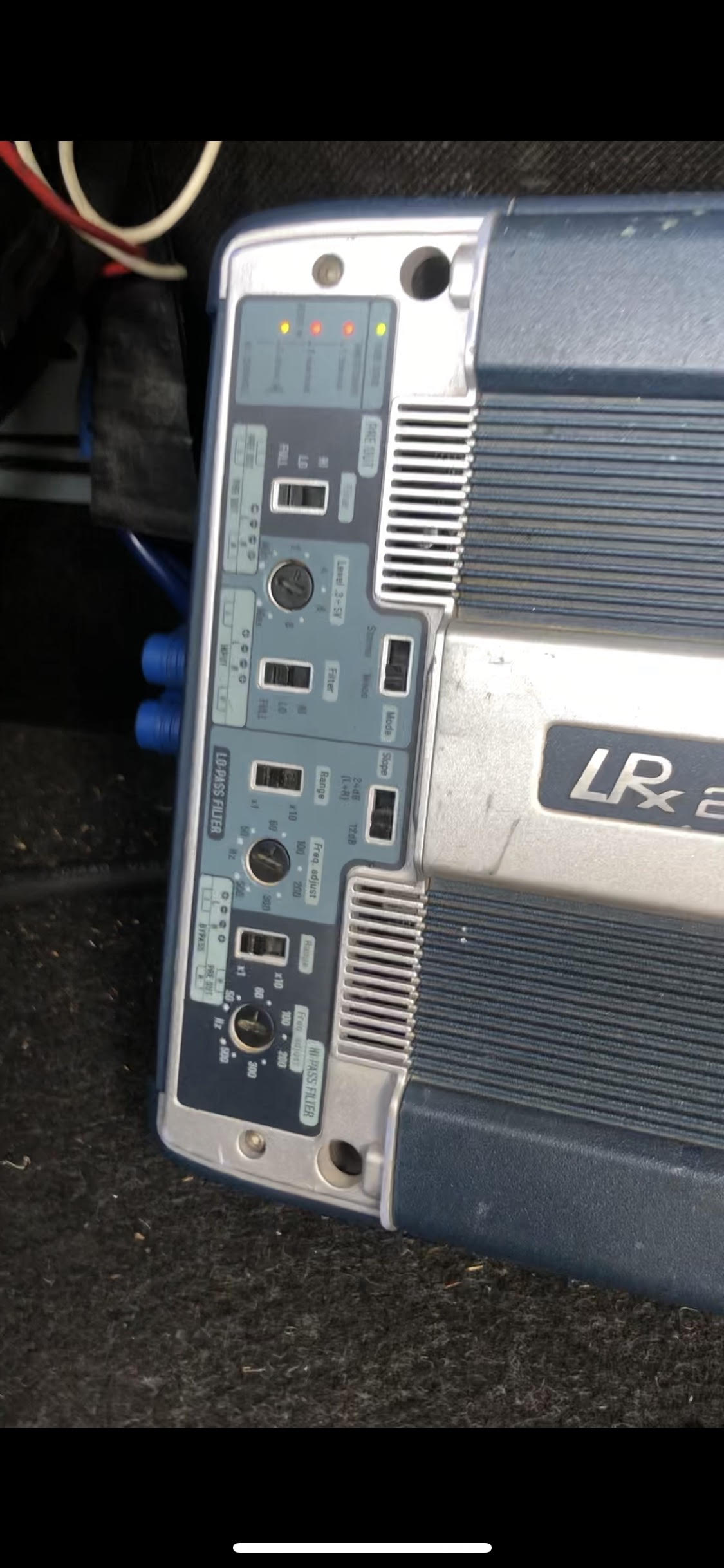

I just bought this Audison lrx 2.9 amplifier. The amp is wired correctly. Trying to run JBL 1220D (2ohms per coil) . Connected the positive to speaker left positive and negative to speaker right negative. Ground is connected to NEGATIVE and Battery to POSITIVE. Switched between mono and stereo modes both. The woofer is mute and amplifier is showing a red protection light. The fuse is showing a green light. And speaker check is showing an orange light.
PLEASE HELP !

Even when the subwoofer is disconnected and only ground , remote and battery is connected, the amplifier is still in protect mode
