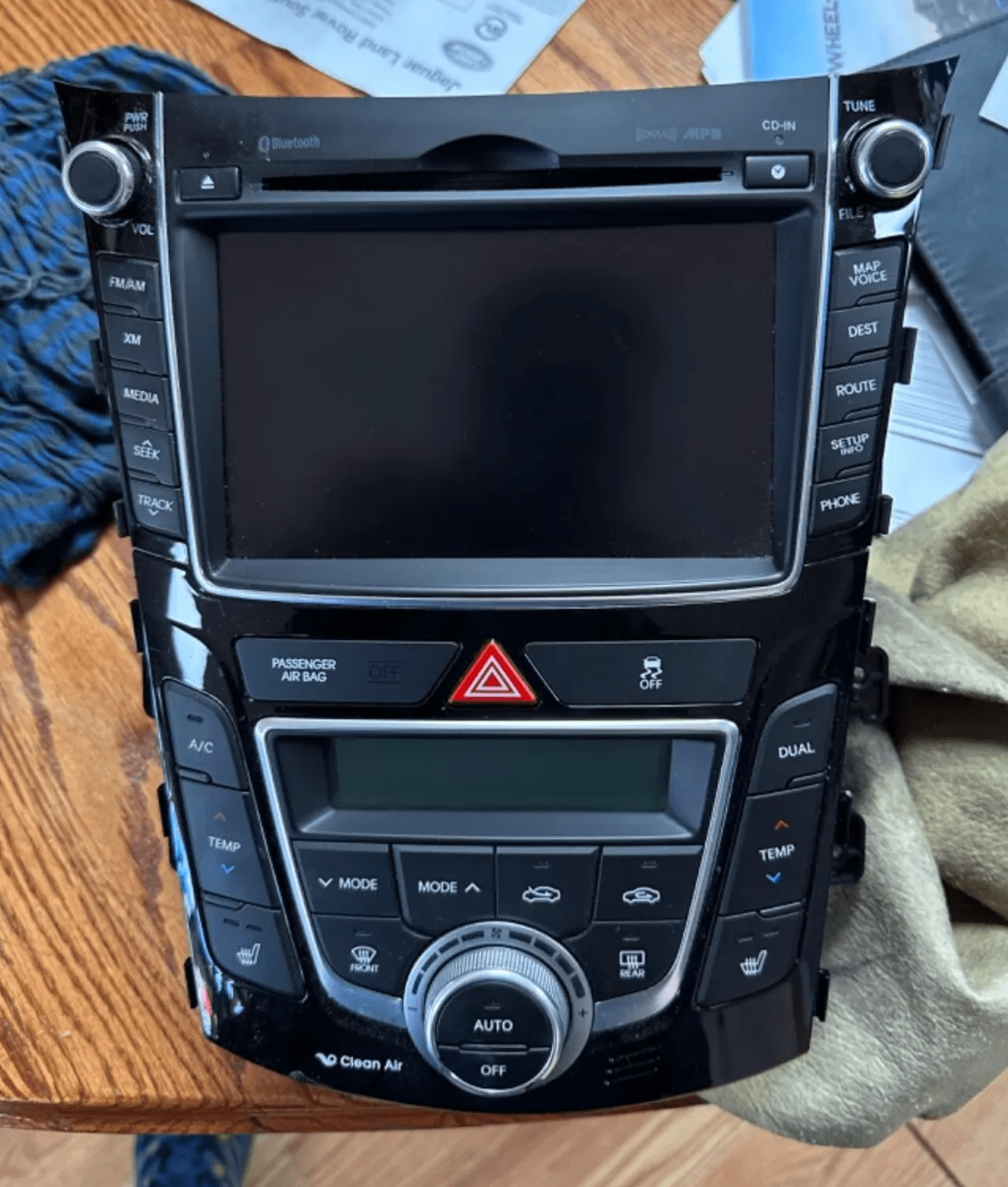

Is this the radio?
Finding a bezel should not be difficult but it being as snug as the OEM may be.
Take a picture of your radio in the dash as it is now. I have a 2013 sonata. If your radio looks the same as mine, I'll show you what an aftermarket hu looks like in the same spot.
