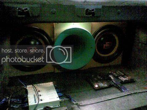

Two door Olds Alero with two DD9512's. This is still a music box and not for spl only. We're just trying to make a crazy loud daily box for two 12's.
Previous box 149db @ 42hz 2800w clamped
New box similar style but smaller 149.8db @ 46hz 2000w clamped. Not bad with less power and port not fully tuned. //content.invisioncic.com/y282845/emoticons/smile.gif.1ebc41e1811405b213edfc4622c41e27.gif Going to tune port and hope for a little over 150 and then toss 4000w to it. Hope for a 151.5+

Couldnt stand the box flex noise when I turned it up.
Resin away with a hair dryer to help cure in 40degree weather. LOL
A brace from top to bottom would help a ton to stop flexing of the box. Basically center from front to back and center in the main loading chamber area. It's so open and with only 3/4" mdf it'll even flex with the resin We use just 2x2" pieces of wood with two screws top and bottom.
Looks good though.
What I didnt get a pic of was the 18in of port wall that shrinks the common chamber. It supports well but def need to add some more strength. Will prob add threaded rod for supports once I get the darn thing tuned.
