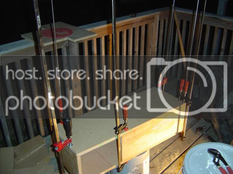

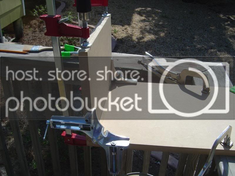

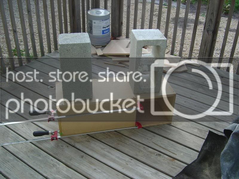

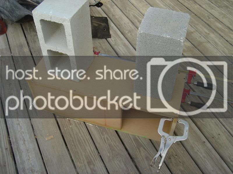

Sorry for the late post but camera was hijacked for two weeks...Some of these pics include a camaro build, which belongs to my roommate
Update Time:
