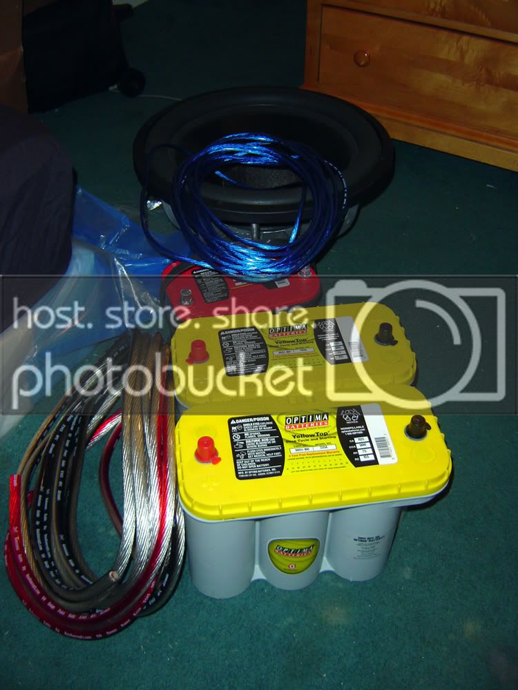

I ordered more batteires, 2 more d31a's, and a redtop, so 4 batteries, may need more.
Anyways this is what I am going to be doing in preperation of the stronger system:
Electrical upgrade, all wiring purchased/batteries puchased-

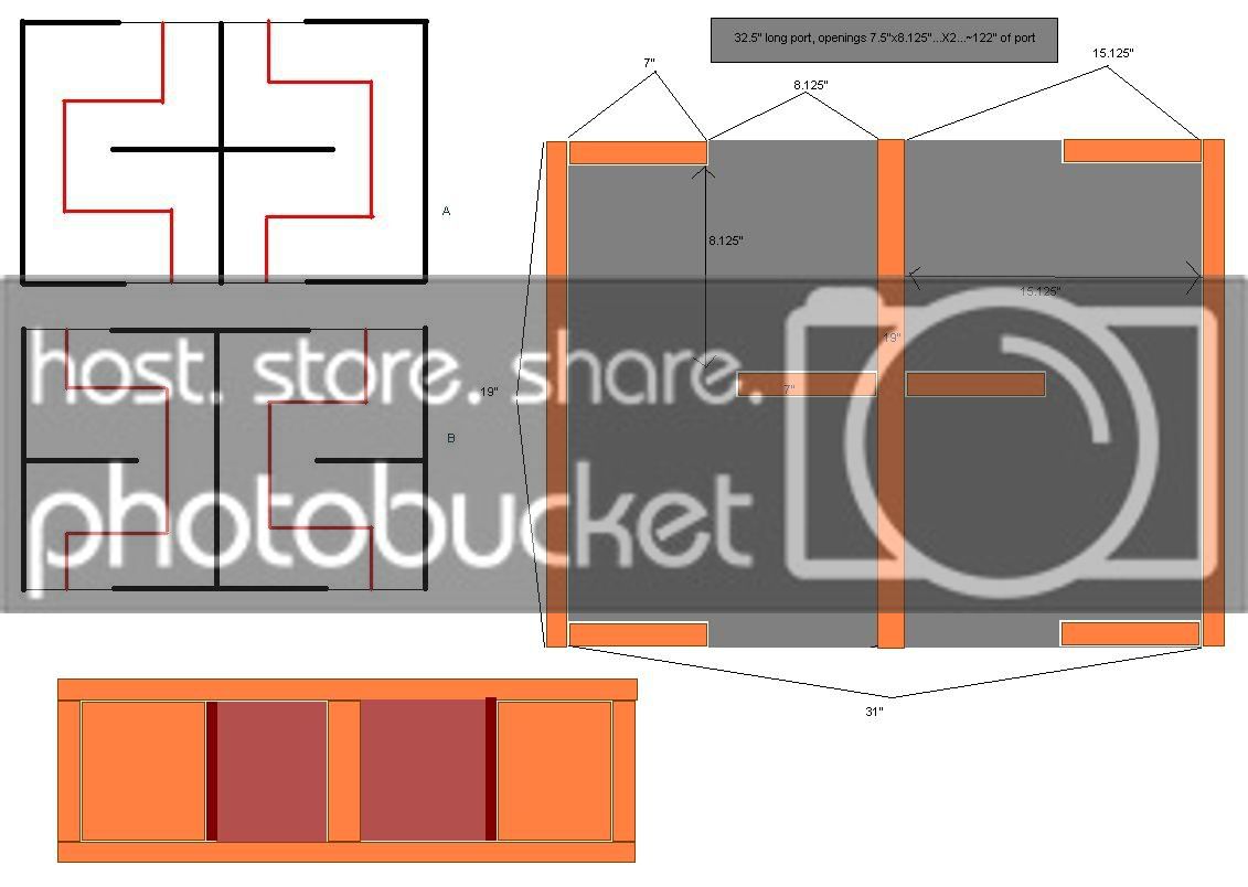

Beef up the baffle with more glass and two by fours-
Redoing the port, will not be sealed as described before-

I've just designed the port, I used up all the room I had for it, no way to get any larger than this: I have two mock ups, either one will work. The box will be tuned around 35hz-

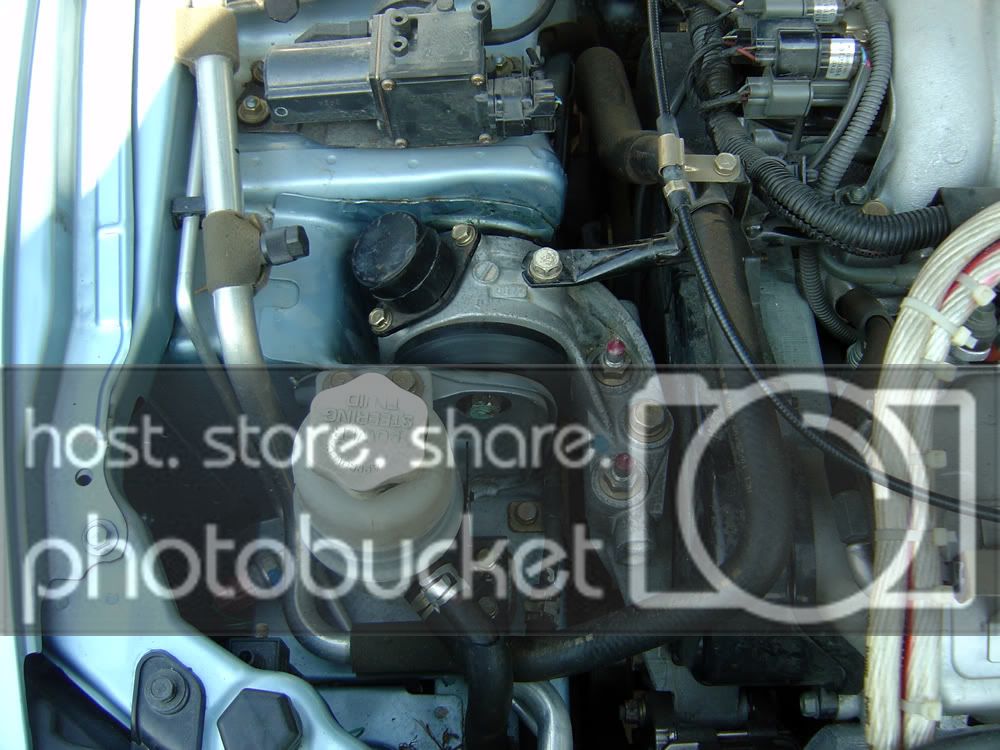

I had to replace a worn out motor mount, so instead of going stock, I replaced it with a urethane motor mount...

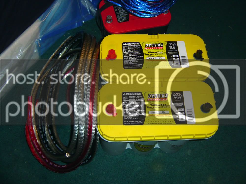

Here I have the old battery removed, will be replaced with a redtop. I started to solder some crimp terminals on the wires, and sanded them in prep befoer the battery goes in.
Wait so you did all that work, got the sub in, and damaged it during testing? And instead of just buying a new sub and setting the SSF you're going to completely redesign everything?
No, not really, I redesigned the port for the new sub. The old one was kinda small and tuned wayyy low. I am gutting it and building a new port in place, to fit in the same area. This time its tuned higher and is larger. The only other change to the box is I have to open the cutout for the sub some more. That and I am beefing up the baffle/box. With the new sub, I need more power, so I sold my old amp.
