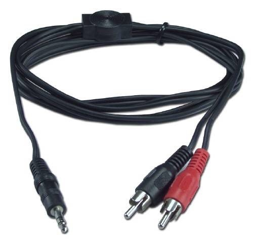

Heres a quick troubleshoot method I use..
Get a RCA to 3.5mm adapter at radioshack/walmart
Plug ipod directly into your amp.. your ipod (or whatever) is now your headunit.
Hmm so that just tests if it's the head unit or amp? Nice trouble shooting. I think my head unit ground might be coming loose when the bass hits really hard. Or it's my amp ground. Might relocate that and see what happens.

Yes.. plug a phone/ipod directly into your amp. Crank up a song and if it works, then you know its a problem with your headunit / signal.
If it still does it, you know your headunit is fine.
I'll see what I can do. I will find a better spot and sand to bare metal then fasten the ground to it like I did my big three chassis ground. Might hit up walmart for that RCA to 3.5 jack cord when I get off work.
