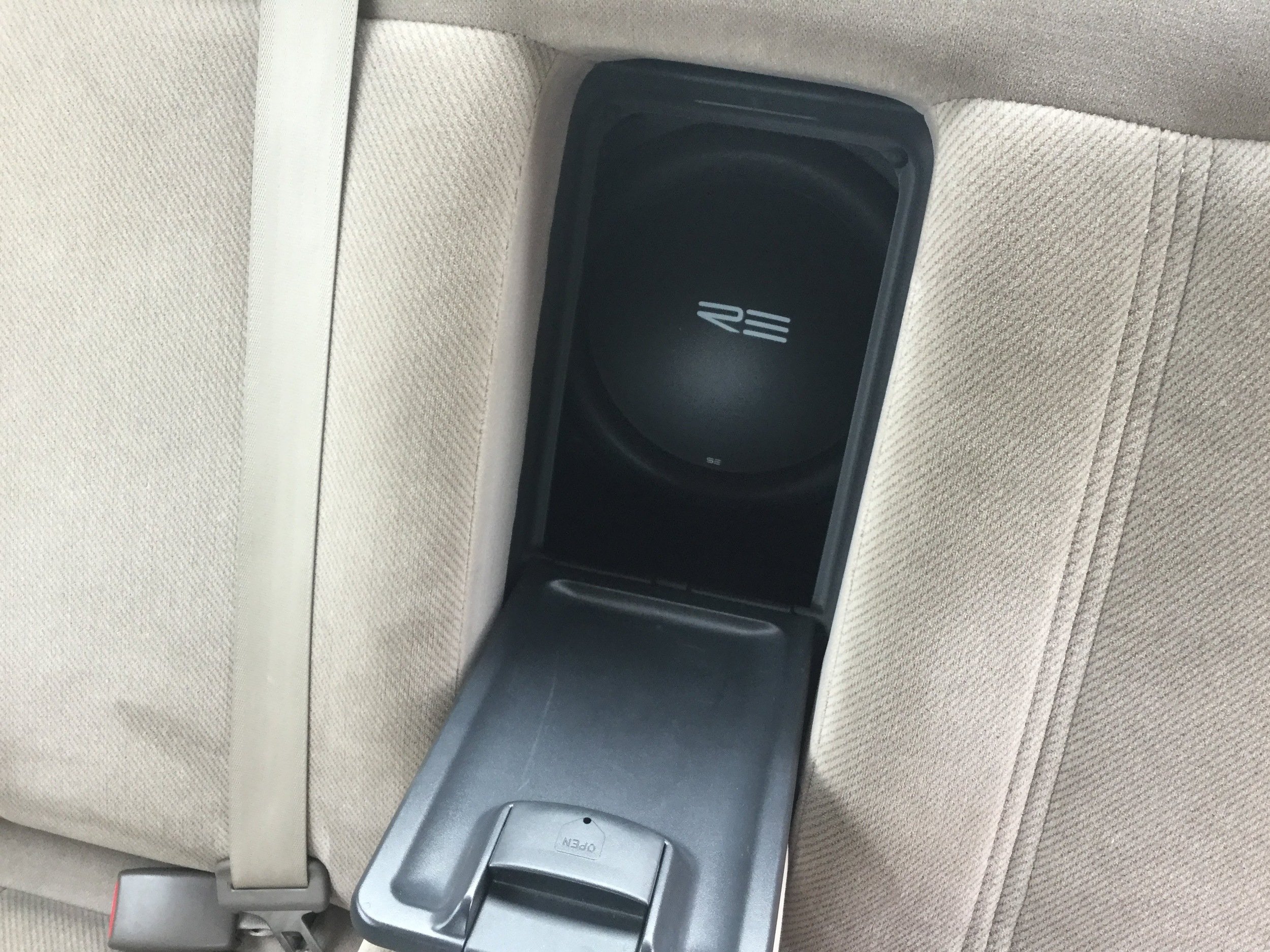

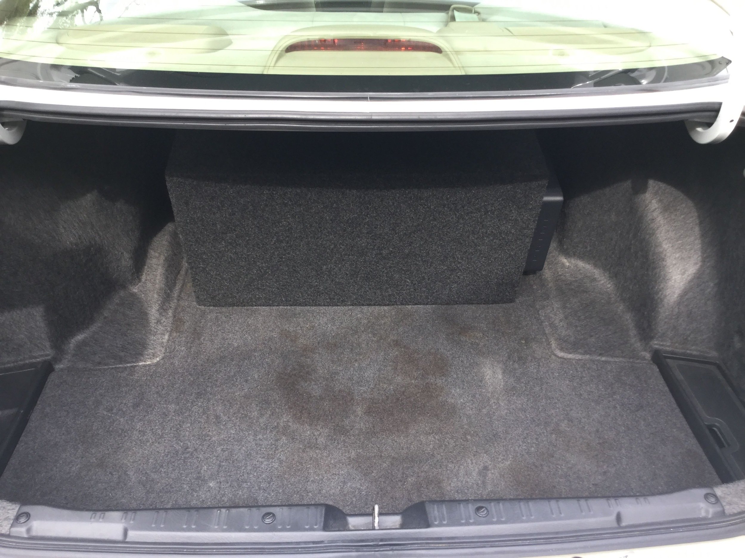

my setup. paid around $1,200 for everything...
It looks good but your sub would hit twice as hard rear firing if its sealed ...if its ported it still should hit harder ..since your amp is mounted to the box maybe do something with a view of the amp through the ski port ..your sound will still vent through and partially help cool amp in the process ...a little led light strip mounted above amp would high light it while ski port is open....and give it a nice subtle touch at night
