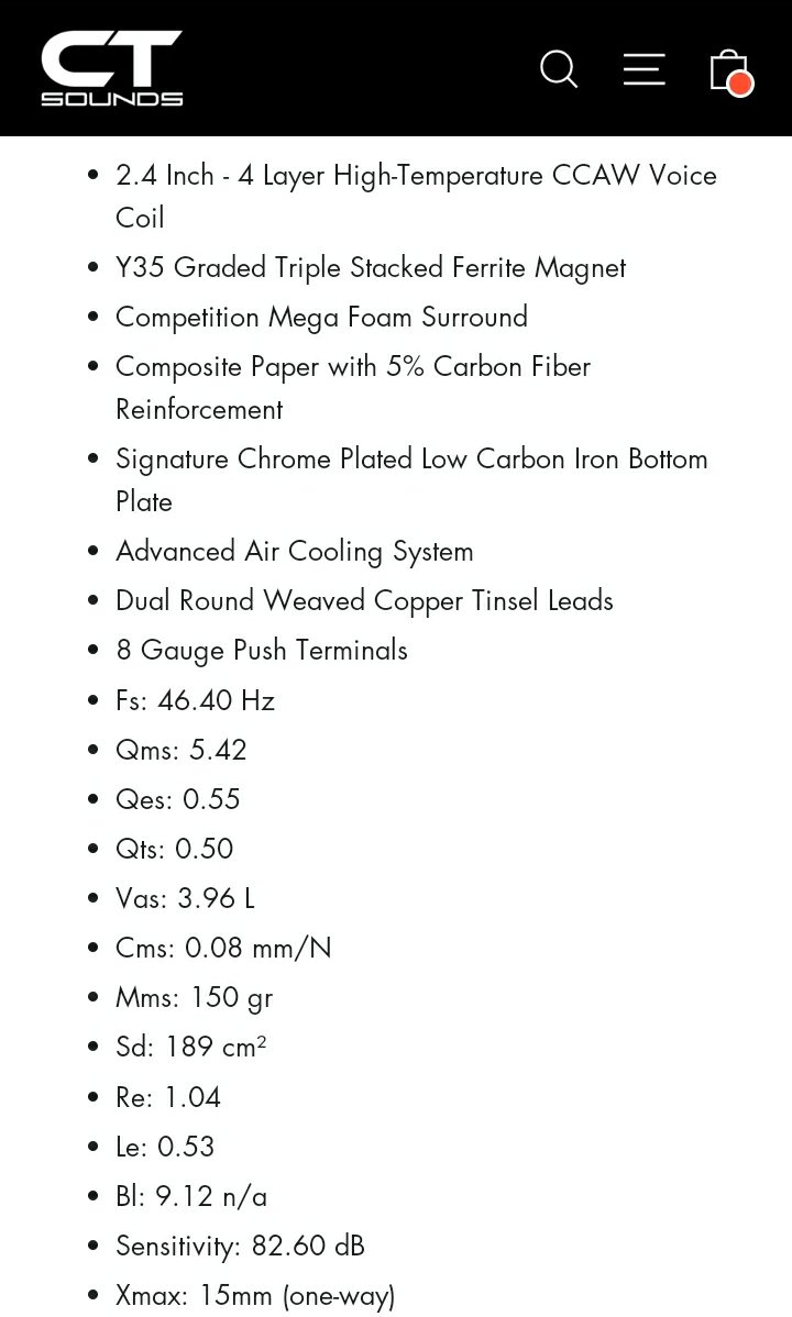

The CT Meso has an Fs of 46. Are you talking about the AB HD8 or the VFL 8? Here are the specs for the CT Meso 8.
That's a decently large Vas for an 8, that's the first thing that stood out to me. I wish they gave actual full t/s. Those specs look pretty good, though, to me. I would like to see what the Qms, Cms, and Rms is with a Vas like that, a ~35 hz Fs, and a 2.5" VC. Do they give a ported box recommendation for these?
Decently large? I actually wonder if thats a typo it's so high.

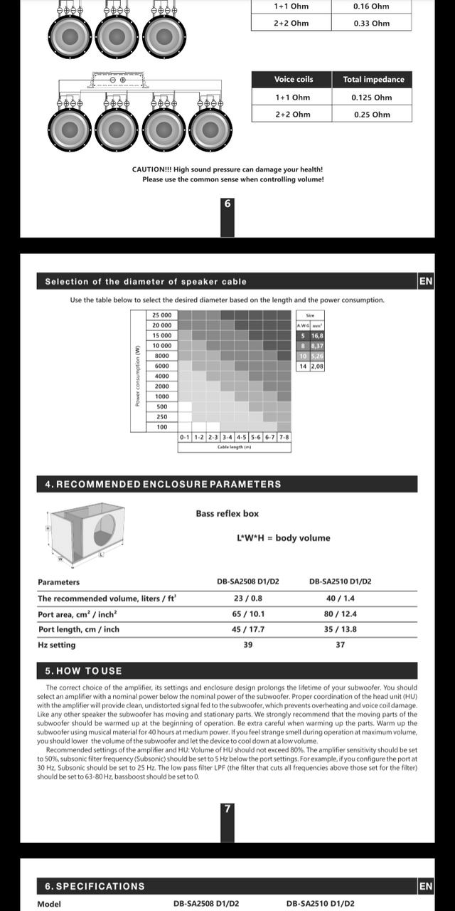

Anybody else think it's weird that the Deaf Bonce 8 has a vas of 19 and an fs of 35 hz but their box recommendation is 0.8 cubes at 39 hz?
I couldn't find their box recommendation. Are you looking at the new 8 that they just released? The DB-SA2508. What does VAS mean? I'm dumb that way, but at least I know it.
