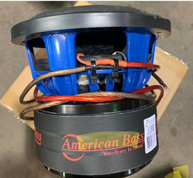

I'm thinking of changing the 8's in my truck and have it down to these two. The American Bass HD8 (400 rms?) and the CT Sounds Meso 8 (800 rms). I currently have the newer VFL8 (600 rms). I really like the looks of the CT and the 165 oz. motor but I don't know anybody who has experience with them. The AB has a 150 oz. motor. The amp is a Sundown SIA3500 to power 4 subs. Any thoughts?

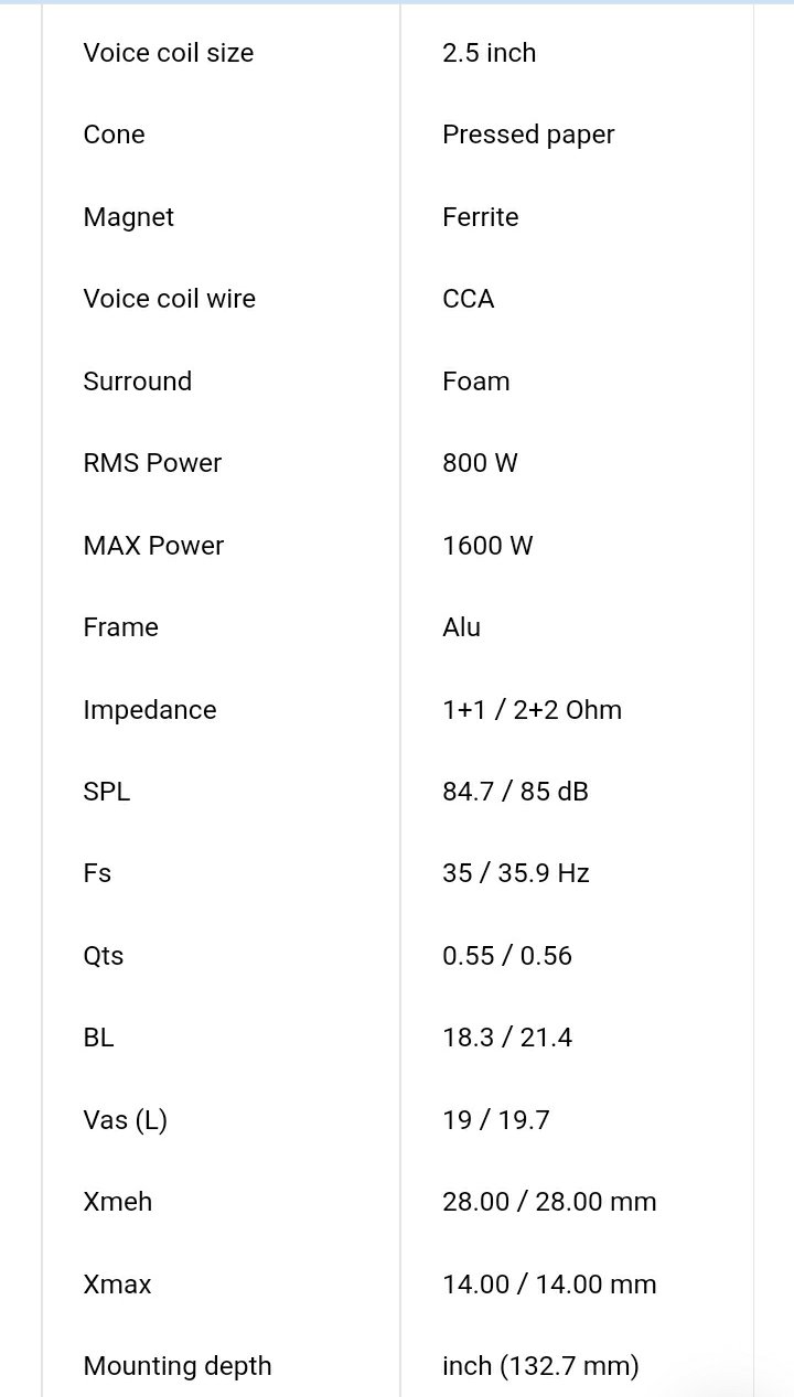

That's a decently large Vas for an 8, that's the first thing that stood out to me. I wish they gave actual full t/s. Those specs look pretty good, though, to me. I would like to see what the Qms, Cms, and Rms is with a Vas like that, a ~35 hz Fs, and a 2.5" VC. Do they give a ported box recommendation for these?
