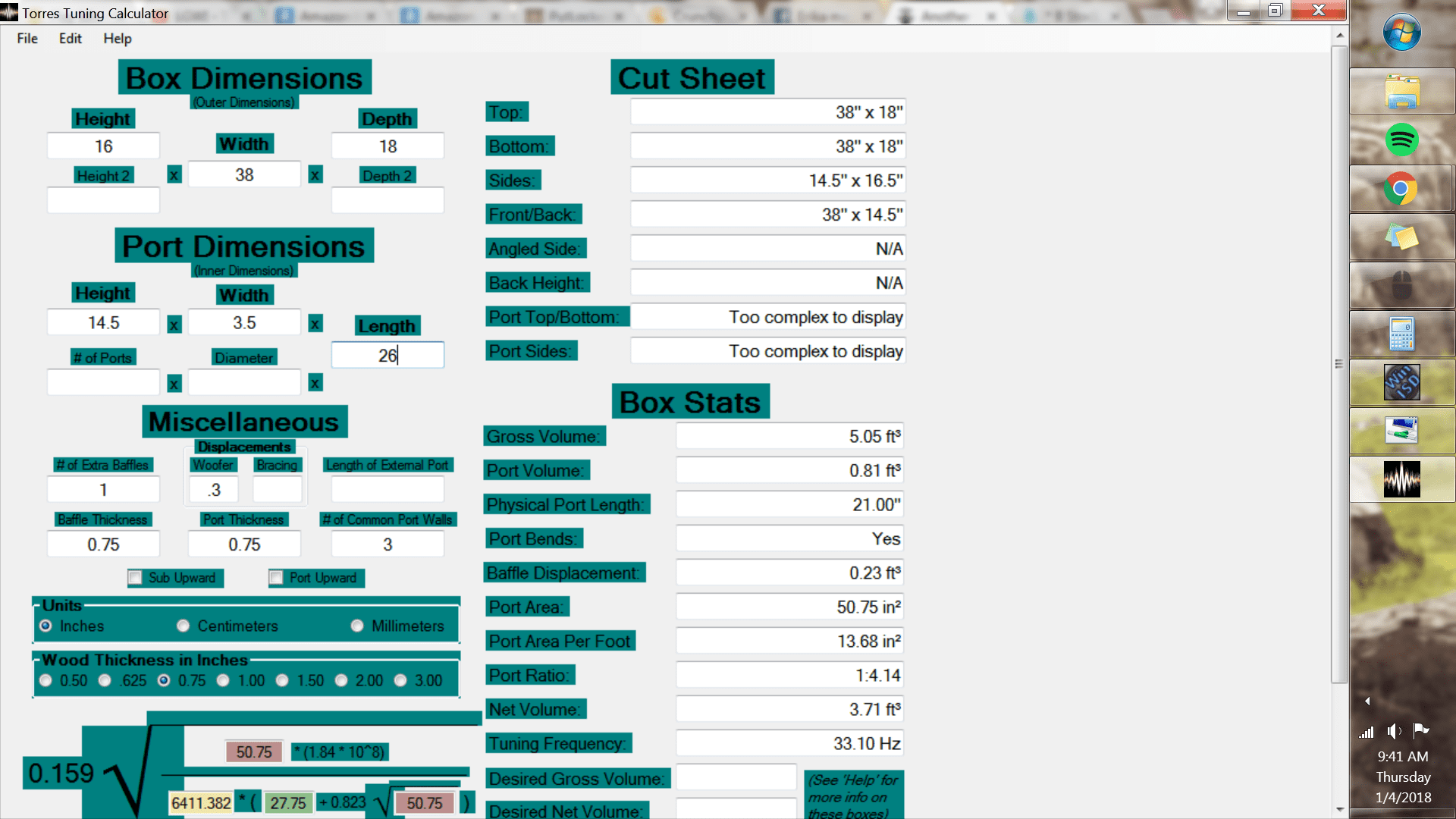

Sorry to say you dont have enough airspace to do two 12s. thats not 6.333 cubes gross, you forgot to subtract the space the wood takes up. its 5.05 gross before port displacements. Honestly i'd do a single 15 with the space you have.
here's a sample box.
