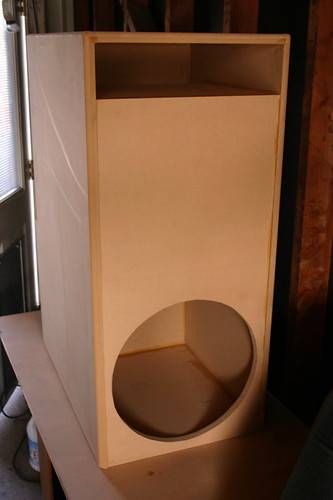

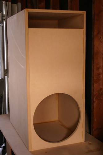

Another BTL build 4.2 cu ft @ 33hz - 62 sq in port
looks good man. lot better than the other lol. should wang.

Yeh. I am getting better. My box building Jedi training is nearly complete. I picked up 2 new clamps and then 2 90 degree clamps - one large, one small. They help a lot.

Mini-update. Got the edges rounded and all the support pieces added. Still waiting on the delivery of the sub. FI hasn't given me any indication when it will come.... //content.invisioncic.com/y282845/emoticons/uhoh.gif.c07307dd22ee7e63e22fc8e9c614d1fd.gif
It's not going to make night and day difference. But if positioned on the opposite end that is now... it'll give the air no choice other than exitting out the port. How it is now... it's a little different.

I totally agree with Noah here. I had this same experience for one of my customers, and wow the windshield wipers moving, but you cannot feel the bass at all. It doesn't get to loud too because of how all the air is just going straight out of the port exit. So then i offered to redo and edit the enclosure. Placed a piece on top of the baffle, made a new hole, tested it. And wow such a big difference. This time the windshield wipers are moving with the feel of clean bass. So yes, it makes that much of a difference.
