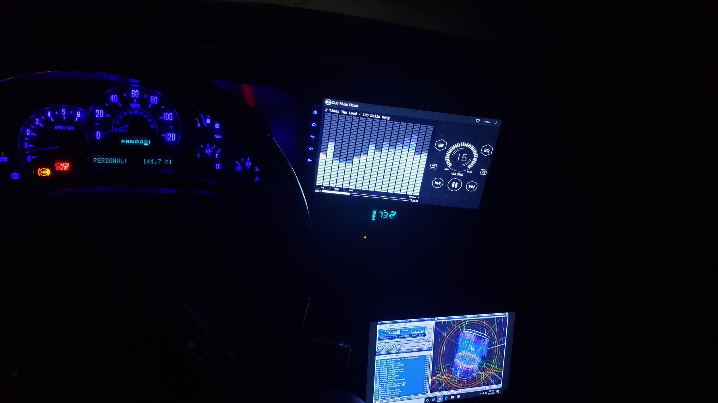

I bought an android hu. I have one with 4gb RAM and 64gb storage.
It has 1 pair full signal, and 1 pair sub out puts. I think only 1.6v.
So I have the full signal going into a x-over/eq/line driver.
However, my front pillars are directly connected to it, and it whines, BADLY.
The rest of the system that's on amps are perfectly clean.
I'm QUITE pleased with its function, I think it's worth having.
I have a 10.1" version, top screen, and a 10.1" screen dedicated to my computer.
