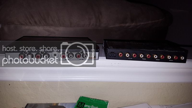

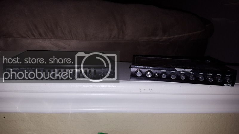

I totally forgot about this one, but if you really wanted to go BALL$ OUT, you could take your single preamp outs, and feed them into an active equalizer or crossover unit, (in-dash or hideaway) which would multiply all the RCA connections for front, rear, and sub. then you would have infinite levels of adjustment. Fader control would no longer belong to the Headunit. Some units, like my Clarion on the right, even have line driver capability, so the preamp voltage is higher, although I'm not sure the 7 volts it provides is completely necessary.
