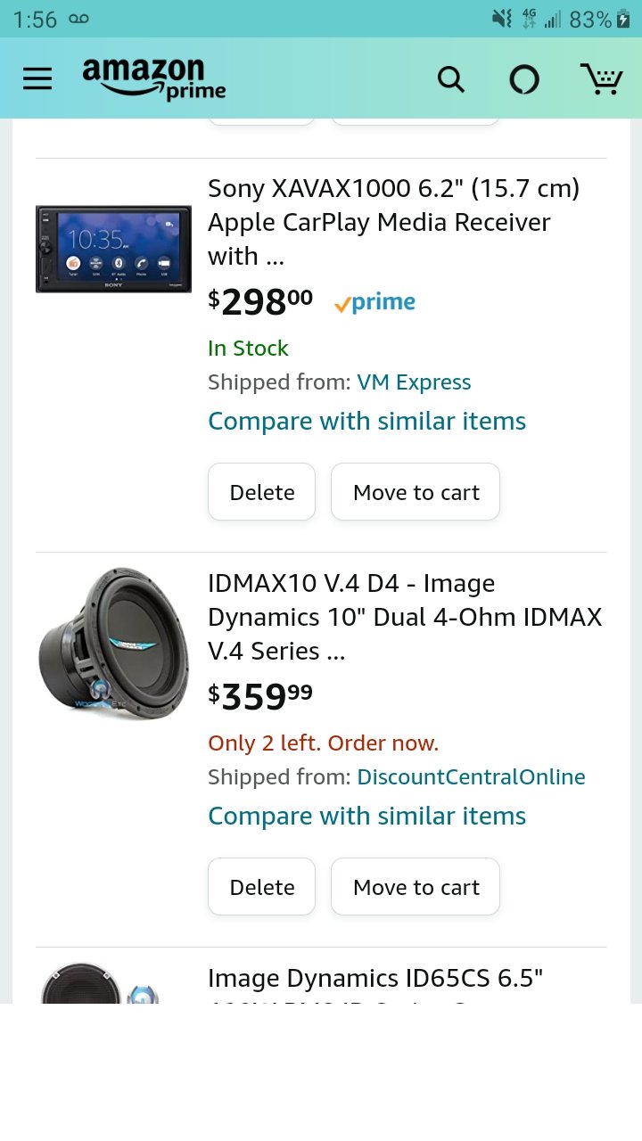

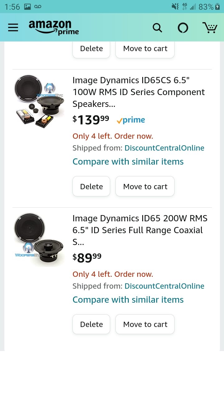

Currently piecing together an audio system for my 2011 subaru impreza obx can I get some recommendations on an amp that will adequately power this build? Or if I'm effing up on my sub/speaker choices. I appreciate any input thank you ahead of time!

I would stay away from those ID subs
Especially for $359.00
Try,
https://soundqubed.com/product/hds3-2-series-1200w-subwoofer/
Or this
https://www.americanbassusa.com/xfl-1044.html
IMO way better subs for way less money
As for amps
You need a 4 channel to run the front end something that puts out 100x4 will work.
Sub amp, look at Taramps or the SFB line from Sundown.
For the price you can't go wrong with either
Just make sure the RMS power it puts out matches or is greater than the RMS power the subs can handle at whatever the ohm load will be.
If your going with 2 subs the 2x dual 4ohm will give you a 1 ohm load which is what most decent sub amps run at
If its just 1 sub look at a dual 2 ohm to give you that 1 ohm load
