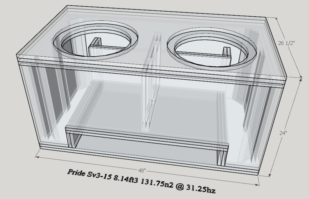

I appreciate it and I have been doing extensive research for the car audio build I'm going for it's just I wasn't sure which amp to choose for these subs. I also appreciate the box design. I'm currently working with a 2004 trailblazer in terms of space and I am also working on installing the front stage with a pair of deafbonce arnold's and a pair of super tweeters
I'll tell you 1st off that's not a design for a Trailblazer unless they widened the vehicle since I saw one last. That one pictured is for a Tahoe and only the main rendering not the design.
A design usually has multiple cutsheets along with mechanical drawings to work off of. I believe that one was like 7-8 pages long.
I'd look for an amp that does rated power into whatever load you wire to. I personally like to wire down so a massive amp is not needed to beat rise but either way your going to end up with a big amp to power those right and do them justice.
The guy that design was for ended up with a MD12K, 80ah of lithium and 2 alternators and now he wants to add more power... it never ends...
