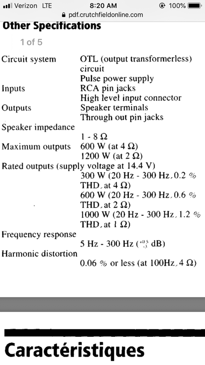

Op...  I was seeing if you'd find the issue alone
That's misleading the way it's written tho so I will try to decipher it for you, IIRC that's a 1 ohm stable stereo 2ch , 2 ohm stable bridgeable into 1 ch amp. A cheapo to boot... it will bang away  and last tho if it's loaded correctly
Not really something you could expect much from tho so I'd be aware that it's not going to be overly impressive, especially how you have the whole install done.
And loading the poor thing at 1 ohm mono will send it into protect for sure, and most likely cause failure eventually.
And loading the poor thing at 1 ohm will send it into protect for sure, and most likely cause failure eventually.
Thank you does make sense what your saying it’s an old amp with that low ohm that prolly what’s sending it into protect Like I said above ☝️I’m willing to get rid of what I have and get better 15s or 12s just wanna make sure if I get 2 15s or 2 12s in turn for getting rid of what I have that I will have just as much or more bass than what I have now
