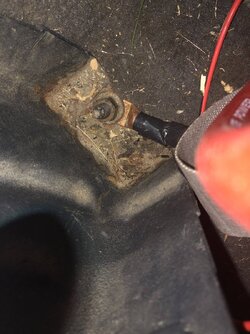

ground connections

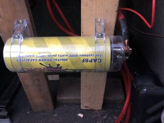

Then the problem child that’s the amp I have running the 2 15s I’m thinking maybe a wireing problem the manual says 1000w x1 at 1 ohm I have the channels bridged not sure if that’s the problem but I have previously put the wires in just a single channel but didn’t fix the problem they are 2 15 dvc subs wired down to 1 ohm

Thank you for posting your issue here.  Unfortunately the pics don't give us a good impression of your sound system configuration.
It seems like you are running different subwoofers and loading the amplifier with difference resistance??

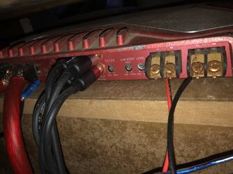

Hello again,  thanks for posting your pic of the Sony amp.
You are using cheap speaker wires so that is one issue to be attended to. Again, get a multimeter and check all speaker / subwoofer resistance on the amp and you should be able to rectify your issue.

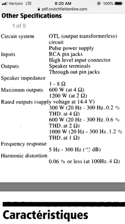

 I have a 1200w peak Sony xplod 2 channel that will put out 1000w x1  at 1 ohm as stated by the manual but I have that bridged because it’s a 2 channel them that amp runs the 2 15s
Am I understanding this correctly? the 2Ch Sony "1000" watt Xplod is bridgeable into 1ohm according to the manual?
Sounds like an old school cheater to me...  :wow:
What's a build Rockford p2? I've never heard of that? Was that a typo?
Got any more specs on that amp? That's max ratings plus where does it say it's1ohm stable bridged.
