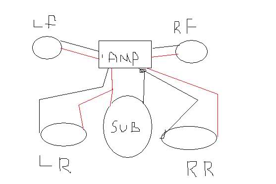

you may smoke your HU running 2 ohm speakers to it. There realy isnt anything you can do except, get a mono amp. get another 5 channel, or lose the 6x9's and run 1 coil to each rear channel. That will give you a 2x75 to the front and a 150 watt to the sub.
You could try this, but it may smoke the amp and have low sub output, and it involves crossovers,
You will need crossovers on the sub wiring, but i didnt draw them in, and its probly not going to work for you anyway.
