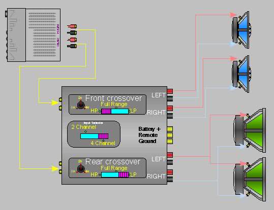

This is a diagram from section 107 you should read abit on there as well.
http://www.bcae1.com/
