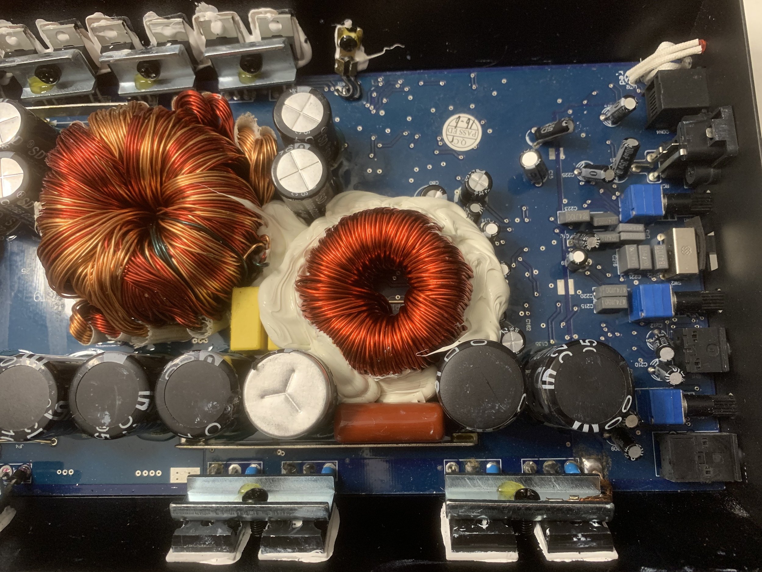

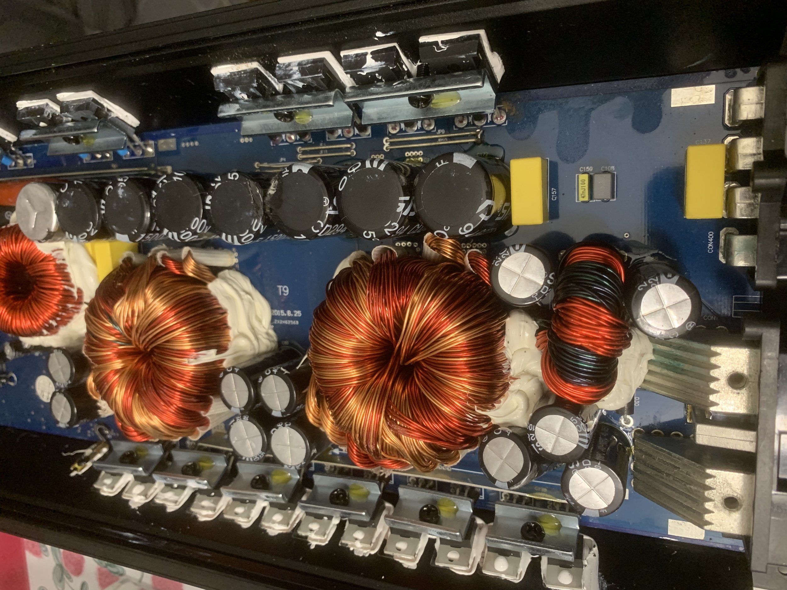

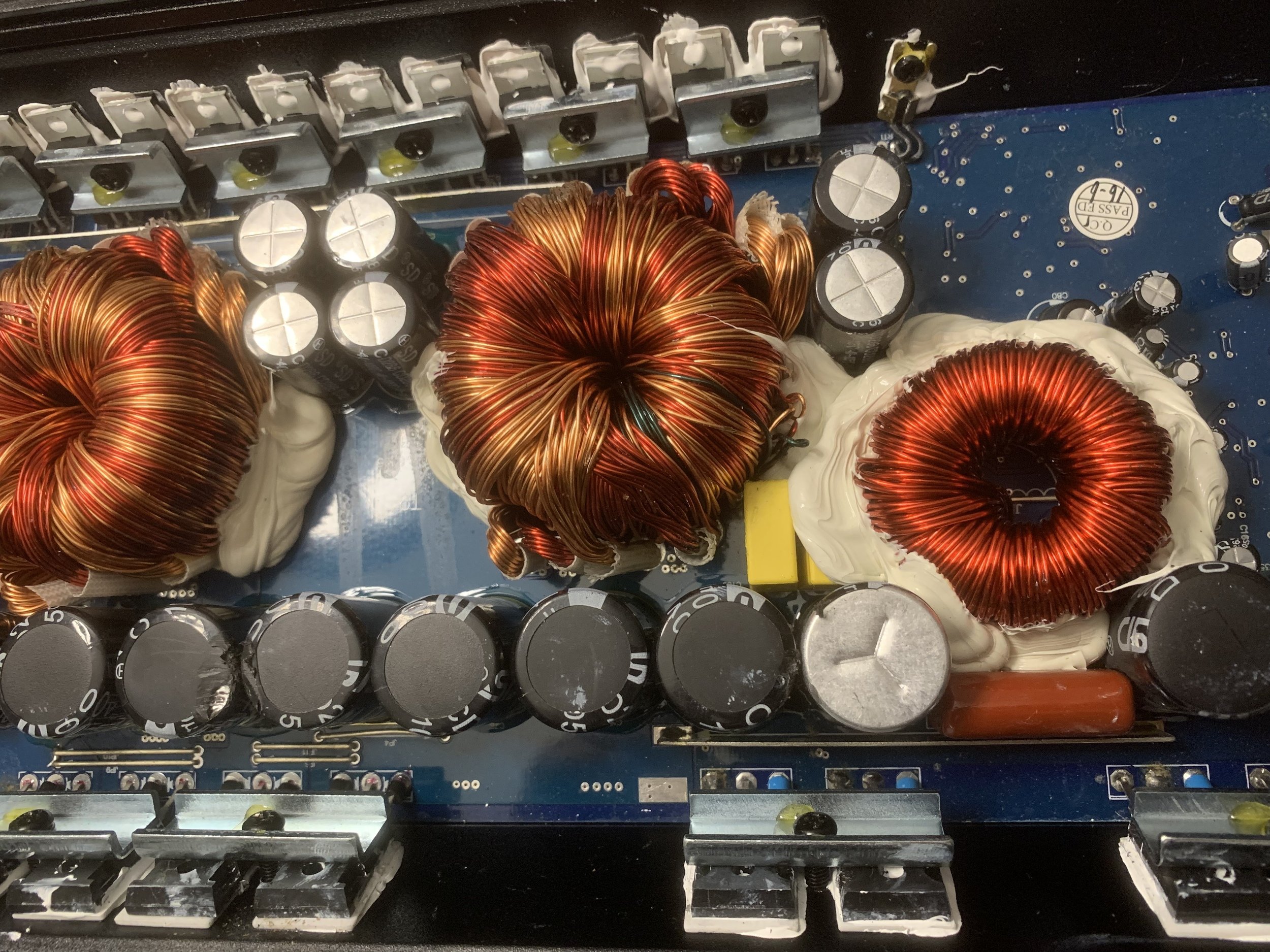

Heres couple pictures inside the amp

From the PICS I cant see anything really to be honest. You can take a Pick tool and go around and pluck on all the Mosfet legs to see if you may have a loose solder joint on the board connection ect with all the Diodes ect.
What do you think about the caps, is it normal for the plastic covers to fall out and the capacitor to be scraped
