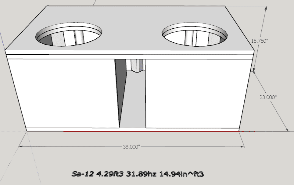

Looks like you found him... I got a bunch already designed... what's your available space in that PT Cruiser?
Small volume up to rated...
Larger and better low end up to rated...
Either of those gonna fit?

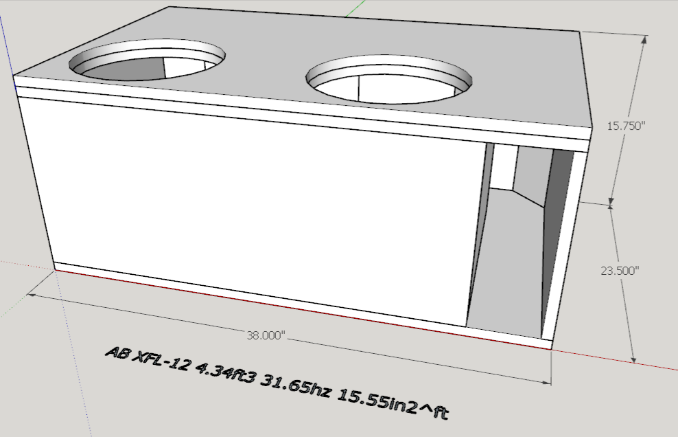

Id run a pair of AB XFLs
Those AB Xfl's will deliver... here is a low tuned box for up to rated...
H*ll... any decent pair of 12's will deliver if the box is done correctly and you supply some decent power... these were Skar EVL-12's...

I have 37 inches wide and about 21 inches deep, 18 inches high that I can squeeze back there

That 21" in depth is gonna be all the way back to the tailgate?
It is 24 deep from right against tailgate to the back where top of seat would hit. 18 high to top of the tray that sits on hatch. Taking that out would give me another few inches. 36 wide from side to side is most I can get from where plastic side panels stick out

Ok... looks like 4ft3ish comfortably with around 60in2 of port is doable... subs up/port back and up to rated?.. ill see what I can come up with. Hows your skill level/tools... can I include roundovers thru the port & port bend or just a basic slot ported box?
