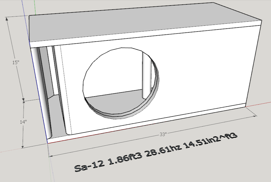

Hey Shredder, do you mind doing a box design for my single SA-12 D4 for my hatchback CX5 SUV? Have 20” deep X 20” tall X 40” wide to work with. My preference is achieving the best sound quality I can. I have the skill and equipment to build an intricate box with rounded corners with bracing.
Sound quality as in low tuned?.. it always amazes me how a lower tune sounds better. If you want a flatter response I can look at that... your call... but it's no problem... lemme know
I have a Alpine SWS 10 in a box tunes to 35 Hz and love it so I would think not to go any higher than that. I do have a DSP and a microphone with REW so I can massage the response a little so long as it’s not something crazy. Sundown recommends I think 33 Hz.
Ok... I'll look at it tonight... sub up/port back on passenger side?.. or would you prefer sub/port back?
Well... I got one I like thats pretty flat and goes low af... don't know what you want in terms of sq @Jcsaudio. This one I've got looks good to me.
It's low tuned and should blend well with a low crossed strong frontstage 70-75hz... your call... lol... I can go for a higher tune if you want to get more spl... but this looks nice to me in Winisd.
If sq was my goal this one should blend well with a strong frontstage and go low af.
[quote name='shredder2']Well... I got one I like thats pretty flat and goes low af... don't know what you want in terms of sq @Jcsaudio. This one I've got looks good to me.
If sq was my goal this one should blend well with a strong frontstage and go low af.[/QUOTE]
Nice, this looks awesome! PM sent.
