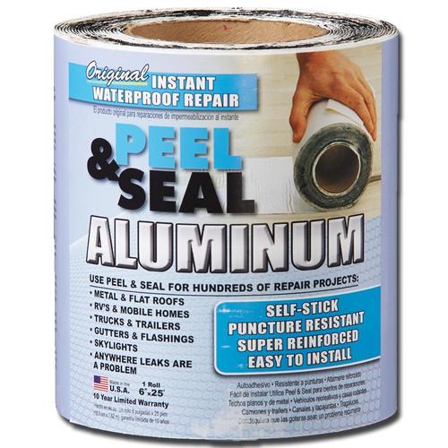

[quote name='Jaguar']Exo has a few videos on YouTube. My personal experience with Home Depot is that when I went to get some ''Peel and Seal'', they didn't have
anything like it. If your lucky you'll be able to find something at an Ace Hardware center or Lowes. [/B]
Shop Peel & Seal 6" x 25' Mastic Roof Coating at Lowes.com
[/QUOTE]
For the love of everything holy, Jaguar, STOP GIVING OUT ADVICE WHEN YOU DON'T KNOW WHAT THE FUCK YOU ARE TALKING ABOUT! You keep saying that you are here to learn.... wtf, man? I've said it before, and this is a great example... you are going to mess someones car/system/life up with bad advice. Peal n seal will not help anyone who gives 2 shits about their vehicle. Just because some idiot made a youtube vid that says its ok, doesn't make it ok. Please don't use this stuff, op. The aluminum layer is extremely thin, and the adhesive is tar based and smells your car up. If you need a low-buck option for sound deadening get some AudioTechnix b-stock. @cthedinger ;
audiotechnix is good. peel n seal is sh!...... i cant stand people that have no clue what they're talking about giving advice. peel n seal i have tried recently. took that junk out. sticking with the AD in the trunk til coleman decides to give me that new deadiner.
OP nobody in here knows what they are talking about unless they say Peel & Seal sucks. It doesnt work.
Deadener works in 2 ways. The first is by adding mass to the panel changing the resonant frequency. The second is the rubber based backing (Peel & Seal is Tar Based) absorbs vibrations and expands and converts that energy to heat that it eliminates through the aluminum layer. Tar based products dont do that.
In order to do a proper job 3 products are needed. Deadener to reduce vibrations, closed cell foam to go between panels that rub on each other, and mass loaded vinyl to keep road noise out and the music inside.

There are some floor underlayment products that would work well. I've used carpet padding and vinyl flooring under factory carpet to reduce road noise. Works well. The padding under the vinyl is just to decouple it from the floor. The vinyl is what provides transmission loss. It is similar to luxury liner pro - mass loaded vinyl with a foam decoupler.
