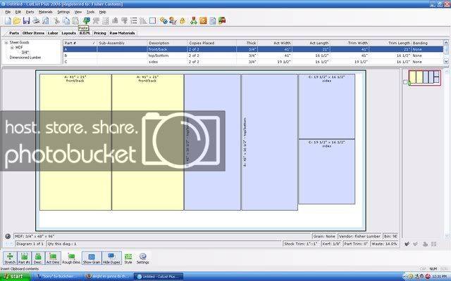

yeah it will...with like 1000 sq inches left over...i just gotta figure out what would be the best way to have home depot cut it...i think two 48x48 pieces will work the best.
no? isnt a sheet of MDF 8' x 4'....
that would give me over 4000 sq inches of MDF
all the cuts total added up to like 3400 sq inches of cuts
That doesn't matter. What matters are the orientation and placement of the cuts tard...
Just because you have the right amount of area, doesn't mean you'll have enough board for the actual pieces you need to cut.
nG
Actually it will fit on one sheet. Perfectly. This cut sheet was based on the dimensions you gave of the panel. Have HD cross cut the sheet at like 43" to haul it back home, and you will be golden.
