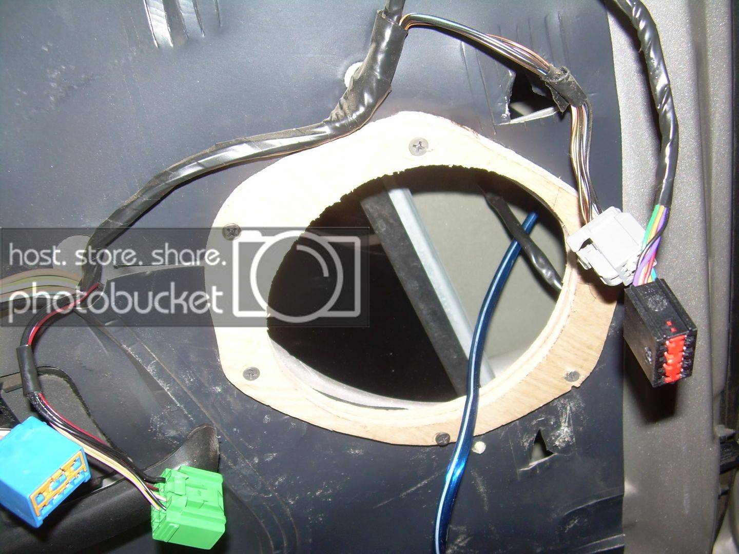

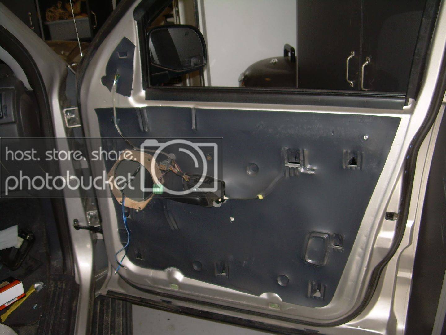

I've had two fords, this is what I did with my latest (Explorer). You can get thicker wood, and make sure your door panel fits on. This will let you put a deeper speaker in there.
