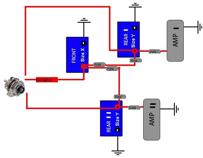

And for the battery post I run the 2 rear batteries off the alternator, then I install the Isolator and run the front one off the Isolator correct?(Says not to mix batteries that aren't the same or does it only go for different brands?)
Then I run two wires from the front battery to the rear batteries, one to each of the rear batteries? All this wiring should be done with 1/0 Gauge correct?
The batteries negatives DO NOT have to be connect do they? Just grounded in a good spot?
Edit for pic: This is how I wanna set it up? http://i233.photobucket.com/albums/ee268/Allan-2greasy/Batteries.jpg?t=1254953263
