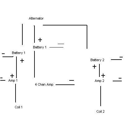

So I keep a bigger one up front, and then rest in the back next to the batteries?
I am looking to run 2x 2000 Watt Mono Alpines, probably just go with a battery for each, sound good?
So maybe get the biggest one I can find and put that up front, then one for each amp maybe a step down from the one I have upfront in the rear as close to the amps as possible? How do I wire this? I run one wire from the alternator to the front battery, then use an isolator and run 2 more wires to each rear battery?

good luck fitting like 4 batteries under the hood, usually do the biggest one you can fit under the hood and the rest by the amps
