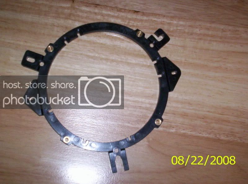

I would use Crutchfield just as a guide .. Check the dimensions on the Sundown components top and bottom mount.. depths.. go to crutchfield and check out a number of component 6.5" sets.. check out those dimensions. Crutchfield often packs 6x8 to 6.5" adapter plates for your truck with the speakers they offer.
The plate usually looks something like this:
