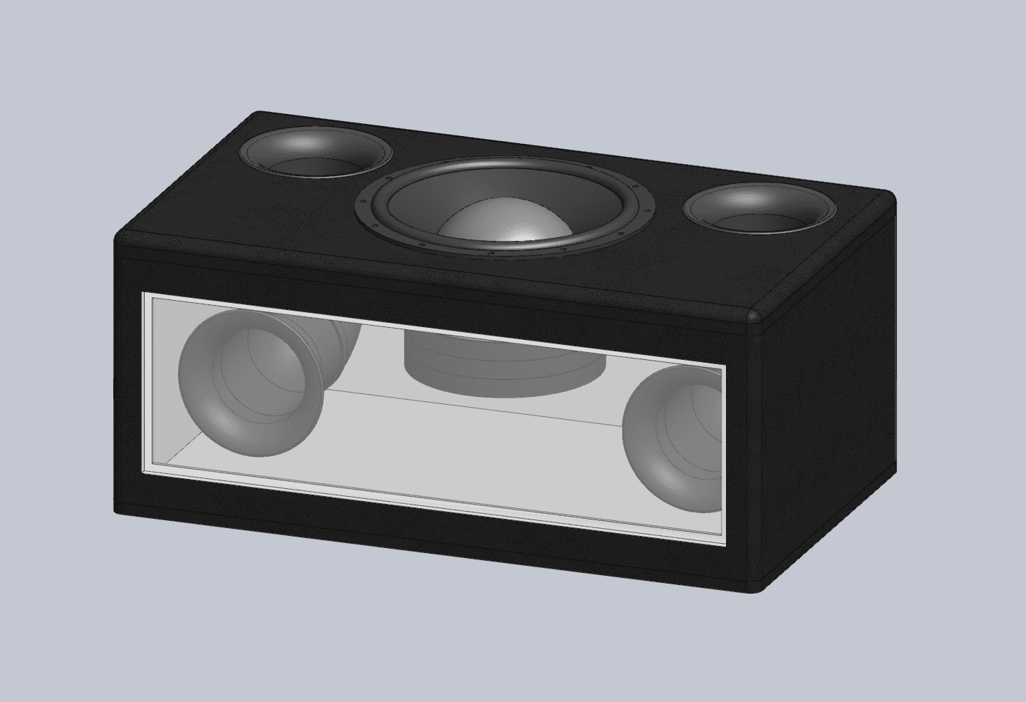

the pole vent on the bottom of the magnet (the hole lol). make sure that it's pointed down between the aeros, not on top of one. so it should be pushing air between the gap of the 2 aeros
I think I'm gonna do the whole sub-over idea, i know i should keep the end at least 6" from the wall, but is it had to ahve the port itself too close to a wall?
If it's too close to the wall yes that's bad...how close were you thinking?
about two inches away, but i just calculated the arc length the 90 degree bend adds and it adds a little over 5" or port length to the aero.
Oh, and new design, with the 5" of port the elbows add
