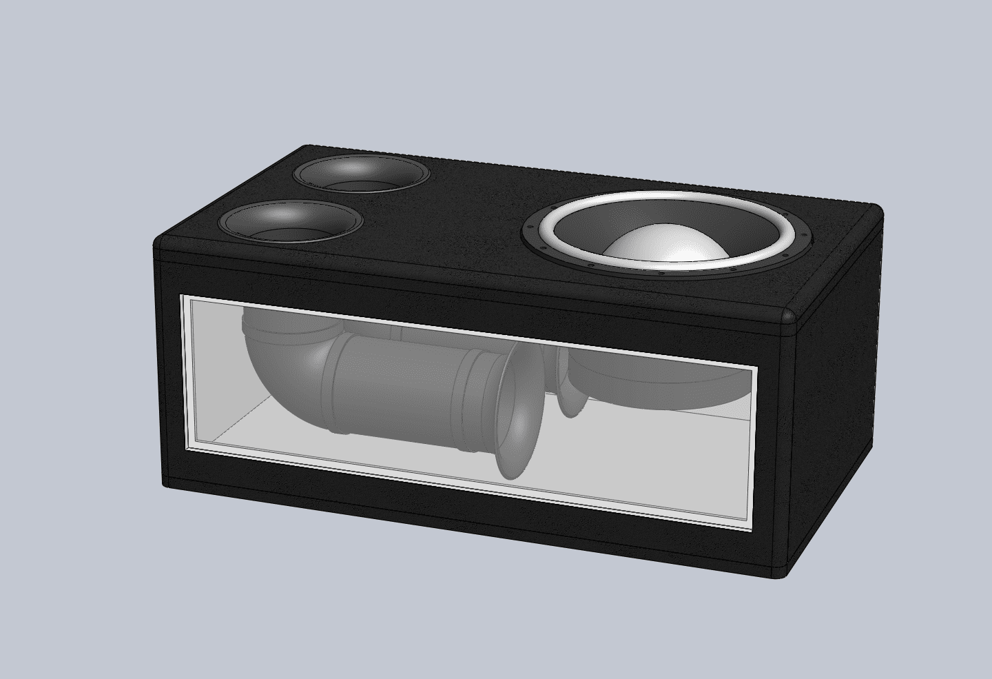

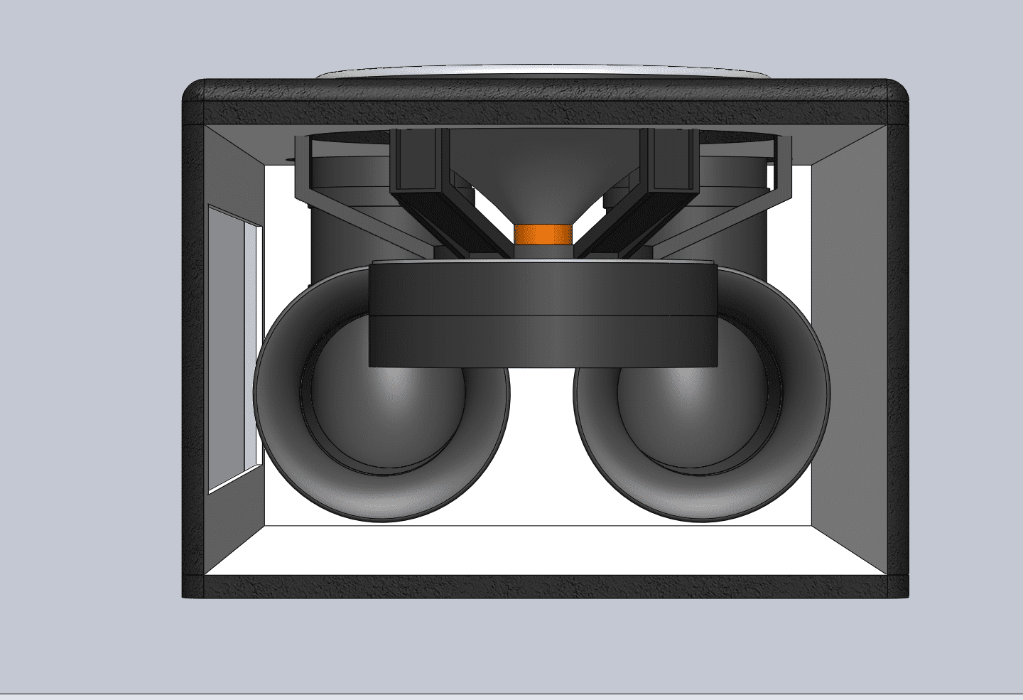

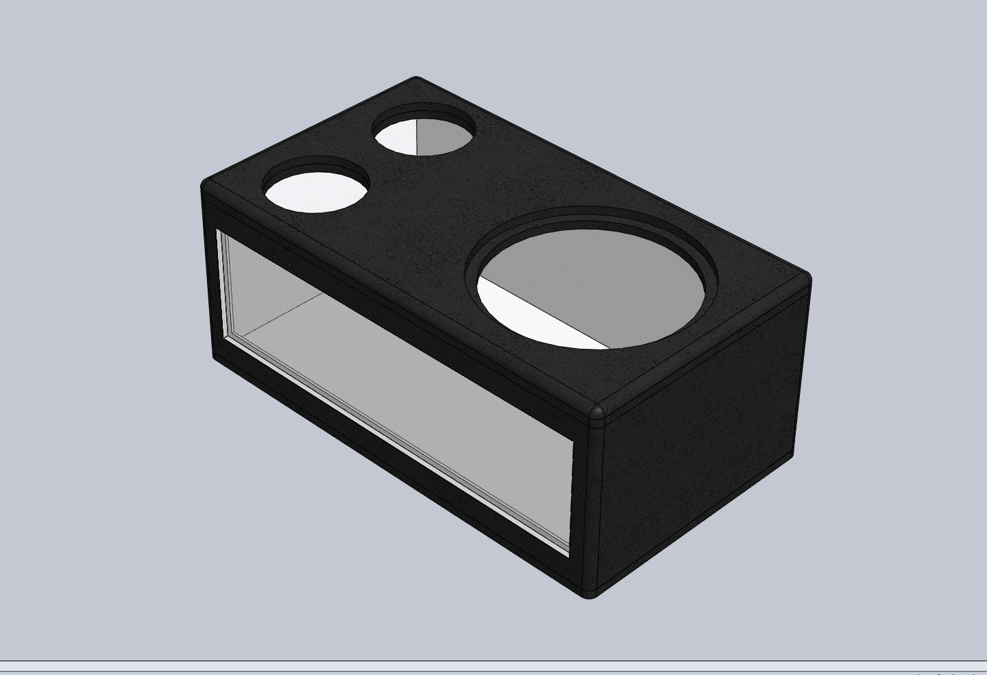

k guys here's my problem, i have to have ~52"^2 of port area, so i need at least two 6" aero's But the only way to fit them in a 41.25 x 23.5 x 16 box with a huge 18" woofer is the way pictured below. I'm just trying to save space, I can do slot ported, but I'd prefer to use the APs
what problems might arise from the way I have my aero's configured atm?
they make the 90 degree bends, but i remember reading in a few threads about not wanting the port opening too close to the magnet. I dont know how far it is actually supposed to be, but that looks too close. I think i read it posted by audioholic. Maybe ram knows the exact distance needed.
How do you feel about external aeros? Keeping the bend in there you may only have to stick them out a few inches
I asked about how close they should be from the back wall of the box and was told at least the size of the port opening. But Idk if it would be the same with the magnet or not.
Dims are 41.25 x 23 x 16 netting ~7.2 cubes
Aeros are 2 6" so ~.7 cubes for ports
~.2 cubes for woofer displacement
So the driver would see ~ 6.3 cubes.
I'm thinking about raising the box to 17" for nore air and more space to work in
All parts are modeled by me, so thanks for your conplimennts //content.invisioncic.com/y282845/emoticons/smile.gif.1ebc41e1811405b213edfc4622c41e27.gif
I'm also looking at trying to export my tube flares and subs into a compatable file for sketch-up
nice sketchup. hope it comes out great. looks close to the magnet, but im no builder or designer
haha, thanks, yeah, I'm trying to figure this whole thing out too //content.invisioncic.com/y282845/emoticons/frown.gif.a3531fa0534503350665a1e957861287.gif
