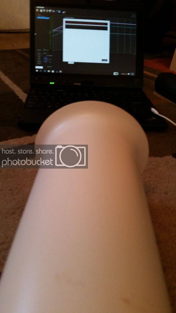

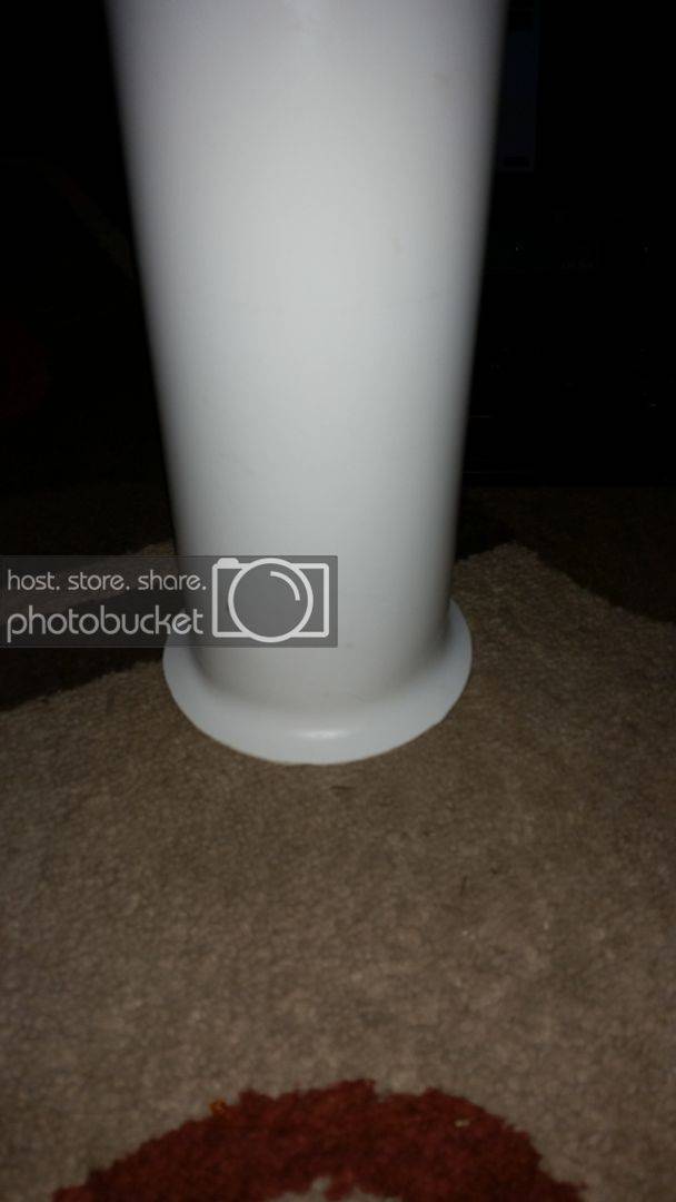

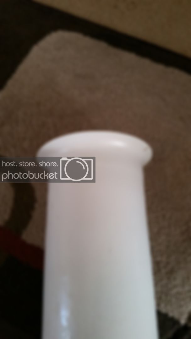

Hey bud don't be afraid to make your own ports. It really can't be easier. I just did mine and the first one I did came out great. You don't need anything that you already don't have.
I put oil in a pan, heat it up. Just make sure the pan is clean when you do it. Put a bowl on your counter on some rags that you can get oily. It takes no more than 5 minutes and that is not rushing it at all. I put the port in the oil, wait 20 seconds and then press it on teh bowl. Do it like 3-4 times and don't press hard. On the last time you do it hold i there until it cools. I really couldn't believe how easy it was to make.

I flared both, my port is extrenal and is joined by an elbow. Works great. Mine is a 3inch pvc and no noise on a e8.

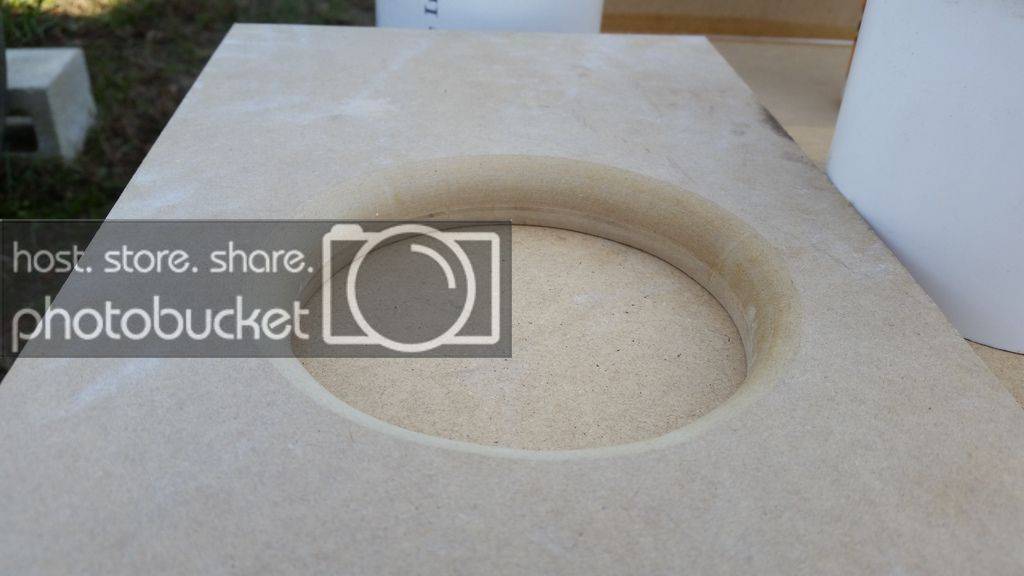

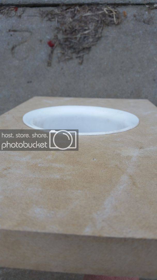

Go with a 4" aero, 3" won't be big enough IMO. I ran a ran a 4" with my zvx-8 in 1cuft and it was perfect. I usually make my cutout for the port then hit it with a 3/8" roundover, this let's the outer flare sit nice and tight.
I heat up about 1" of cooking grease on the stove and dip the end in for a couple seconds then put it on the bowl and get my flare on. I've done it 2 ways: flared one end of the port and attached it to the panel, then flared the other end. I've also used a coupler so I could flare a short piece for an inner, but mainly because I wanted to be able to adjust the tuning.
Flaring with a panel attached won't be bad since it's a smaller box. The weight actually makes it a little easier to get an even flare. No way I'd flare just the outer and not do the inner.
