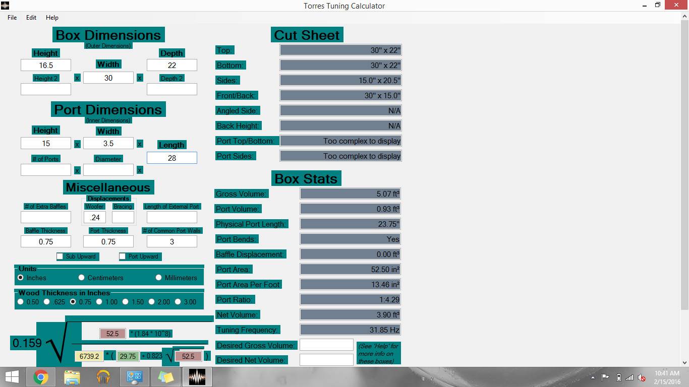

I really need a ported enclosure plan. I have a 2015 Honda Accord coupe. I want it to go all the way back of the seats so I can put plexiglass and make it look nice. I have 2 Jl audio 12w6v2. With a Rockford fosgate 1000.1 power series. The enclosure has to be 30 inches wide 22 inches deep and 17 inches high. I don't mind if it's smaller but those sizes are the maximum. And I would also like it to be tuned to 28-32 hertz
Those subs dont really need a large box but since you are underpowering a bit, the extra efficiency should help out. I'm guessing you like heavy low end rumble.. If you like punchy upper bass and overall SQ, i'd go with a different tuning and box size.
okay whats a good tuning frequency for punchy upper bass? I like both, thats the problem. I'm kinda new to building a enclosure. what would be louder? my current box is tuned to 39 and its pretty loud. Also do you have a picture of how the box would look? like a blue print
