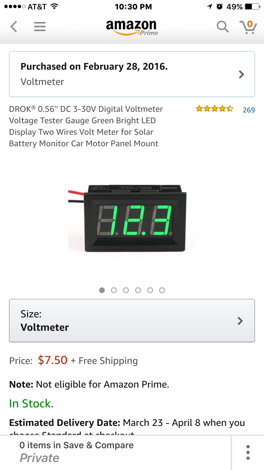

I ordered a voltage meter for my van so I can observe voltage stability , drops etc etc . I know I can run wires from the battery but would like to take a short cut if there is one . Can I tap into the lighters positive and negative or must it be the battery ? Any other suggestions ??
