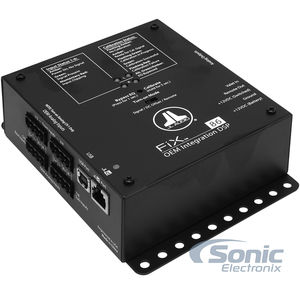

Your best bet is to do what you need to do to get a deequalized signal to your amps. this could work since it has speaker level inputs

Again you weren't listening i said head unit OR dsp. If you dont know what a dsp is you should google. It allows you to keep everything stock and do what you need to do.

Yes I did look it up. I have not heard of a DSP until now but what I'm seeing from limited research is it's basically a better type of LOC that gives you more control over your sound. So with a good DSP do you think I should get more bass out of my system? Also I was merely trying to explain why I can't change the factory head unit or won't although it is ideal (no disrespect) I appreciate the input.

These DSPs have factory de equalization which gives you a flat signal and sums up all the signal to give you a full range signal along with restoring bass. These arent your normal garbage audiocontrol LOCs that do absolutely nothing other than amplifying the garbage signal.
If you can give up the use of your head unit, you can just have music played straight to the DSP via bluetooth which bypasses your head unit completely but you'll need to amp everything with the signal coming straight from your phone to the dsp. This gives a very clean signal.
