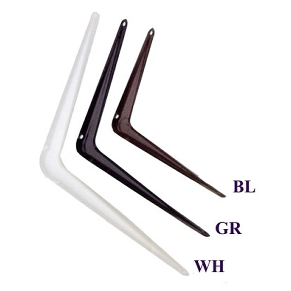

You dont need fvckin 3" screws to attach a seal/beauty panel to your box. 3/4" screws would be more than enough, using 2 L shelf brackets per side would be plenty
I used these, there like 50cents to 2 bucks each depending on size
And yeah use plywood or mdf whatever you have kickin, who cares if your no good with a saw, I sure dont get my beauty panels a perfect seal first try everytime, who cares if it takes 10 cuts, just keep making adjustments til you get a tight fit.
Jigsaw would obviously be best, with carbboard template to get the initial shape.
Cheap easy and effective
