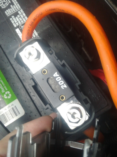

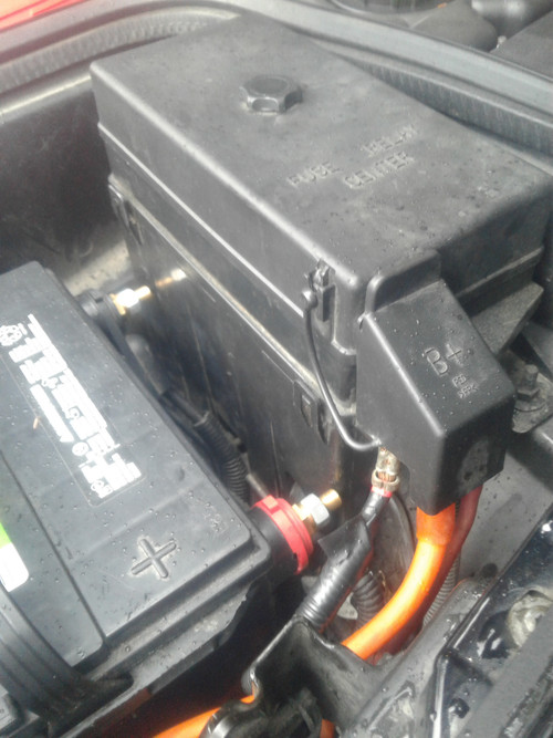

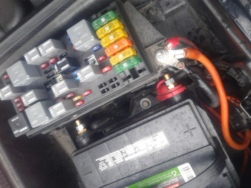

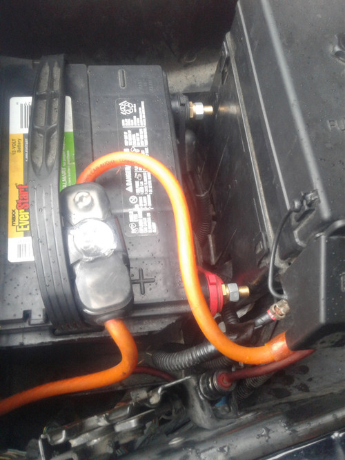

Wait. The shop connected 0 gauge wire to the fuse box?!?! Maybe you should post a couple of pictures so we can figure out what is going on.
I will post some pictures here for you in a minute. You'll see how they have it wired, maybe thats the issue.
I will also show you a video of my in dash DIC with all of the numbers jumping around on my battery voltage no matter what the gain is set at. The DIC measures my battery voltage constantly. As to why they put a 200A fuse on a 400w setup I'll never know, but as you'll clearly see they did.
I'm not sure why they went to the fuse box, but they certainly did for the main power wire. As I said they used a 0 gauge power wire for a 400w system and a massive 200A fuse for it too.
Even the ground is 0 gauge.

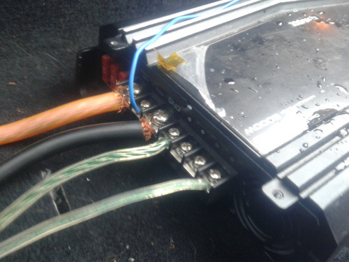

If you look to the left of that you'll also see the 3 40A fuses I was talking about on the amp itself.
The kenwood 9106-D has 120A worth of fuses on it alone.

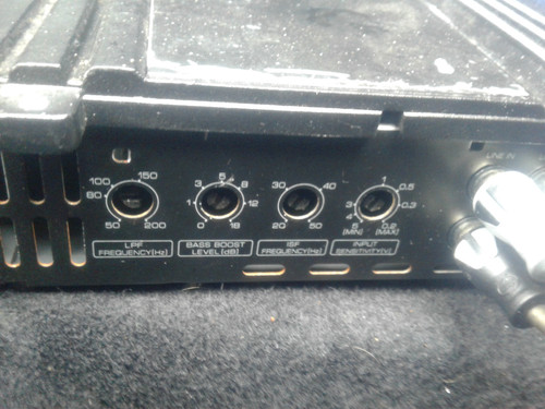

On the amp itself here is my configuration for the subwoofer.

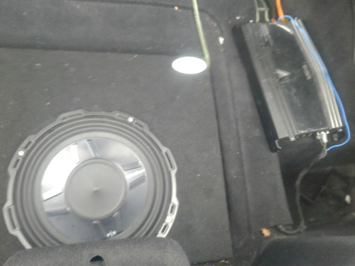

The subwoofer is a rockford forgate P|3 (P3SD2-12) capable of 400w RMS
The sub is wired for a 4 ohm load since its a DVC shallow mount sub.
28.28v is just barely before 0.5 on input sensitivity when configuring for a 2 ohm load with a multimeter for 400w.

C6 Corvette huh? Anyone gonna say run a ground to the battery or should I? The frame on the C6 is Aluminum. Run a ground to the battery from the amp. See if this helps. Or run a ground to a distribution block near the amp and ground the amp to the block... either way, run a ground to the battery.
I can't think of any reason they connected to the fuse box and not the battery?
The wiring is overkill but its more fun that way.:love:

So first I would have my connection to the battery NOT the fuse box (especially since you have 0 gauge ran and it will be very easy to do). Second, either your alternator is producing 110 amps and you need more production or 110 would be enough but you are not getting it.
There is no way 400w should be making the car start at 10.9v with rough idles.
I agree with ThxOne. Ask your installer to do what is called a Big3 install. It should solve your issues. Since you said the car is heavily modified, I assume bigger injectors and coils, so this also draws more from your electrical plus an amp. This may be more than the oem grounding wire was designed to handle. As for power cable, it is connected to the terminal stud. It is no biggie since the amp uses a maximum of 40 amps at full tilt for very brief moments.
OP, it doesn't matter that the amp only draws 40 amps full tilt for very brief moments. The 200 amp fuse is to protect the wiring. If there is a short, what will give out first the 200 amp fuse or the wiring to your fuse box terminal? Because it looks to me like the wiring to the fuse box terminal is less than 0 gauge. If the wiring to the fuse box stud is fused or capable of handling 200 amps you are fine. If it is not, then it isn't a matter of opinion, it is done incorrectly.
If it is incorrect drop down to a 100 amp fuse or connect it strait to the battery if you care about your car.

a shop installed that? You literally have the correct battery terminals to install the wire why the....... just don't go back there. Tell your friends and their mothers, just do not bring your car back unless they are giving you money back and they never touch a car again.
What is the other wire that runs off the fuse block and goes to a round fuse holder? that style fuse holder is crap, shouldn't be just hanging out vertical either at that as water gets in there it will sit and corrode the connectors faster as there is no heat shrink even.
Yes ground needs to be confirmed good on that vehicle. the power wire needs to be moved to the battery and can be robbing power from the relay/fuse center especially if the ground is incorrect that will be drawing a serious load and that is the cars source of power, the ECU will not be happy with this.
to the ground being 0ga- yes ground needs to be the same or more that of the power, it is a circuit.
Why is there water on your amp? Keep it dry please!
that 200a fuse is not indicative of what your amplifier can or can not pull, that is for the wire incase there is a short. the fuses in the amp are for the amp. It is not more resistance to have bigger wire and higher fuse rating, it would be less if anything but it is equivalent of having the correct sized, so you have headway so youre good there.
the connections at the amp is astonishing a shop would think it is in the least "ok" and the power coming from the vehicles power distribution box is mind boggling.

Yes, a shop actually did the install. Thats what they thought was what an install was supposed to look like. The amp isn't mounted either if you notice.
That is the old power wire for my old setup, they never removed it. They just disabled the line by removing the fuse.
The ground I will definately have checked.
I will definately move the power wire to the battery when I get home from work tonight.
