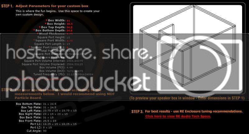

A few questions about a ported box for 2 RE SE 12's
I would do 1 solid box, it would take up that much less space and look better IMO. Plus less work. I would think 80sq inch port would be overkill for these and make em sound like cr@p, I think a 50sq inch port would be plenty, but then again I have little experience with the SE. What kind of sound are you looking for?
I just want to get loud and retain some SQ (who doesn't? lmao)....
Whats the differences between the sizes of the port?
airflow...you cant put a 12" port with those subs.. haha.. just wont work right.. same as putting a 1" port. thatll cause port noise.. i recommended 80 just for a little extra.. but if you want somthing more realistic i guess do a 60 sq in port.. ( width x heigth)
How's that look?
4.4 cu ft. before displacement
After displacement would be 4.14 cu ft.
@32 hz.
