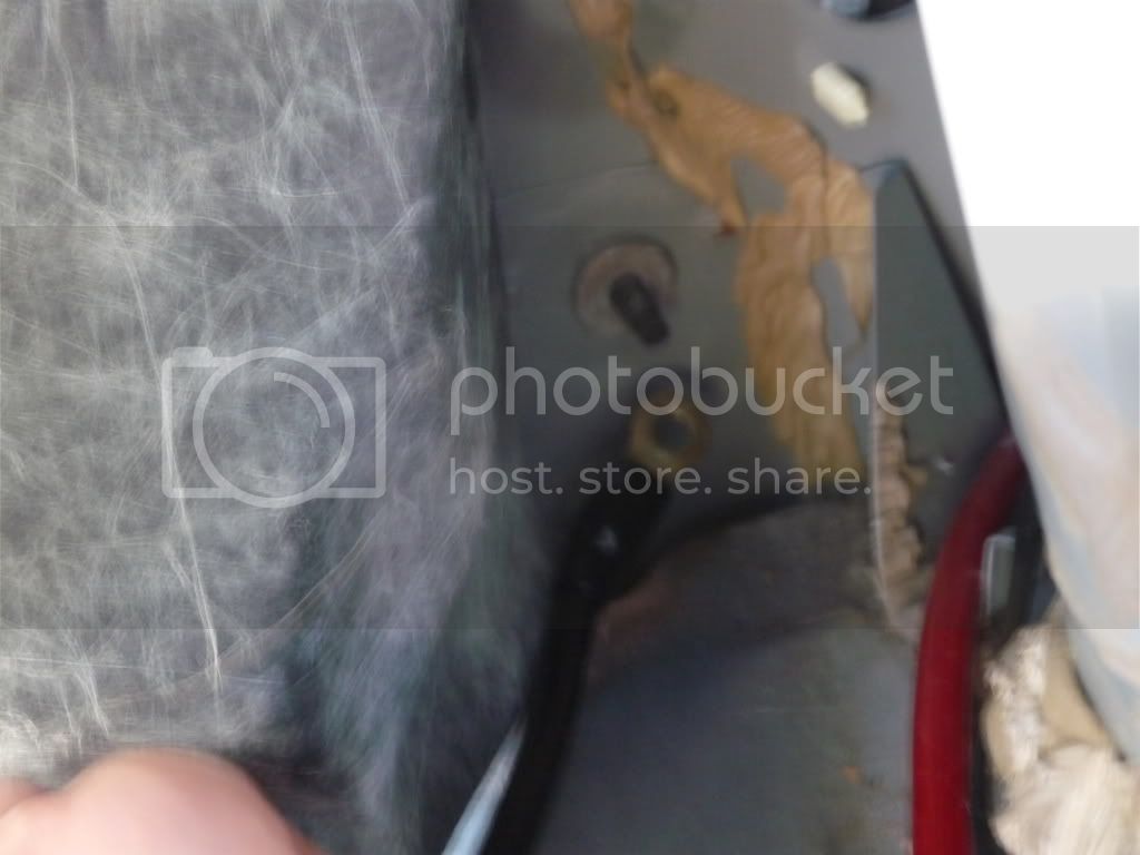

But yea. Like I said. Bottom left bolt.
If you pull back the right side trunk lining and stick you head in there you will see it.
Unscrew the bolt. Sand down the paint on the trunk side. Put a ring terminal on your ground. Find a nut that will thread onto the bolt and ratchet it down nice and snug.
If you have any more questions just let me know.
It just so happens that my ground came undone today.
So I took pics for you since I had to go back in fix it.
This is the bolt I was telling you about. The one on the bottom left. But in this case the bottom right since I was inside the trunk when I took the pic.

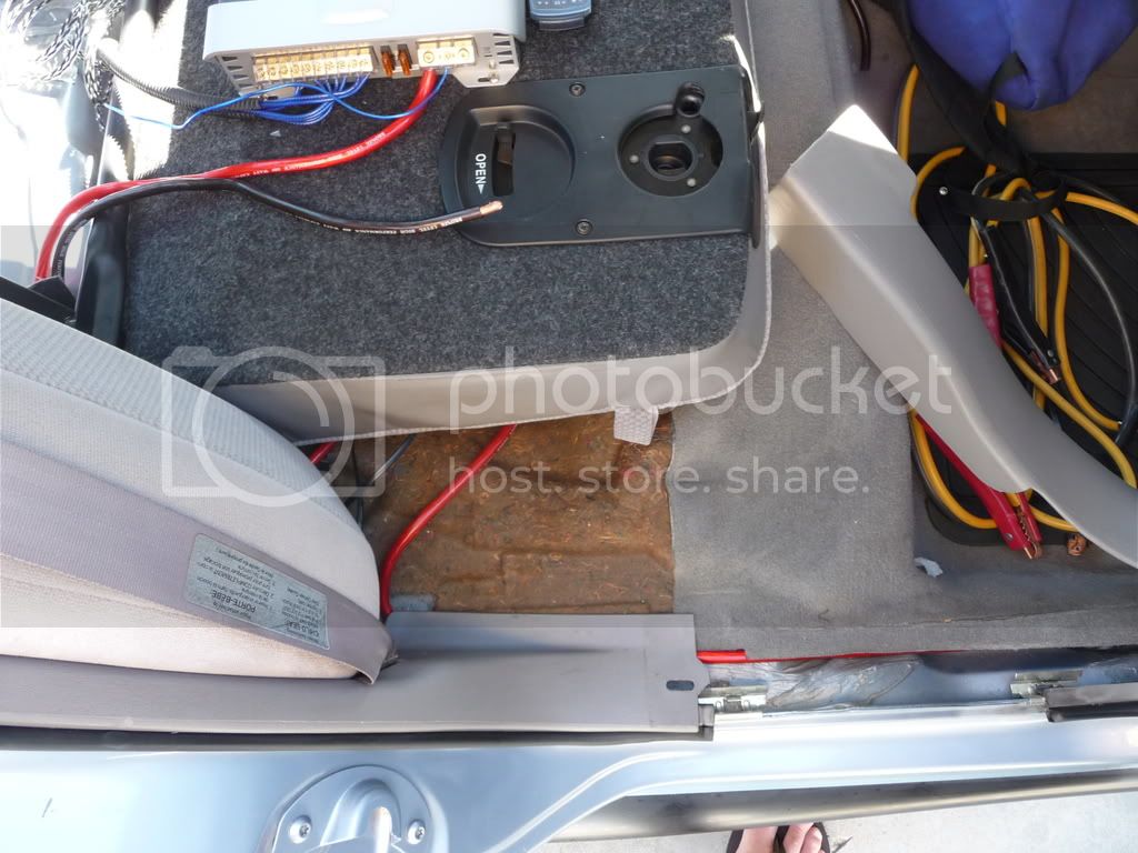

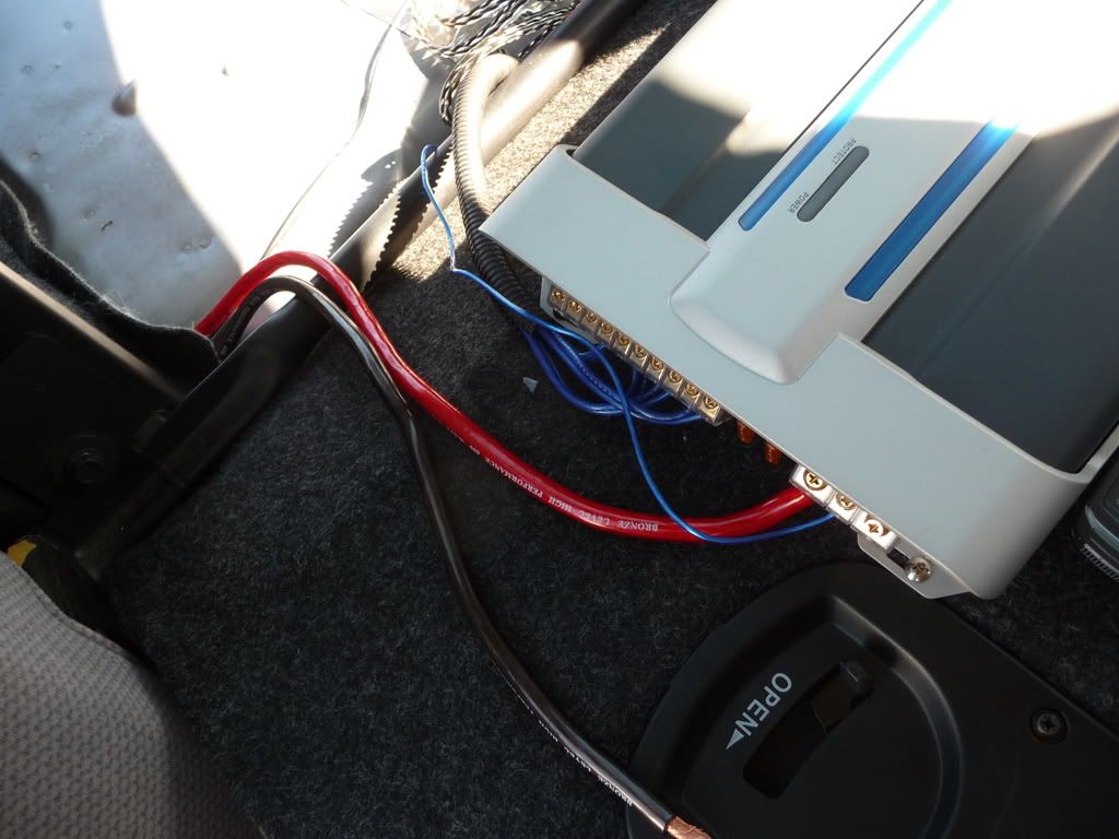

Some random ones I took of my wiring. I decided to reorganize it so it looks neater. This was how it looked when I pulled the seat out.
Nice and clean.
I like how that looks, I'll probably do that when I get a chance to. From the looks of the pictures I'm going to assume that you just screwed the amp into the back of the seat.
jmanpc could you tell me what's wrong with my wiring, they look pretty neat to me..
