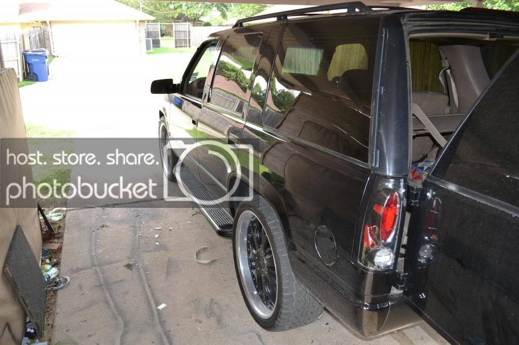

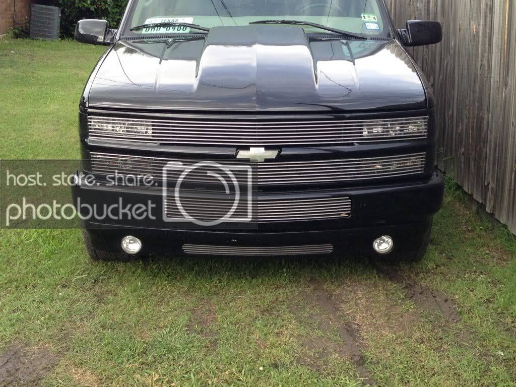

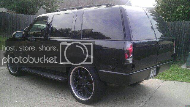

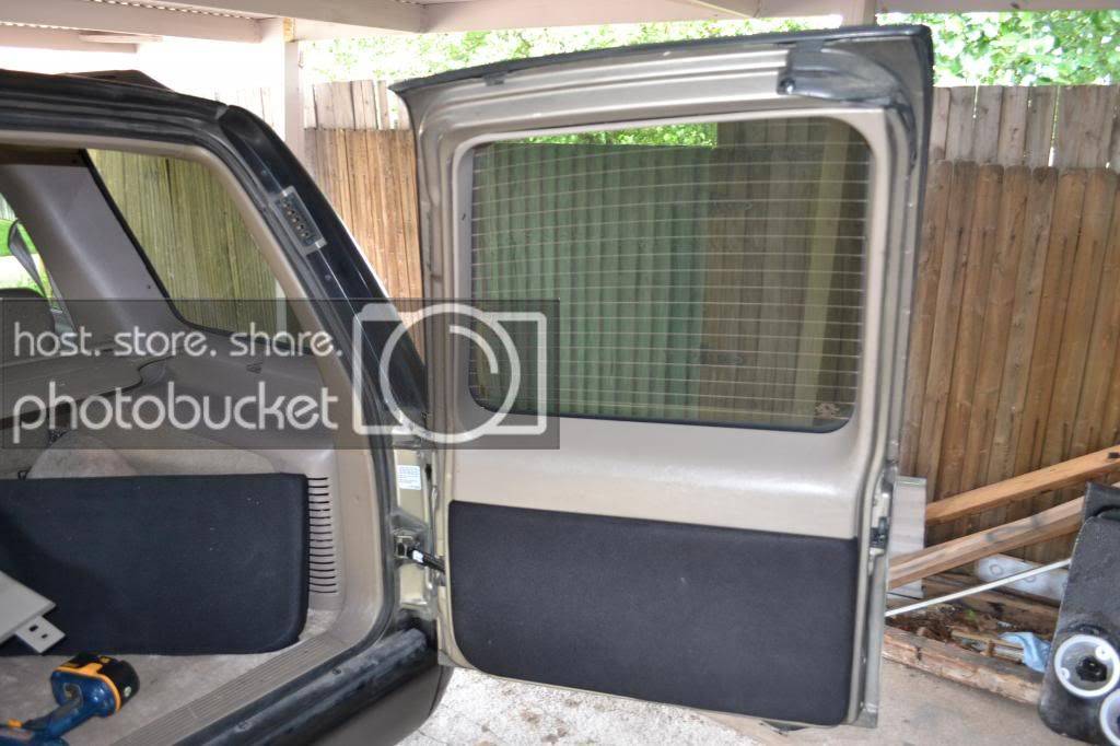

Anywho, here's some pics of the truck

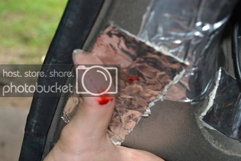

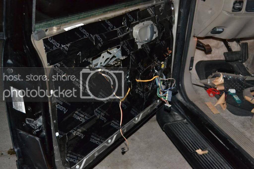

Started off with some deadening
It's not a build till you bleed lol
Anywho, onto more deadening

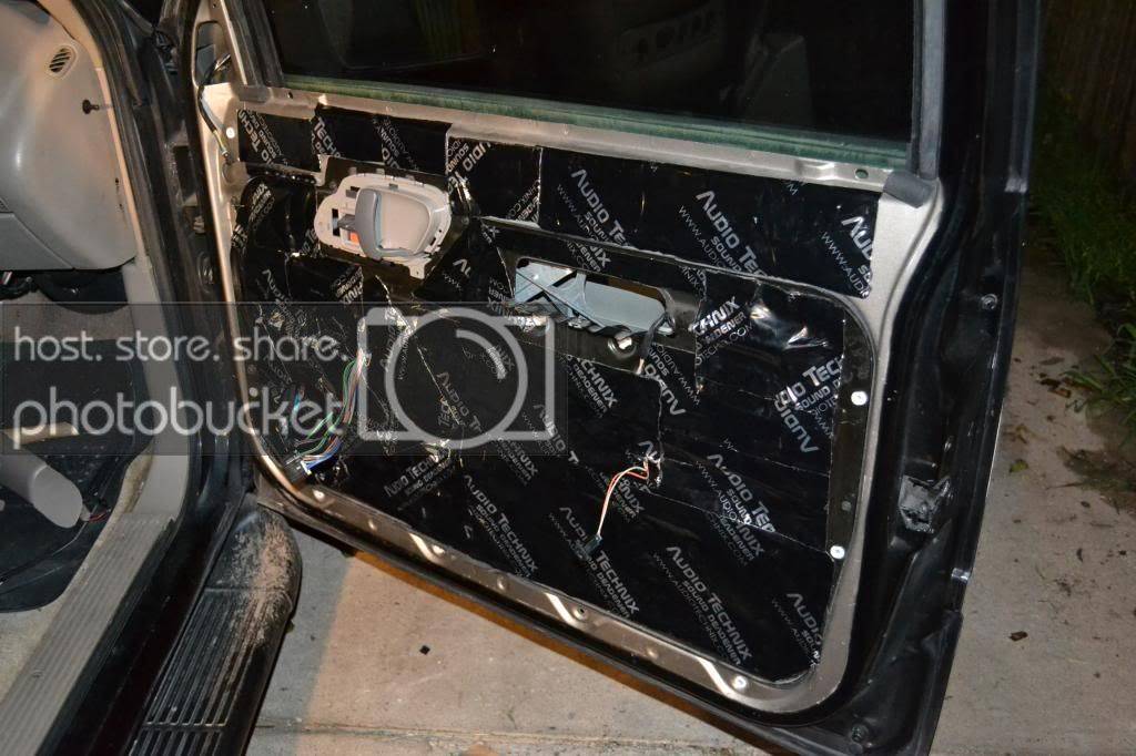

Door were pretty solid to begin with, pass side done
Driver side done

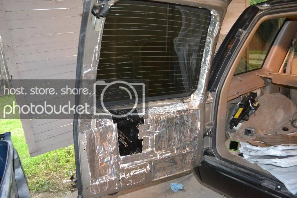

Halfway done deadening, still gotta do the roof and great stuff it. More pics coming

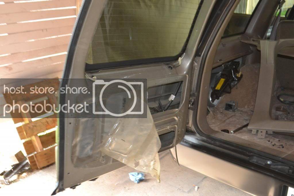

So far I've got the rear hatch and front doors done, the rest, aka the roof, I will be going tomorrow
Tonight I slowly began removing all of the interior, carpet will be getting dyed black, alot of pieces bedlinered, etc.

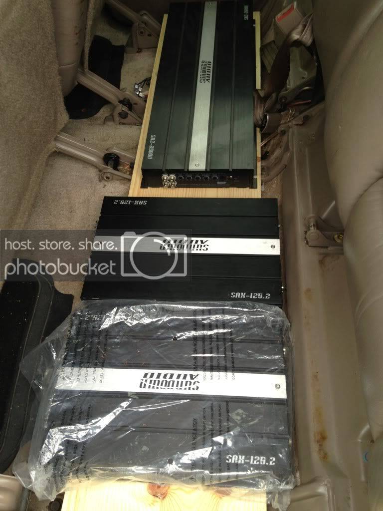

Here's a possible amp rack design I'm thinkin about, it's a shame they won't good in there like to where they look like they are one long *** amp, just barely doesn't fit
