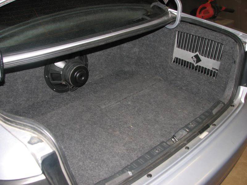

I am installing a system from front to back and need some advice. Its a 2000 mercury mystique(trunk car) and I'm not completely ignorant at this stuff just don't know some of the more intricate details. I will list what I have and have done then what I think I need to get and do. From there is where I need help. I know some of you will rag on me about some decisions in products used, I am aware of the limitations of these things and better quality will be purchased when the products I have fry so I don't need a list of buy this and that I need info on install etc. Here goes: What I have installed: Head: JVC KD-S39 All doors: kicker DS682 component systems (1 speaker each door, 1 tweeter on pillar) Rear deck: audio pipe ts-vr8 8" 4ohm dvc 175 rms each x2 Trunk: kicker 10cvr124 12" 4ohm dvc 400 rms each x2 Door amp: audiobahn a4004j 50x4 at 4ohms Rear deck amp: audiobahn a4002j 250x2 at 2ohms Trunk amp: audiobahn a8002j 500x2 at 2ohms Xover: planet audio ecb20 3 way active What install I have done so far: Installed head unit with the only connection to the rest of the system being the RCA cables and the remote turn on the remote runs down the driver side with the 8 gauge power cable to the trunk the RCA cables run down the passenger side to the trunk along with all doors speaker wires except the rear driver door speaker wire runs under the back seat to the passenger side and joins the other three doors wires and RCA cables before entering the trunk the rear deck is custom made panel that has a baffle board that holds the 8 inch subs and the terminal plate for them that is bolted to the top with a layer of weather stripping underneath to help seal the box that is attached to the bottom of the rear deck for them it has also been foamed in completely underneath and the rear deck is solid the trunk has a framed and paneled floor the box for the 12 sits on top of that up against the back seat frame it is 38 inches wide 16tall and 15 deep at the top and 18 deep at the bottom so it basically has a slant of 3 inches on the back side against the seat with the subs and the terminal plates for them on the trunk side and it's sealed the sides of the trunk have been paneled and framed the driver side rear pocket is built into a battery box that will have the distros on top and the passenger side is paneled into a cove and will have the amp rack and xover tucked there the side of the box for the 12 as well as the whole front between the backseat and the box and the sides of the car have all been foamed so that the trunk is completely sealed as well as the vent pockets in the rear corners basically the box for the 12 is completely airtight as well as the trunk area itself outside of the box
What I plan to do and need advice on 1 Run two lengths of one gauge wire to the rear battery with 1 gauge to 4 8 gauge distros coming of the positive and negative to the amps 2 Install hi low converter on the high side of the deck to gain two more sets of RCA cables for a total of 4 set to run the doors off two sets and two set to the crossover that has 3 output creating a four-way system: doors, bass, mid, treble 3 install six by nines and tweeters and another 4 channel amp 4 CCF and MLV in the doors and floors and trunk lid and trucks sides with CLD tiles on all the door and fender and trunk lid skins as well as a spare tire well and roof of car 5 cut 3 3 inch holes in the rear deck for a direct air coupling between the cabin and the trunk? This will create a sort of 4th order bandpass I think???? This one I need an answer on before I do it ASAP 6 build amp rack and install 2 push fans and 2 pull fans to force air over the amps and crossover 7 last but not least is finalize all wiring positions and mounts and install 300 LEDs in various spots locations all wired together to controller then I can add the padding and final material to cover everything
I am sure I have left a few things out on the sides of what I have done and what I plan to do but this is it for the most part any suggestions ideas creative solutions to problems not seen will be greatly appreciated I plan on entering this car in USAC and IASCA sq competitions starting at the Rookie level since this is my first ever
By the way I am in Tulsa Oklahoma if anybody lives around here that can help me out or has the équipement like a good RTA or sound generators(not phone apps) or even a term lab or equivalent to test all this it would be even more greatly appreciated just let me know and I'll give you my number
Thanks in advance to all those who help will post pics today in a build log

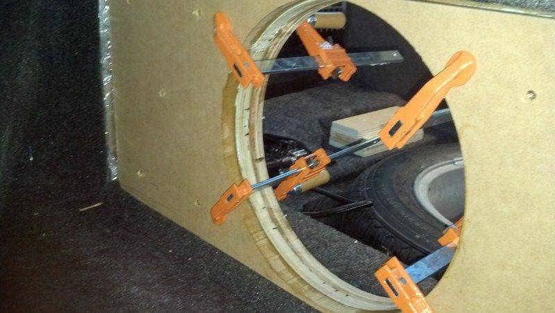

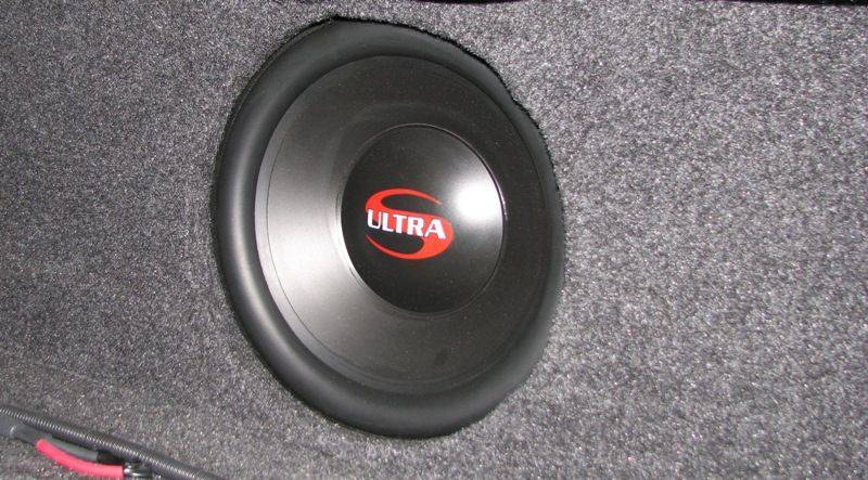

the sub bezel stays in place, the hole for the subs gets a bit larger to clear the surrounds. i recommend some closed cell weatherstripping foam around the bezel to seal against the wood.
it ends up like this (except with the box on the back):
i recently thickened my baffle to 2-1/4". a few more layers won't hurt you either
Sounds good to me will that effect anything soundwise with it firing right at the back seat? The seat itself has no hard internals that I know of, maybe a frame, stiff foam and padding with the cover over it held by the cinched cable around the backside (OEM SEAT).
Thank you on the wood work. Its all getting covered with the same color as the rear deck prolly with a thin layer of foam underneath for texture other than hard wood like the rear deck is.
The sub box and eight box is built into the car and can't be moved neither can the rear deck panel. Well they can but it would **** as everything is screwed, glued, caulked, foamed, and sawdust wood puttied into place. I can however cut the holes in the back for the new sub face while its installed and just put another layer over the existing sub face and just use it as internal bracing?
Then use the mdf rings in between top of bezel and baffle to ensure space between seat and cone OR
on bottom side of bezel as it is now and bolt this way: Baffle bezel mdf with a bolt going thru all so that the flange is sandwiched and doesn't get marred up from bolts and nuts rubbing it?
Plan on getting another head unit soon but why not run a DSP if I plan on continuing to compete and decide to upgrade later I will already be a step ahead right? And plus I thought the processing capabilities of most reasonably priced(under300) HU is limited and a mini-dsp plus a $200 deck is less than the high end deck alone that has the same or less capabilities right? I dunno for sure just seems that way to me.
a miniDSP would need to be 8 channels to be of much use to you. and you need a laptop to make adjustments. a 2 channel unit would only give you an EQ that is cumbersome to adjust. if you just want an EQ, buy a 1/2DIN or trunk mount. you could spend $500-700 on processing alone.
i understand the box is built-in. and it sounds like you cannot remove the face on the seat side because of the vertical support. in that case you could cut holes in it and mount the subs from the rear. if you want a MDF ring to sandwich the bezel that is doable. you will also totally eliminate trunk rattle since nothing will fire into the trunk. you could also use the vertical surface for amp mounting and have some available trunk space.
