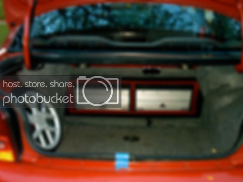

'98 Neon R/T kinda SQ build.
The only one I have so far. Other than the amp rack and sub box, it's just stock carpet.
The carpet is kinda dirty (car has 176k on it and the previous owner used it as such) the interior cleaned up pretty nice, but I'll replace the carpet in the trunk eventually.
I can still get to my spare just fine. (And jumper cables and jack)

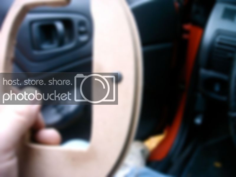

I'm thinking I might work on my door panels next, tho...
The stock 1st gen Neon (like mine) has pods on the doors for the power windows that are right where I rest my knee. I bought a set of 2nd gen door panels which have the switches on the top of the arm rest like a normal car. I plan to adapt the 2nd switch pod into my new design. Thing that sucks is I'll need like 4 yards of vinyl that is similar to my interior...at about $35/yd for what I like to use!

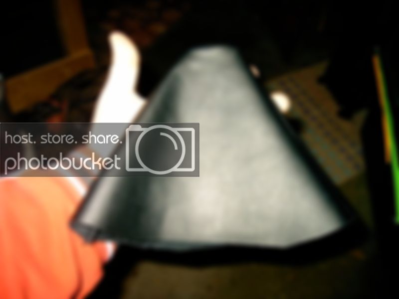

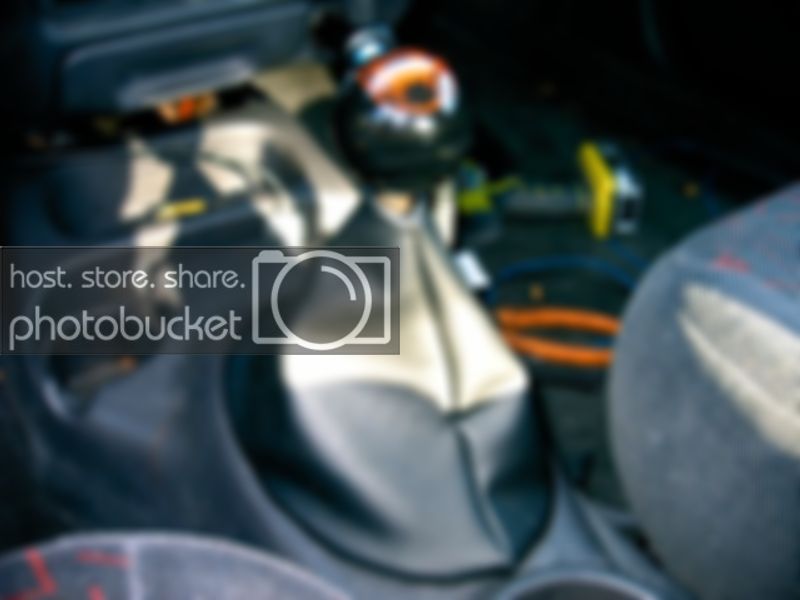

Here's some pics of the shift boot I designed and my GF sewed up for me.

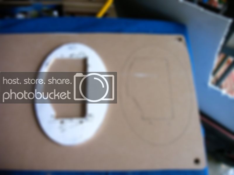

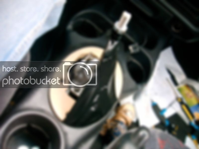

Template for base fits inside hole in console. Made from foam board.
Then duped in 1/4" MDF
Made a second piece with a 1/4" lip.

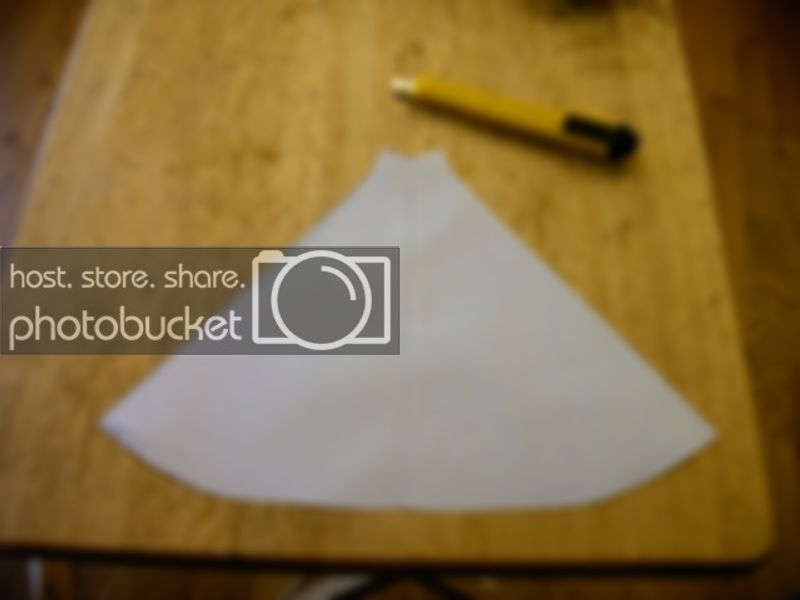

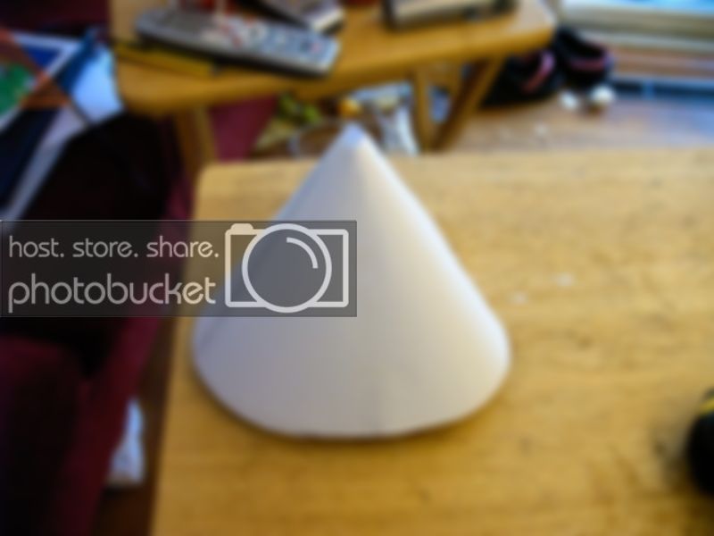

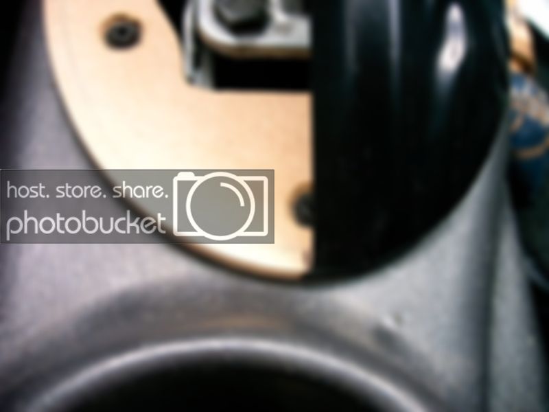

Put the shifter in 1st. Used electrical tape to make a 1/4 template.
Transferred to paper 4 times and made into a complete template.

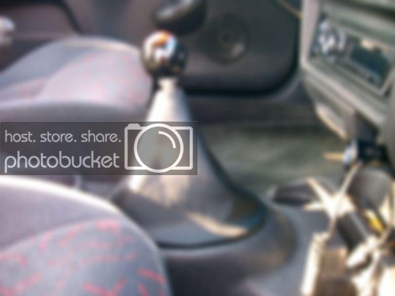

Sewed up:
Installed:

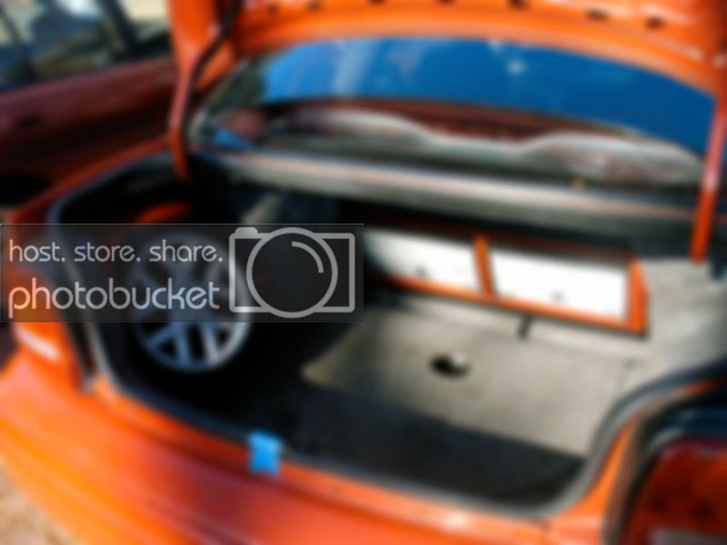

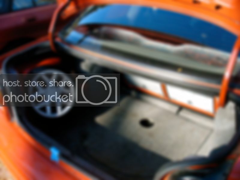

Here's a couple more of the whole trunk:
BTW, the blue tape is holding the trunk seal in place, since I ripped it early on in the build when I was leaning on it. Oooops. I'll pick up another one at the JY...and maybe a "new" rear seat in case I decide to change.
