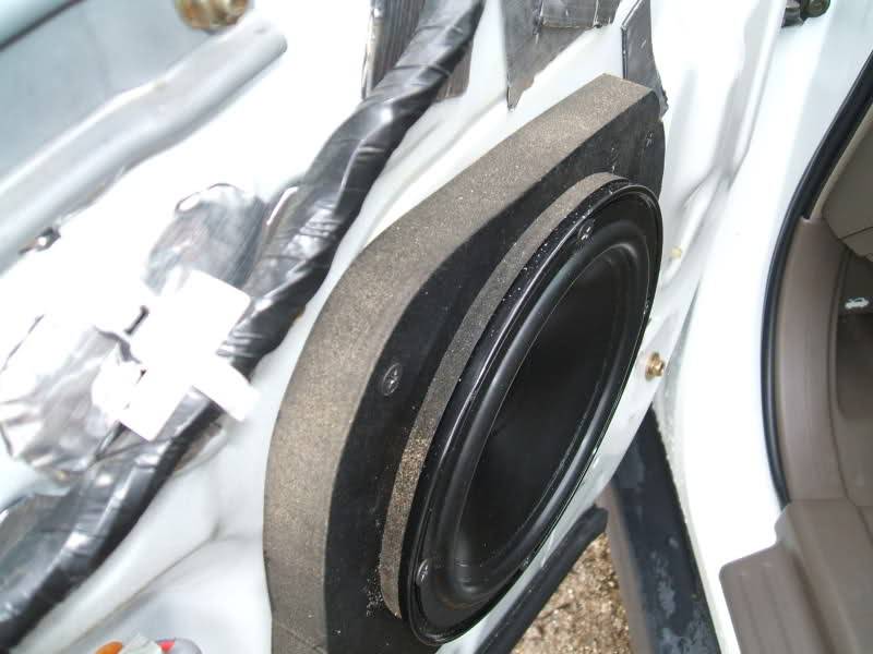

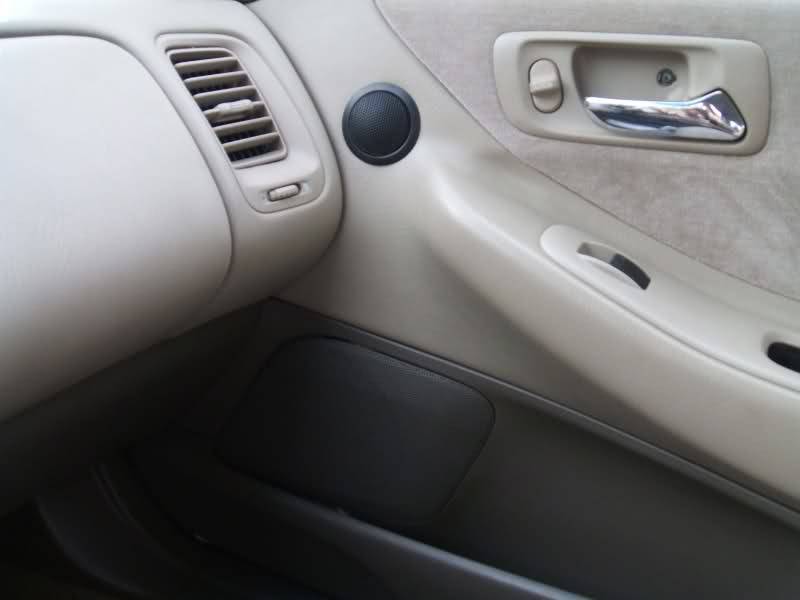

i just did this in my 99. simple yet effective and i think it looks and sounds nice, tho i am using the 9887 with Time Correction
had to build the mid out tho, Oz Elities have fat azzes

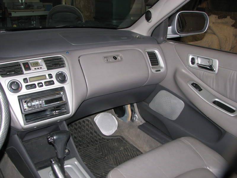

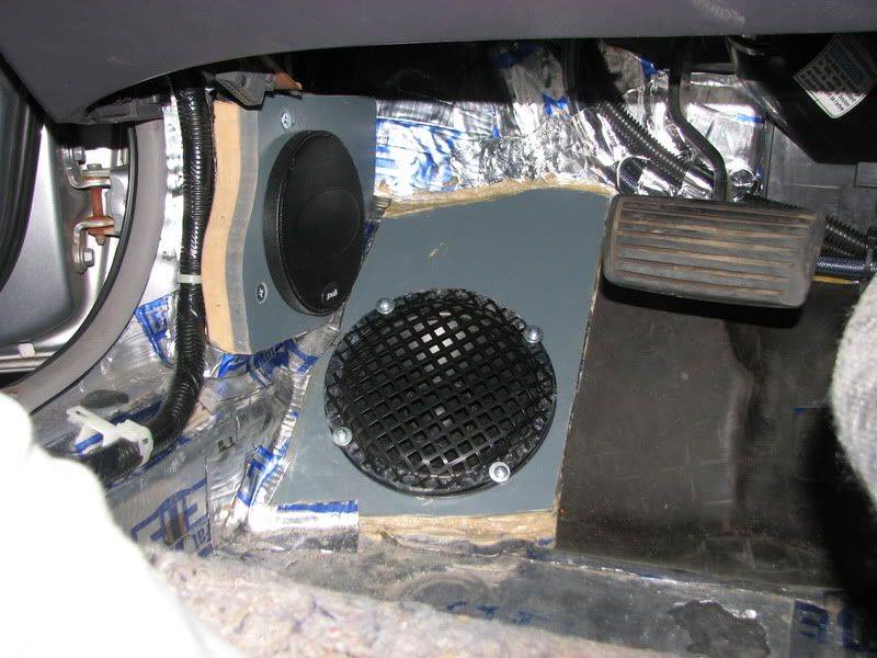

i have an active 3-way in my 2001 Accord EX sedan.

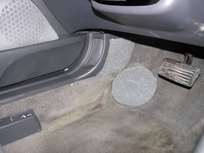

they are in the kicks, fully flush with the factory carpet. not sure why you want to use the door. the PLD is awful. i tried the doors before, the soundstage sucked. i can do two seats with this.
i need to FG a cover for them and replace the carpet. but it's too cold right now. notice how i lost ZERO kick space. midbass are vented to the exterior. build log is here: http://forum.sounddomain.com/ubbthreads.php?ubb=showflat&Number=1369669&page=1&fpart=5
tweeters in a-pillars. FG needed there also. - before modification to kick panels and carpeting - this was during testing.
