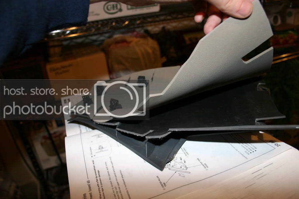

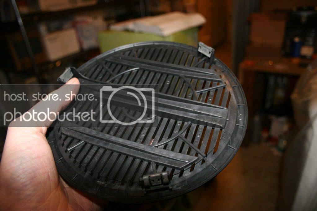

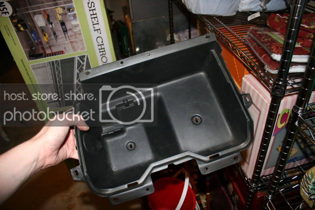

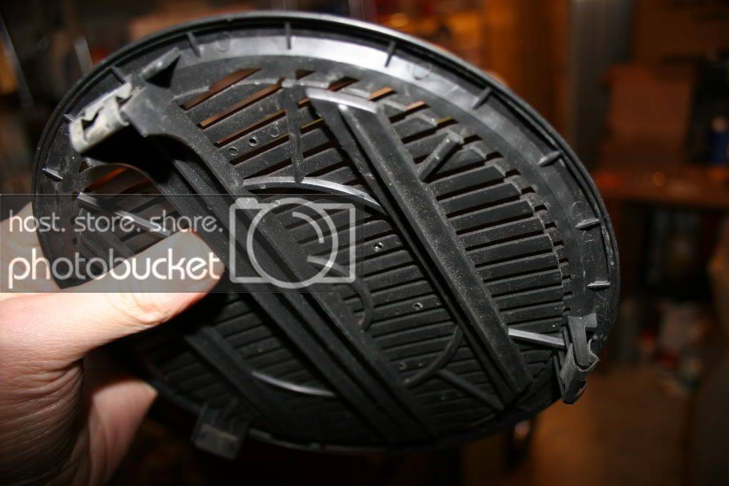

Here are the speaker covers I mentioned earlier. They seem pretty thick, which worries me. Who knows, I am probably worried over nothing lol

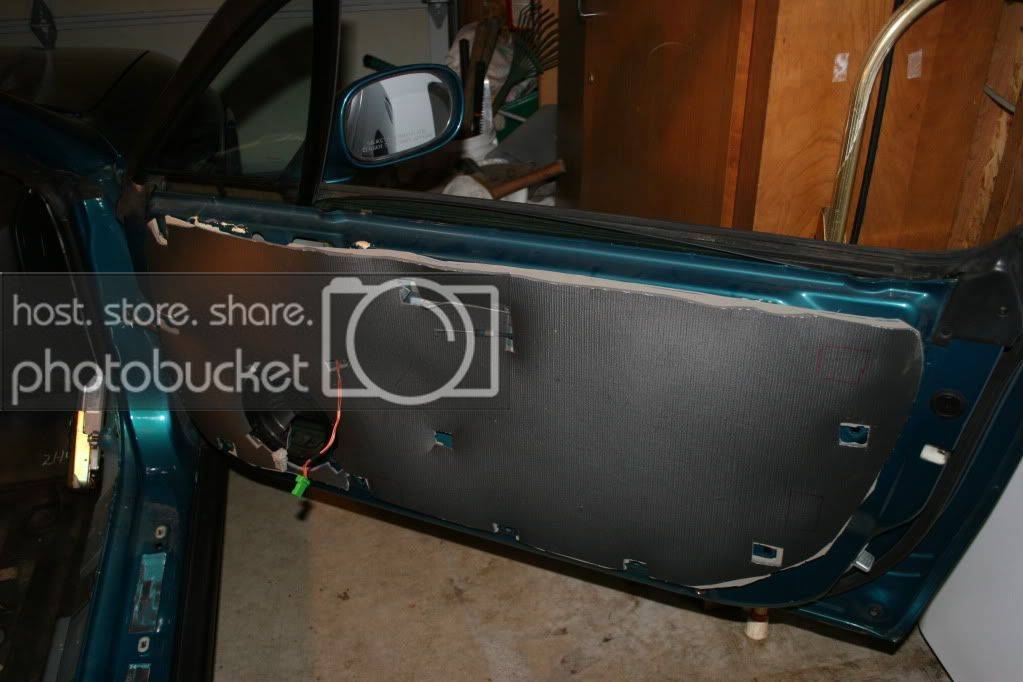

Got the doors done! This was big for me. I did the doors pretty much first because I knew that if I left them for last, I would just end up not doing them haha

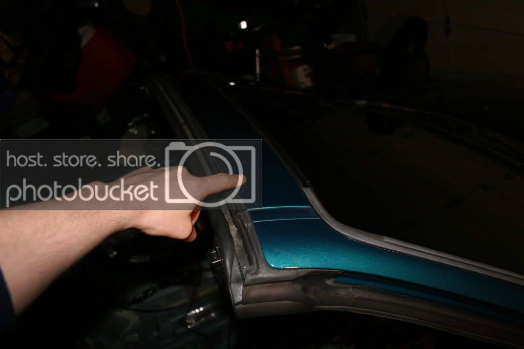

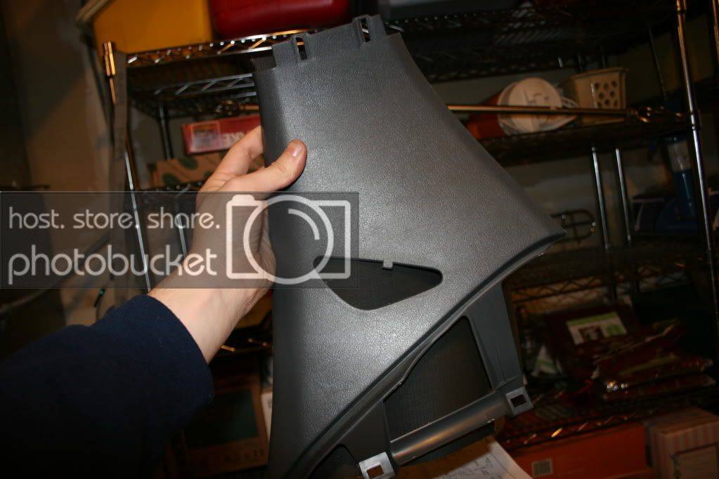

Next up for me were the B-pillars. It seems that these have the potential to block a lot of noise coming from the rear tire wheel wells, so I was sure to try and make these nice and tight fitting.

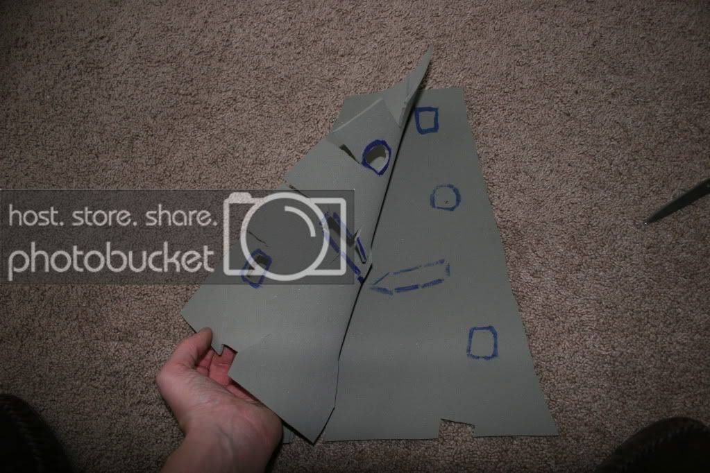

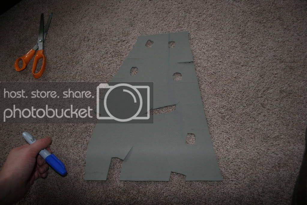

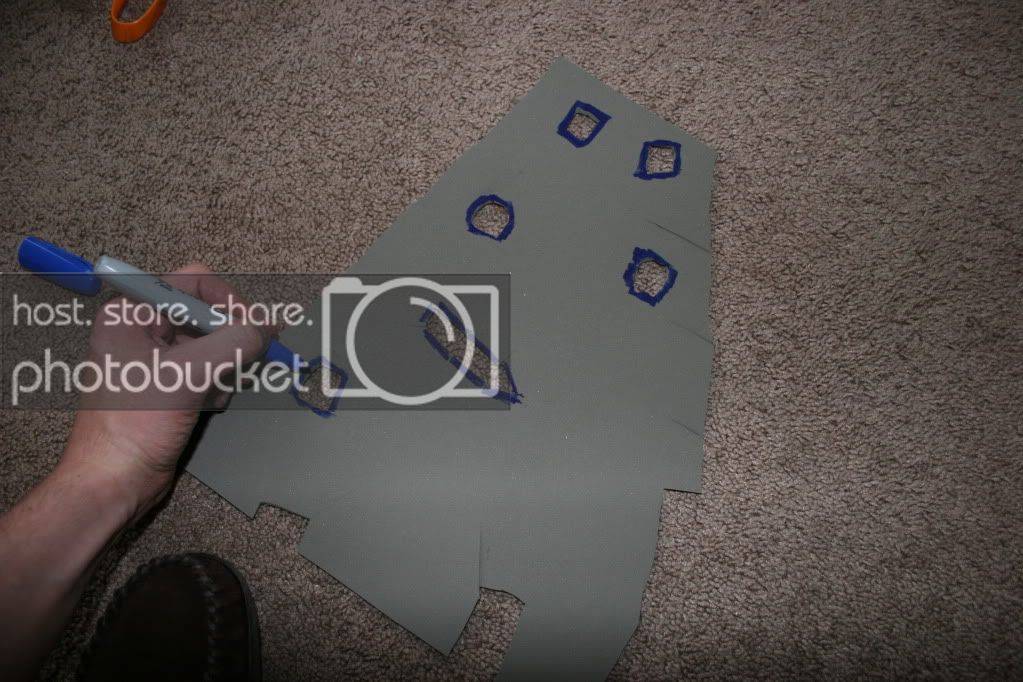

Since there is a lot of mirror images in the car, I found a good way to use one side as a template for the other. Take said template.
Draw on said template with indelible marker of some kind
Lay template over new piece and press. You can now see the outline of your new piece!

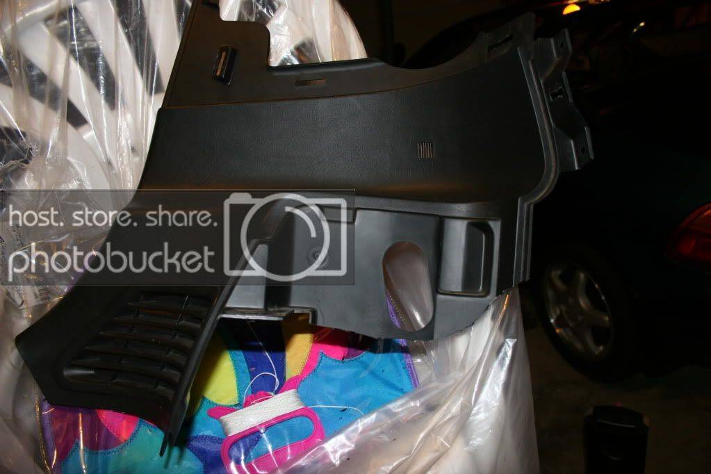

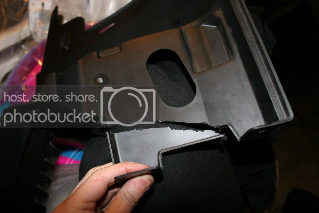

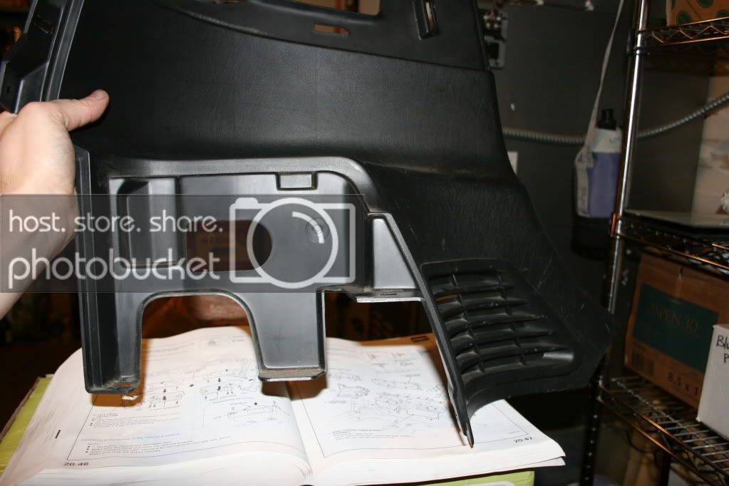

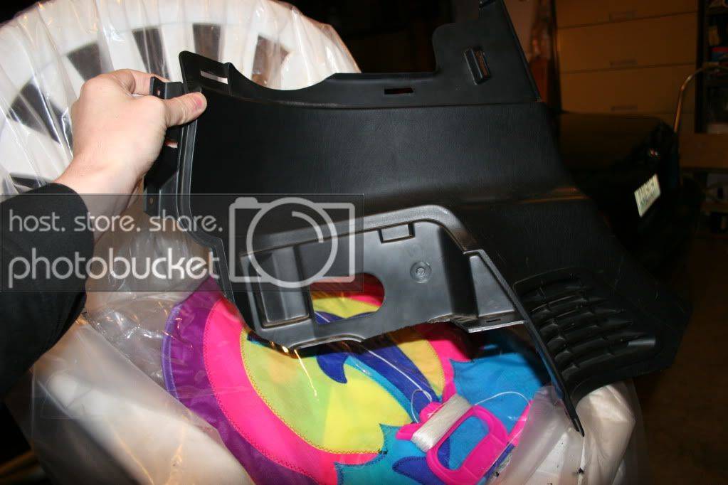

Here is the passenger side lower trim piece. Unfortunately it needs some trimming to allow for "easy" use of the MLV.
Trimmed!

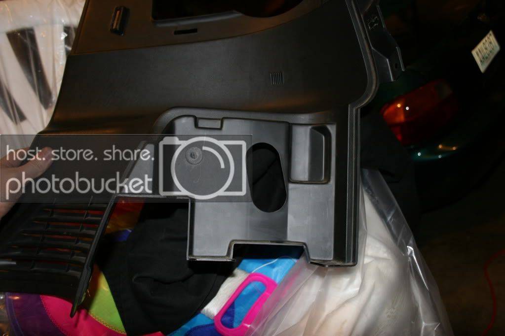

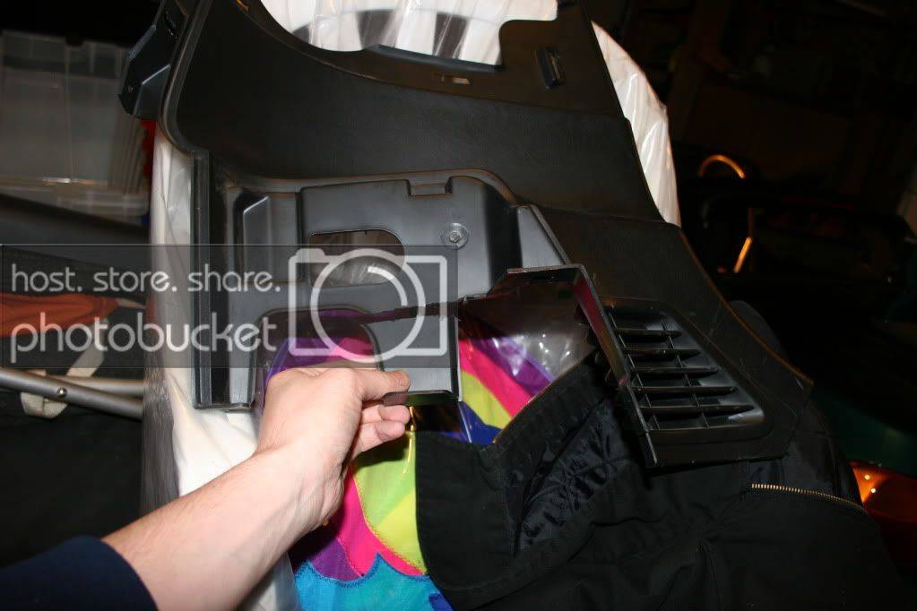

Driver side lower trim piece.
Trim piece trimmed again.

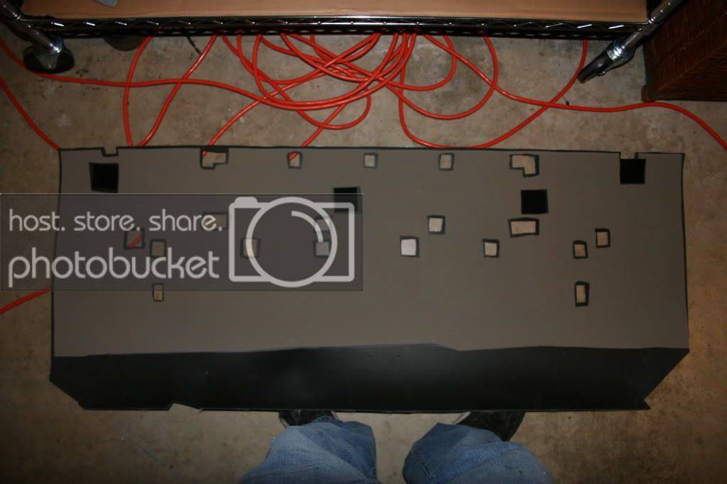

I picked up the 1/4 inch MLV yesterday, and man, this stuff is heavy. Makes sense though, it is twice as thick. However, I have a hunch that its not twice as heavy... my 1/8th inch stuff is 1lb per square foot, but I bet this stuff is closer to 1.75 or maybe even 1.5 lbs per square foot. I might actually weigh some a little later just out of curiosity.

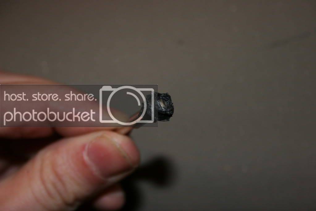

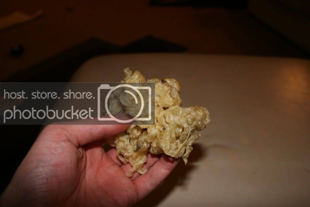

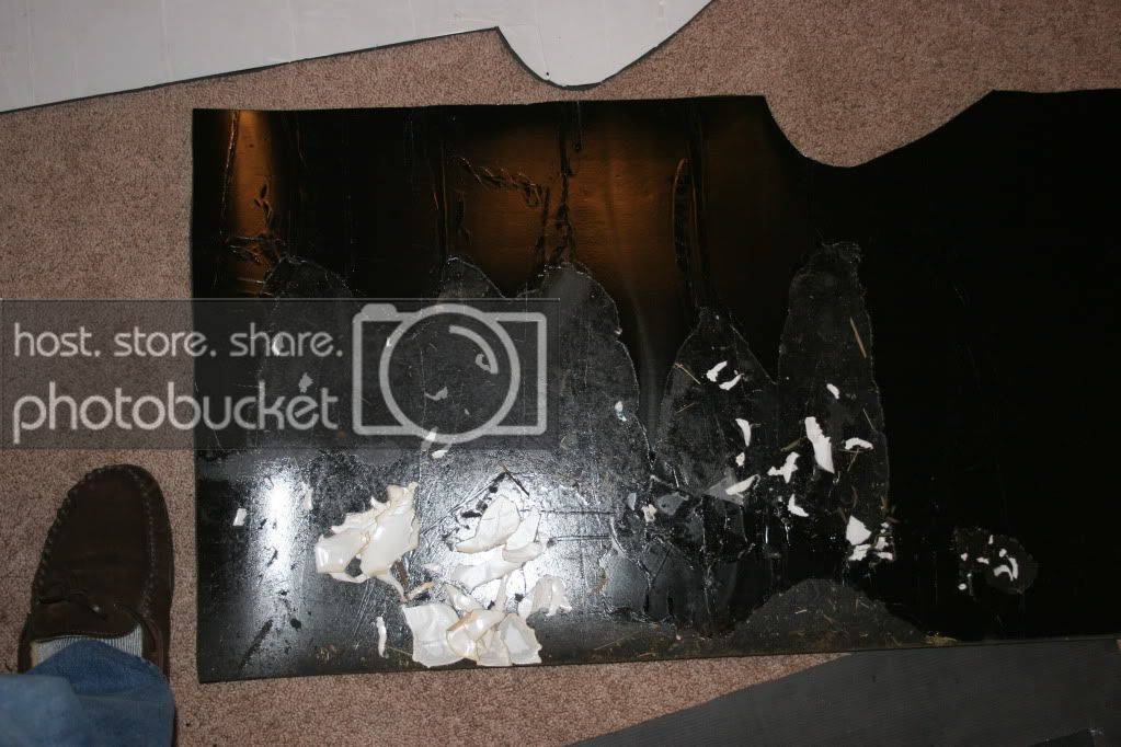

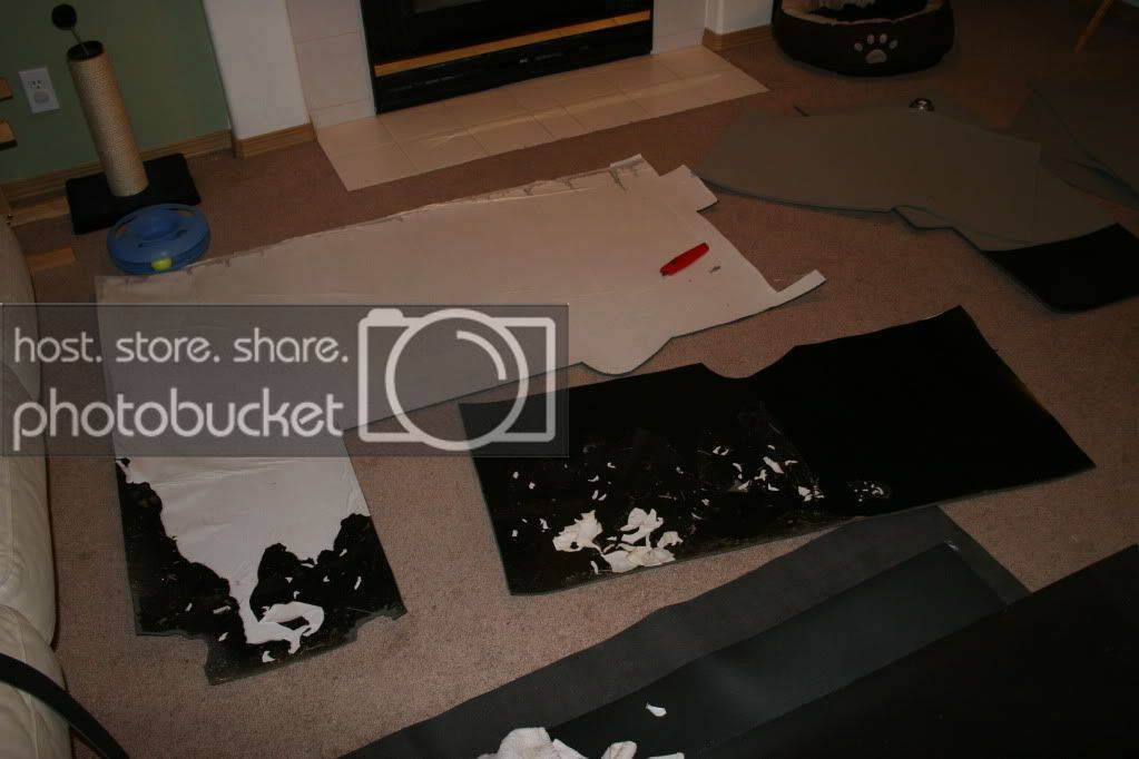

When I got it and unrolled it, I was a little worried that I would not be able to use it. It had all this crap all over it, that turns out to be some kind of adhesive. When I tried to test my vinyl cement, it would not stick. ****. Eventually, I found that I could peel the stuff off. So much for being an adhesive. Many hours later I went from this:

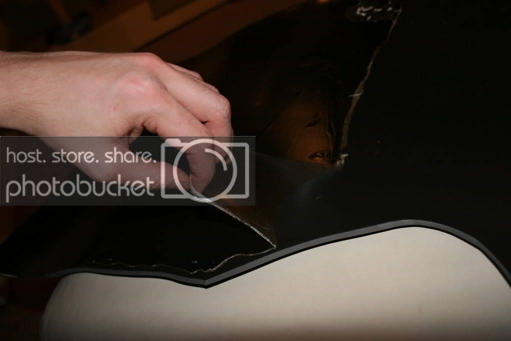

Doing this:
To this big pile of goo:
This took forever to get off... Actually it took about 2 hours to peel it all off from the pieces I cut, and to me that felt like forever. The stuff was really thin, and was easily torn, so I had to peel it off super slow.

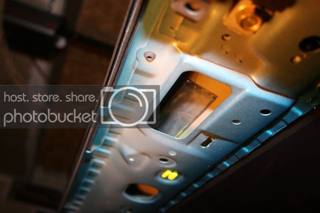

Ok, here is something that really supports the idea that only 25% of sheet metal needs to be covered.
Here I am pointing to a piece of sheet metal that always annoyed me. When a large drop of water, or even just rain in general hit this, it would resonate like crazy! Drove me nuts.
Anyway, I managed to get a small piece of CLD in there and thats all it needed. The whole piece was dead from just that one piece! Blew me away lol

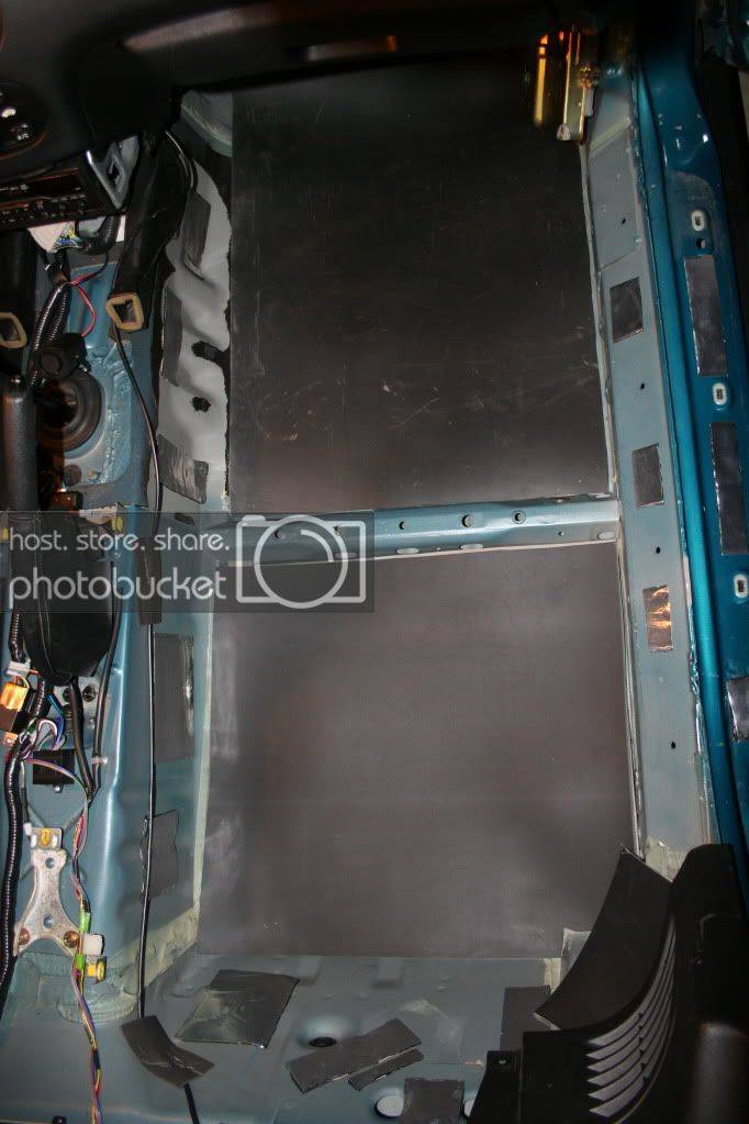

Got the floor boards done with the 1/4 stuff.
Had to do a lot more trimming on the rear panels than I would have liked. O well.

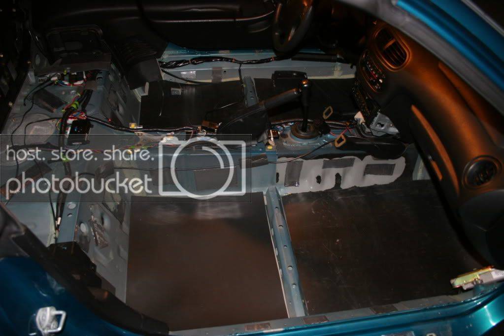

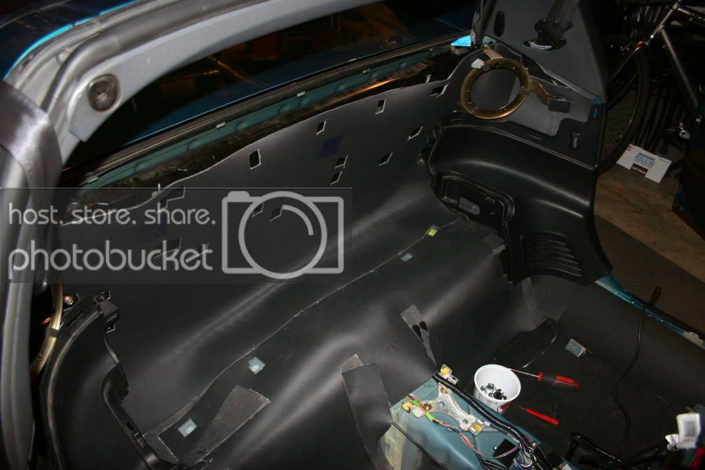

Working on the rear deck. This is pretty tricky because there are a lot of really tight areas between the metal and the trim panels here.
Well, my time it up, and I have not finished the car... ****. I looked at the clock and it showed me 1:30am so I had to stop. I was able to get the rear deck all put back together by taking out one of the cubby holes. I cheated lol.
I threw the panels on, and the drivers seat in and called it good. The only things left to finish are the center console and the foot wells. I will try and get to those this weekend.

those speaker grilles make me cringe
I know right!! //content.invisioncic.com/y282845/emoticons/frown.gif.a3531fa0534503350665a1e957861287.gif I am looking for an alternative to them, but have not come up with anything at the moment.
