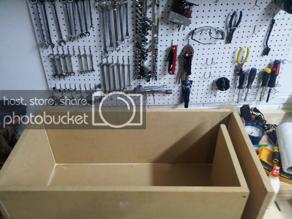

i molded the subs in winisd and came up with a 3^ft tuned to 35 ,i decide to just build two of them since our trunks are the same dimensions.

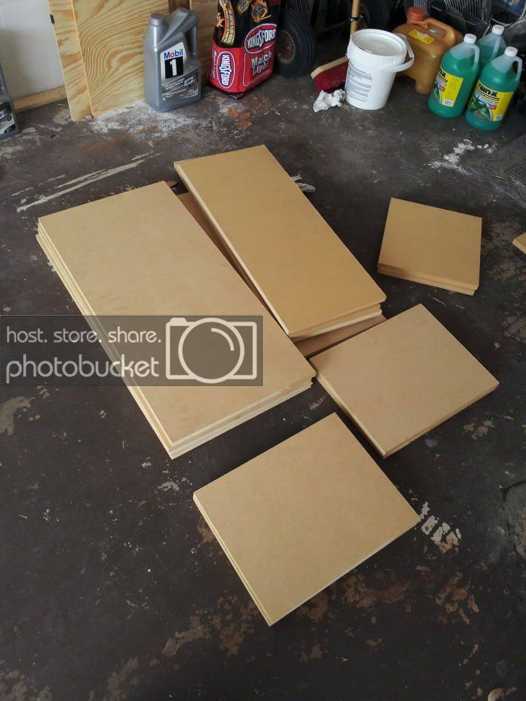

I had home depot do the cuts since i don't have a table saw as of yet. (yes they fucked up all of them)
The wifes

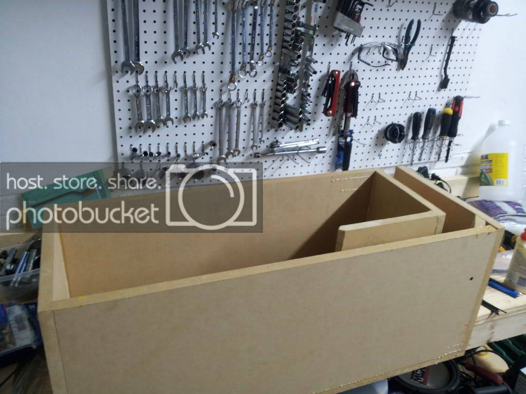

Mine ,i decided to make mine a bit smaller due to my smaller trunk opening and shorter trunk.
2^ft tuned to 35Hz funny thing is due to the larger port i only saved 3" in depth on the outer dimensions

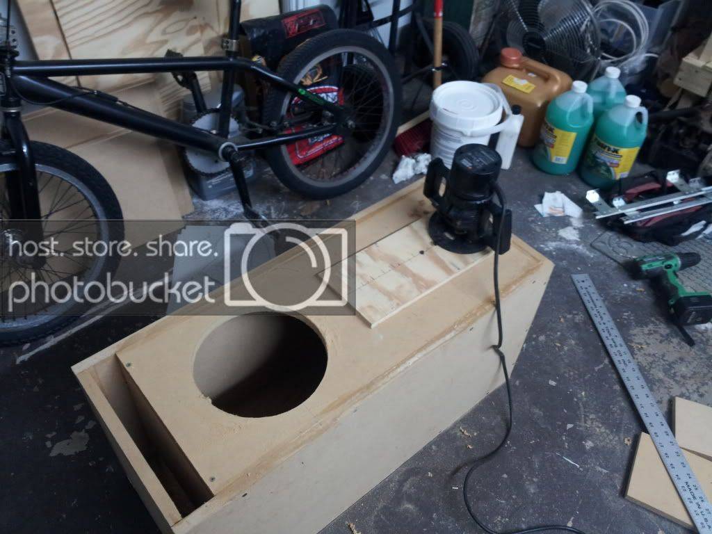

My patent pending custom hole jig for my router.

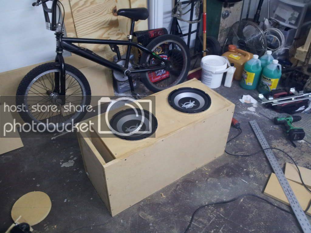

p3 in my wife enclosure,they sound pretty **** good ,very surprised.

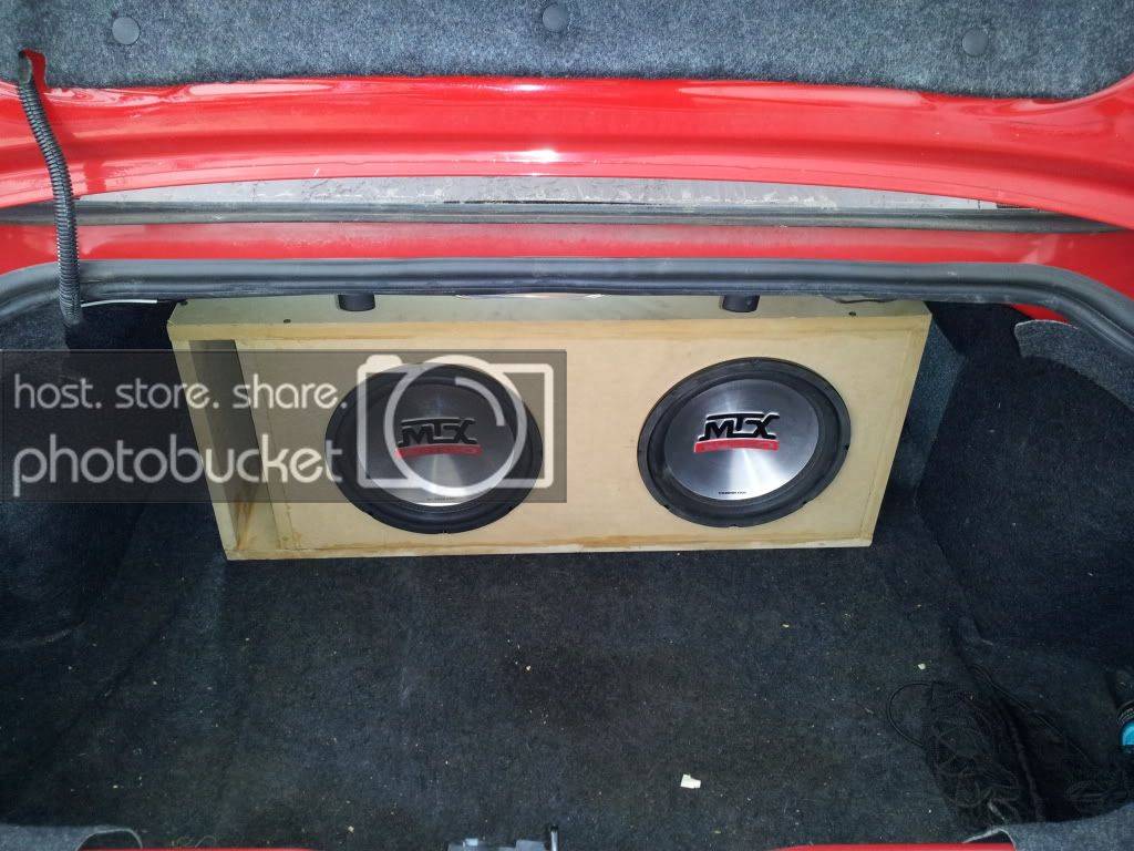

MTX 10" 4500 (t4510-04) i went with thees because i had one sitting around that i bought with my circuit city discount ,but i never got around to using it. so i picked up another one on ebay...not to happy with them, very peaky and now low end. but they do get pretty loud.

subs:2 MTX 10" 4500(looking for single 12 for SQL
sub amp: MB quart refrance ref1.800(may give this amp to my wife. and but a onx1.1500 )
I know its a pain but having seen the cobalt turnk openings you might be better off removing the back seats if they allow you to get a bigger box in there. But like already said Mtx need a cubic **** ton of air for them to get low and sound good
Yeah i'm not willing to give up any more space than I currently have. 2 to 2.5^ft. With the back seats removed you can fit a pretty large enclosure in the trunk. Im leaning towrads a single 12 in 2 to 2.5 cubes

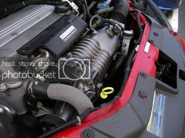

Lol,I assume you're trolling but if not.They are factory supercharged and share the same drive-train/platform 205hp-200tq stock, I'm closer to 275 whp.(300 crank) the cobalt dose 13.7-13.9 @ 105(no traction) the redline is stock but manages high to mid 14s @ mid 90s. I plan to do the same mods to her car that's done to mine.Not blazing fast cars but competitive in their segment.
Thanks, I use to just have them cut it down so i could fit it in my car, but then so much mdf gets wasted. the kid that did the cuts rushed , i gave him plans with the cuts laid out on the board with a cut list, he tried to do to much from memory. he cut one panel a full half inch short, some were there was as much as a 1/4 inch difference in some cuts. I just re trimmed with my curricular and filled any gaps with wood glue and saw dust(diy wood putty)
