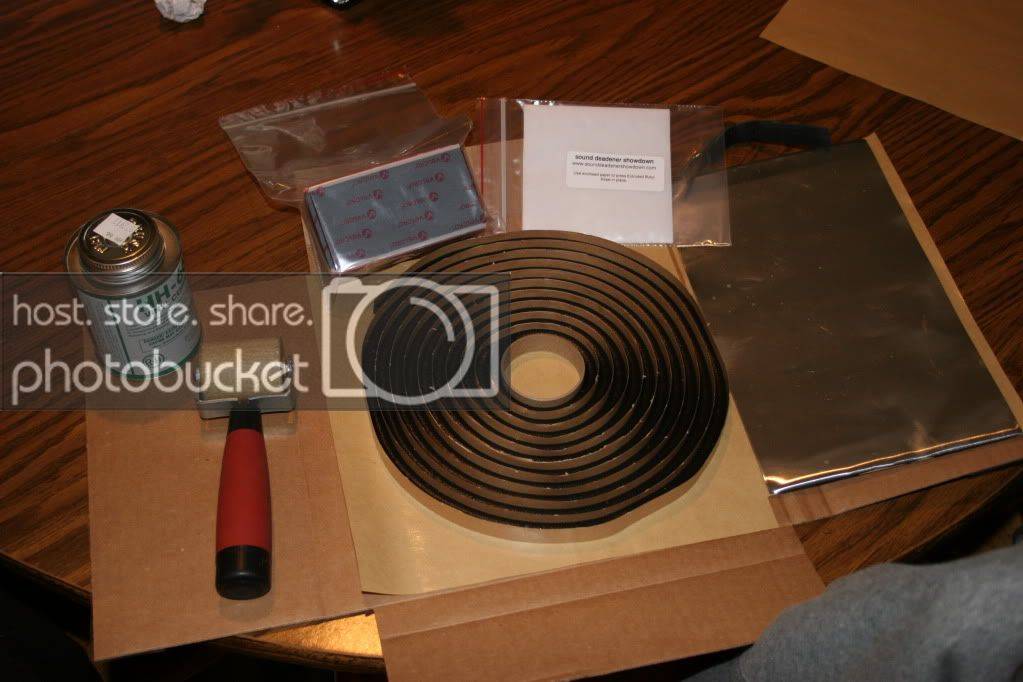

Here is the basic overview of the materials I will be using:
CLD tiles, HH-66 vinyl cement, some double sided sticky velcro, butyl rope (super handy!), along with some MVL shown below

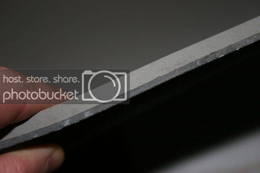

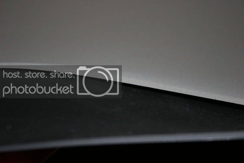

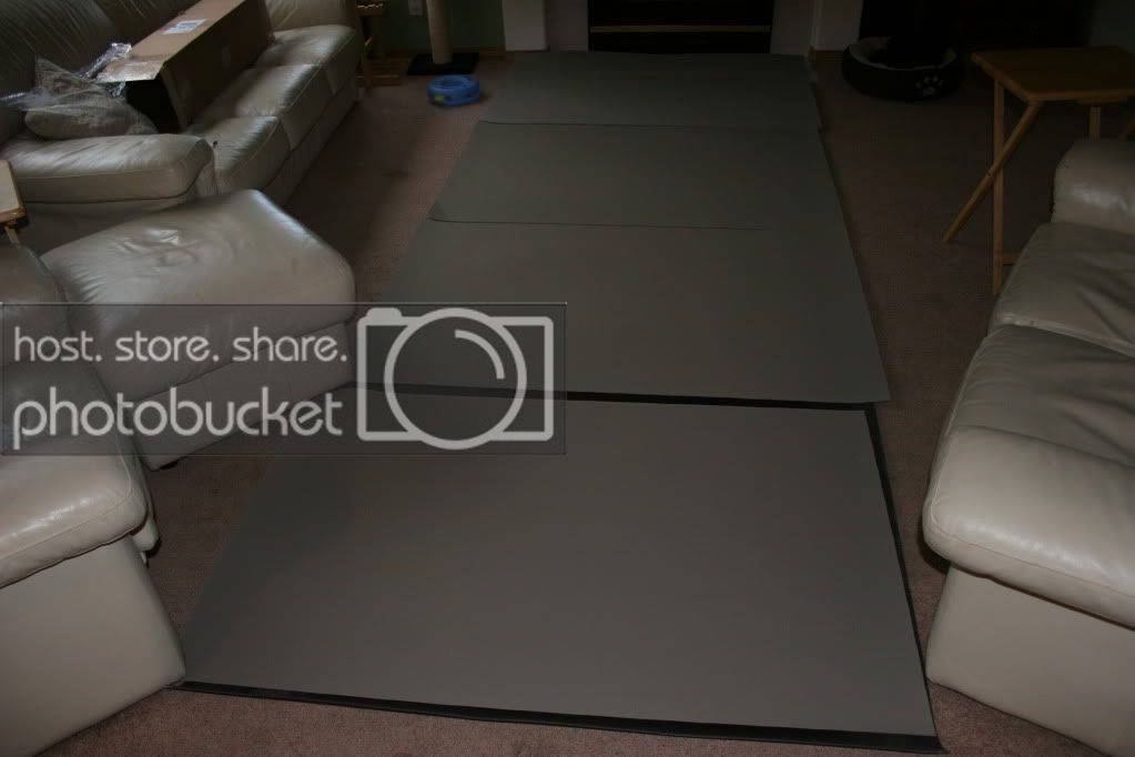

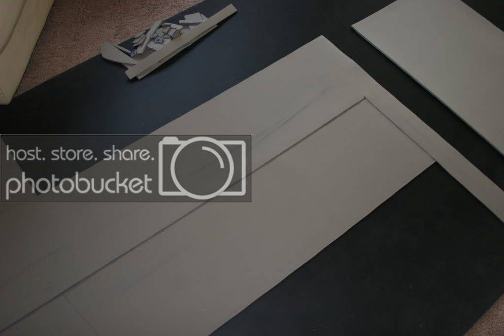

The CCF and the MLV laying out to flatten a bit. I think this might help make it easier to work with a little bit.

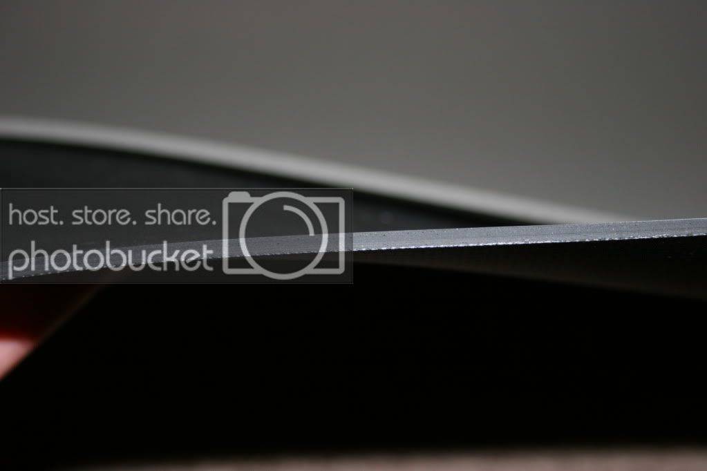

1/8th inch, 1lb/ft^2:
1/8th inch CCF:
the MLV and some 1/4 inch CCF for the footwells:

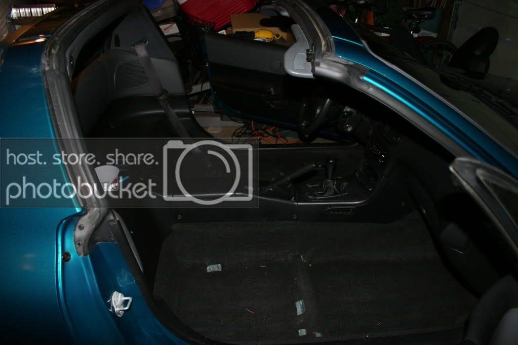

The interior of the car with no seats, but before the teardown

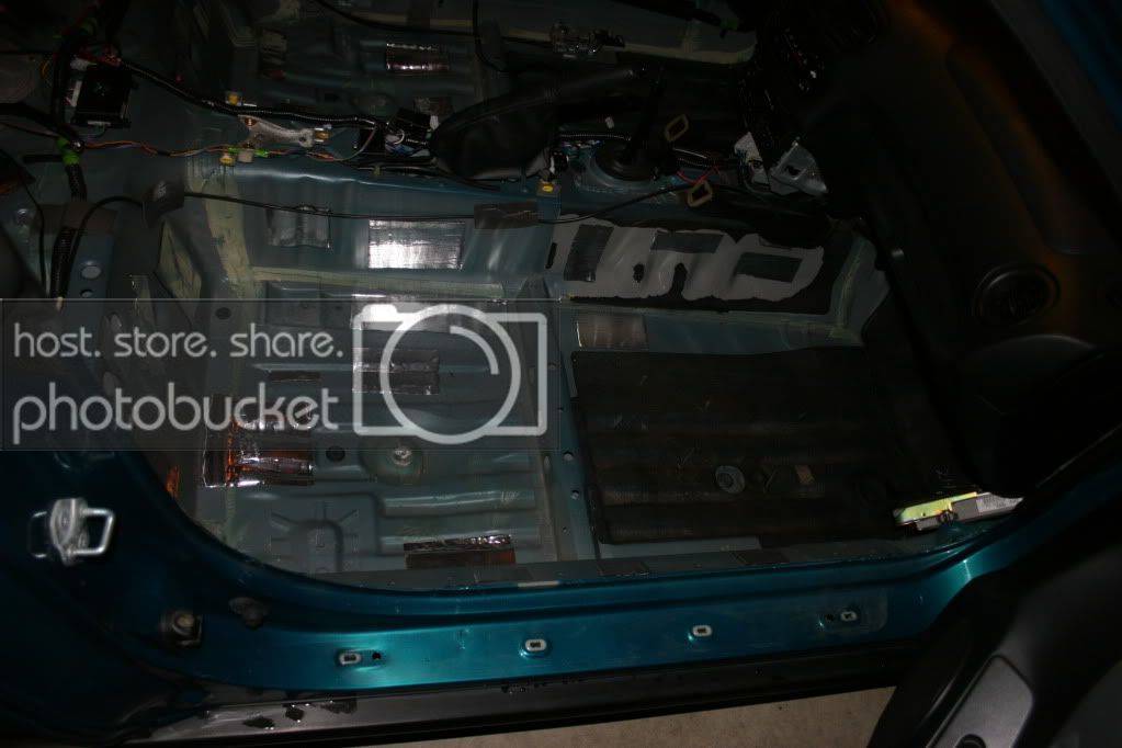

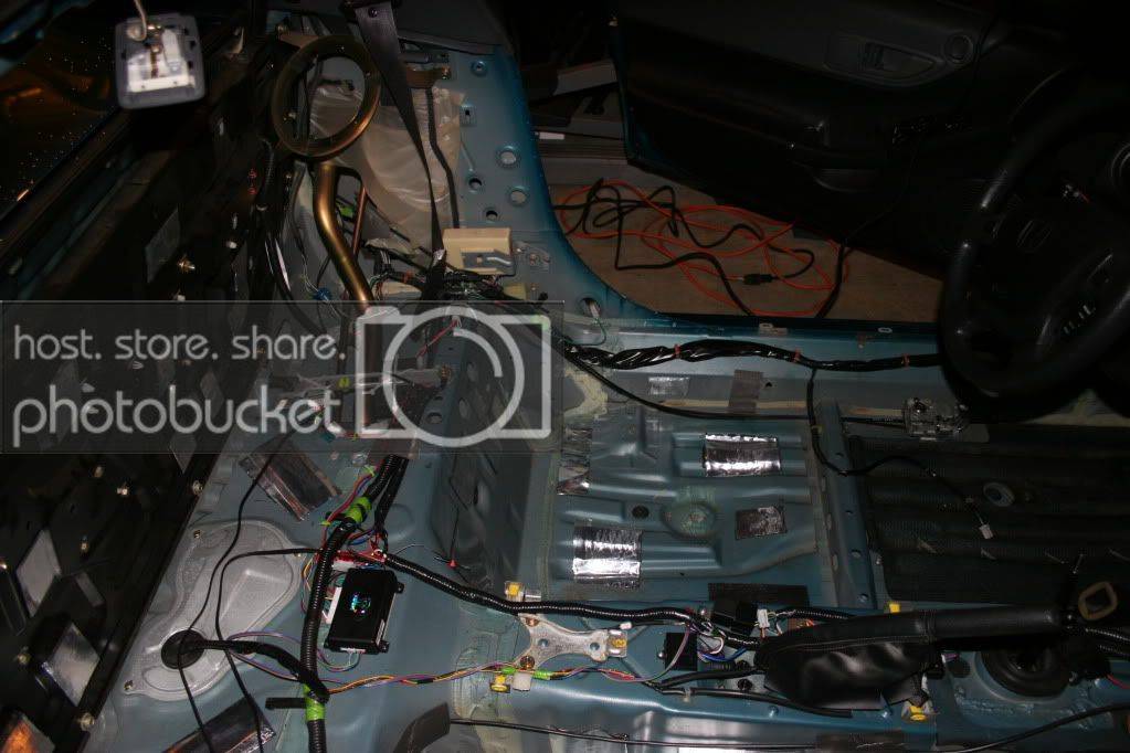

Well, I had some friends over to help me gut the car, and do the basic application of the CLD tiles to the floor and rear deck. Overall, I think its going well, but its hard for me to say. Tomorrow morning i will cut the CCF to fit, and then lay the MLV over that. Hopefully, I can get the floor and rear deck done tomorrow, to leave the doors for the day after that!
Ok, the interior is mostly out, and the CLD tiles are getting put in. I cleaned each area with acetone first to get better adhesion, but I dont know if this actually helps or not...
Don't mind all the ugly wiring. That is my attempt at an alarm install - Hey, it works pretty well, so I'm ok with it lol

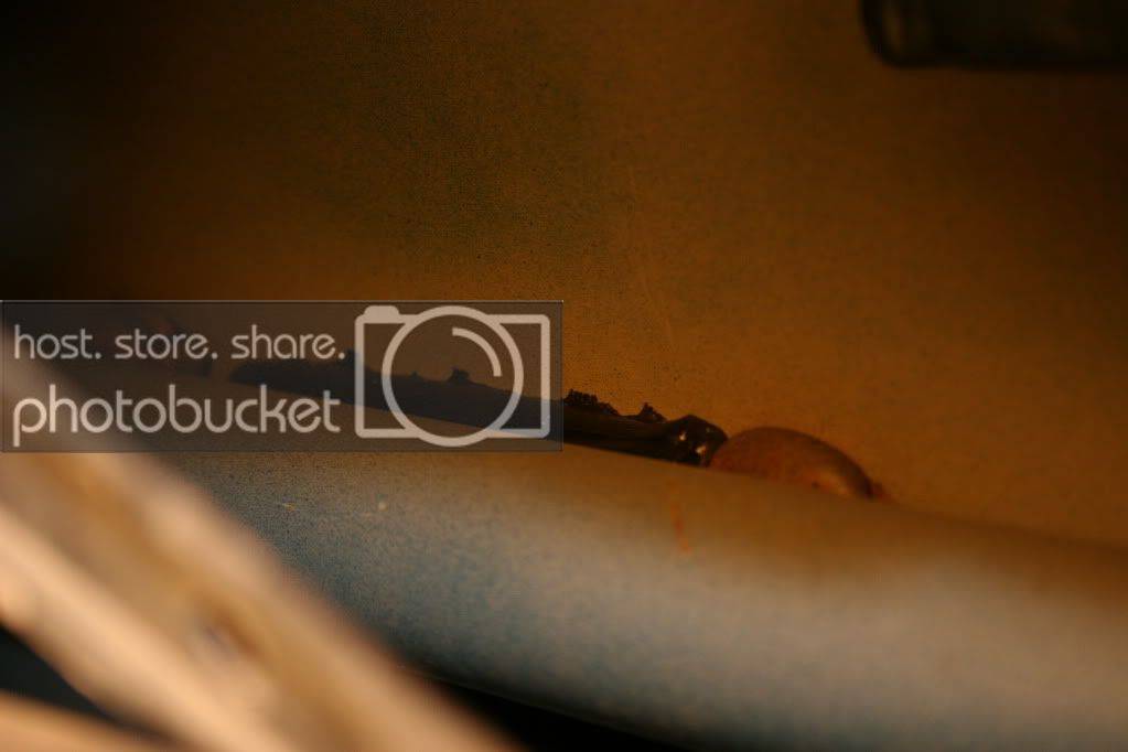

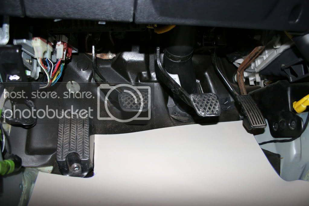

I finally started on the CCF.
How important is it to get the foam all the way up under the pedals? I will try and get some MLV up in there, but I'm not going to kill myself over it.

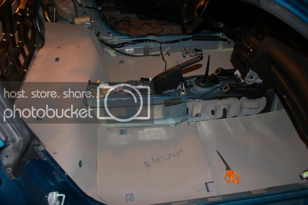

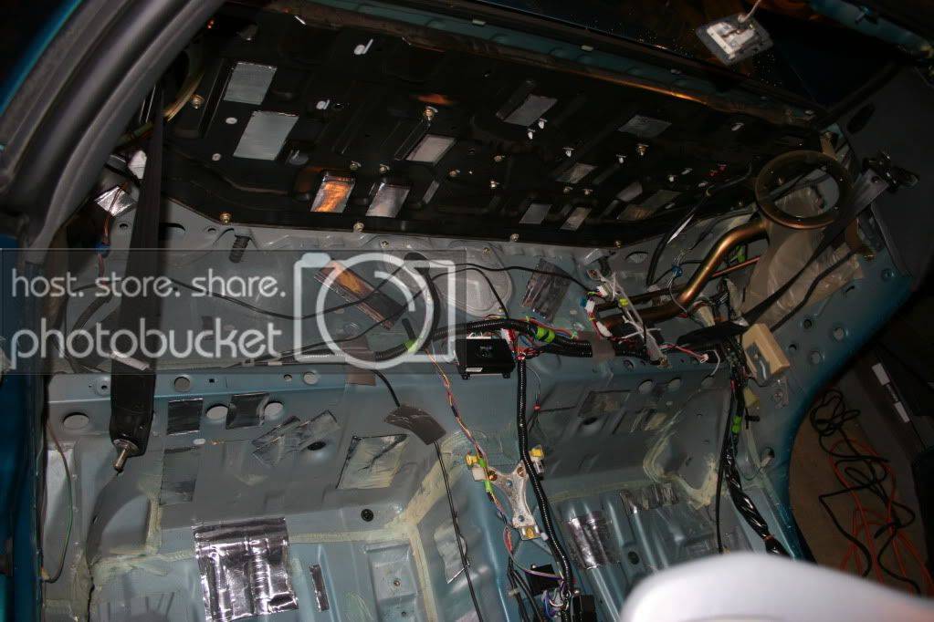

Ok, I have all the CLD tiles placed in the cabin, along with about half of the CCF. I will probably head back out to the garage and try and finish up the CCF tonight so that i can start tackling the MLV tomorrow. Any tips on getting the MLV to contour correctly?

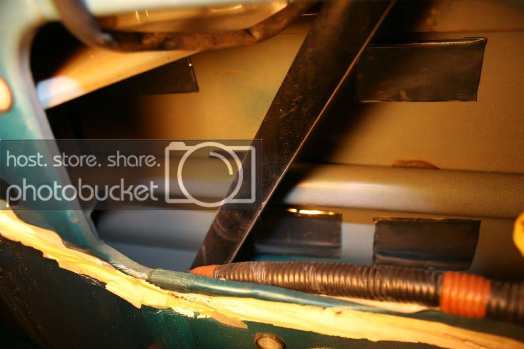

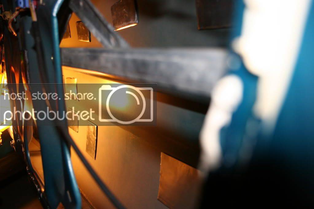

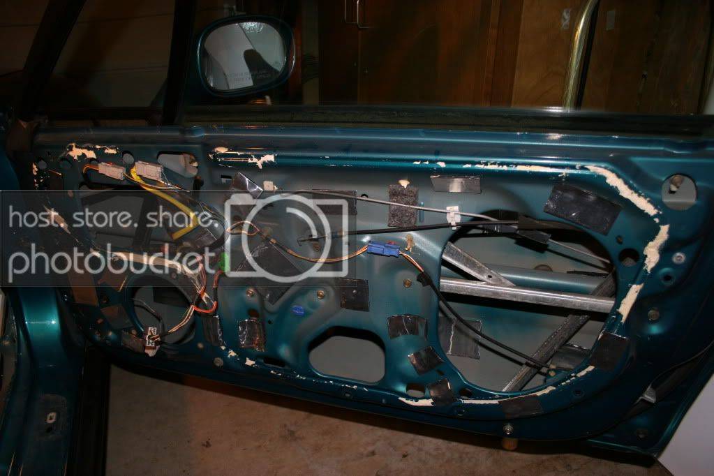

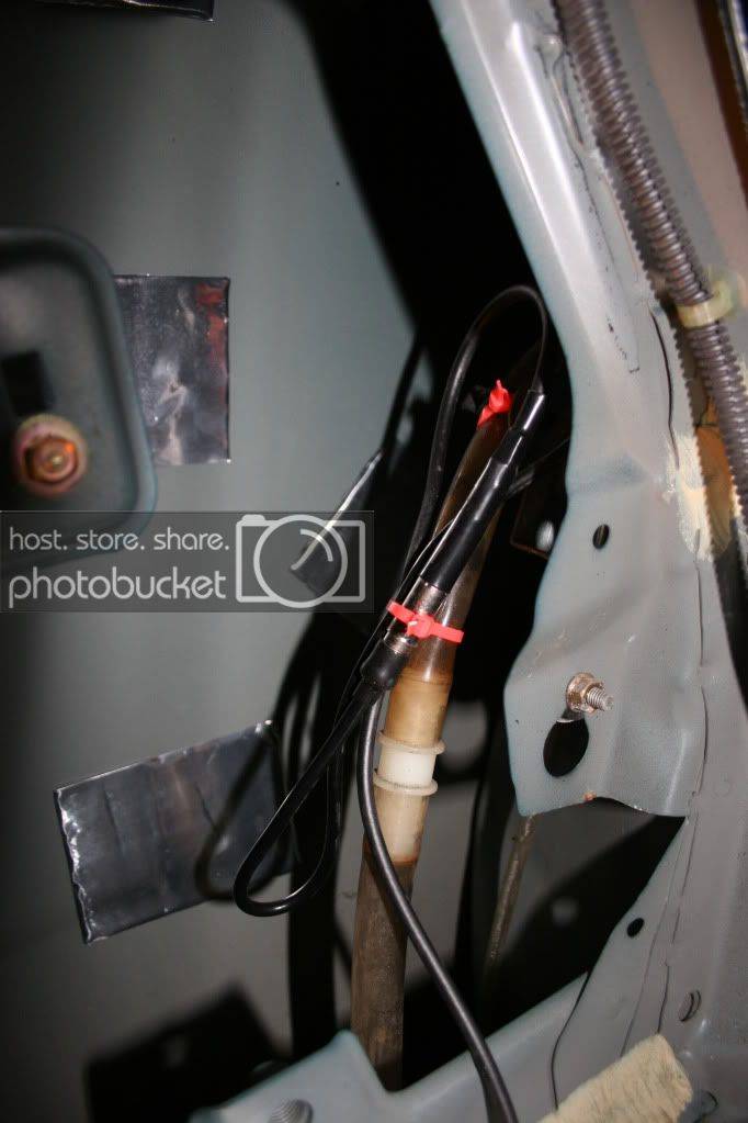

I was able to finagle some CLD tiles into the door and get them to stick to the outside sheet metal. Seems to really help using the flick trick.
I used the butyl rope to wedge it between the side impact bar and the sheet metal for a little more absorption and rigidity.

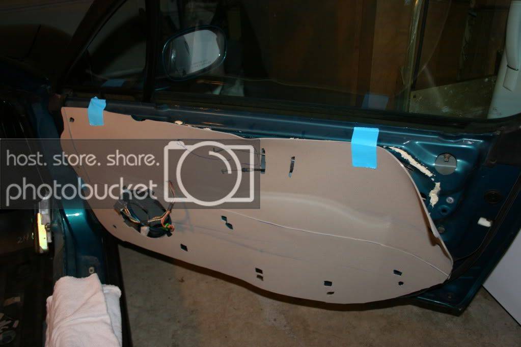

My friend Eric starting to shape the CCF to one of the doors
My CCF being fitted to the passenger side door. Ignore all the extra holes... I should have measured twice, cut once, but instead I ended up measuring twice, cutting twice lol. Should not affect the SQ though.
