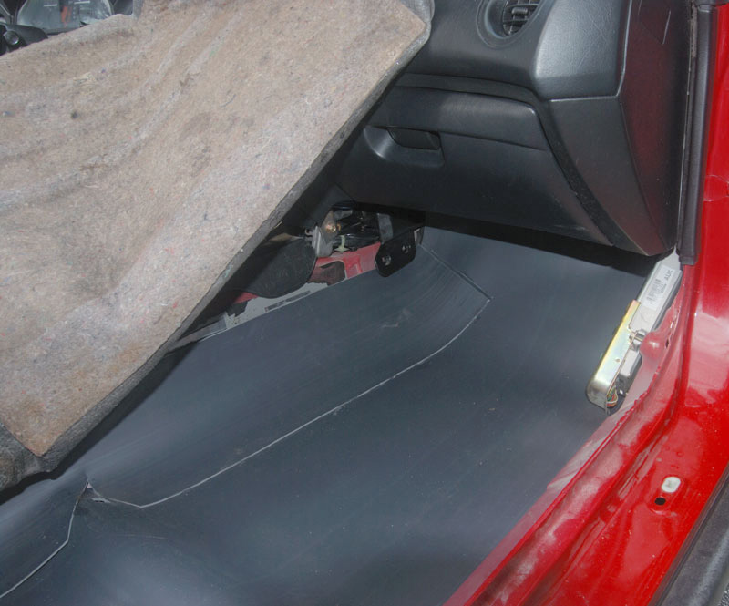

Kris got some good shots of the floor - CLD Tiles and CCF. We both forgot to take final shots with the MLV in place because our brains were pretty much baked by the sun at that point. I pulled the carpet back to take this:
What was used to determine where to put the tiles?
Just tapping on the panels. It's pretty easy to here which areas are flimsy/resonant. The trap you don't want to fall into is tapping to determine when you are done - tapping on a panel is very different than what happens to it under normal conditions. Tap to find weaknesses but not to figure out when you are done. Vibration damping is cumulative. Don't worry about adding more until you have treated all of the areas that showed they needed work the first time through.
Ah yes the MLV picture I did not have. This is what I forgot to take a picture of. I will be taking step by step pictures when I do my doors. Im also going to try and do it extremely slow to make sure I do it correctly the first time. I literally want to get as much MLV/CCF in there as possible. The CLD tiles will be super easy to install, the 6x10 cutout idea is BRILLIANT.
Also did I mention this stuff is EASY to cut?//content.invisioncic.com/y282845/emoticons/smile.gif.1ebc41e1811405b213edfc4622c41e27.gif
